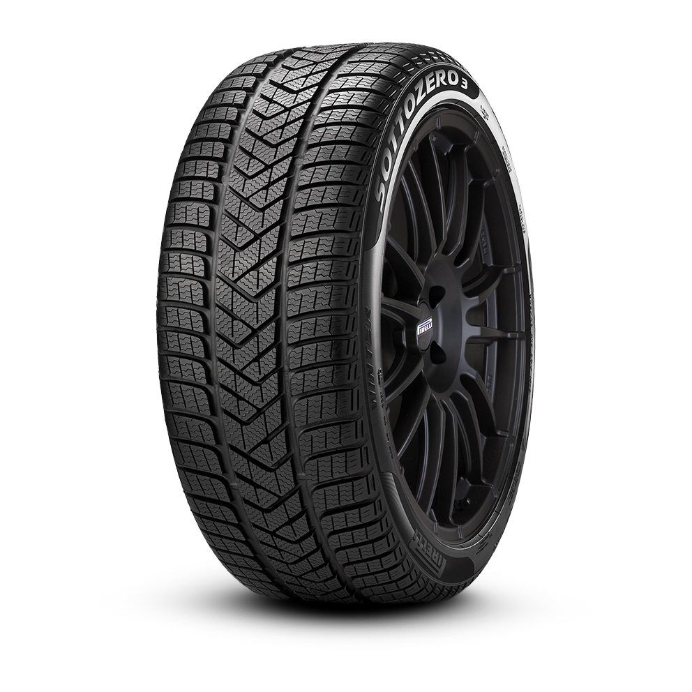

I have Pirelli M+S tires. Isn't that factory equipment?
For trips to the California mountains, true snow tires (as opposed to M+S, which are really all-purpose) are a pain. You probably never need them. Interestingly, while M+S tires are sometimes consider "three season" tires, these factory Pirellis are labeled "all season". As I understand it, in comparison to M+S tires, "winter" or "true snow" tires have a more aggressive tread pattern and a rubber that retains flexibility at lower temperatures. Some manufacturers seem to say that 7F is the cutoff for M+S tires.
