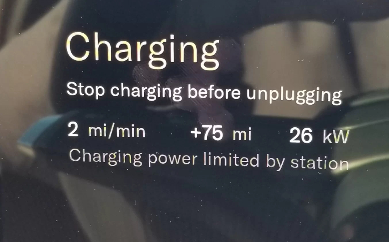

Got this dreaded message at the 2 chargers in Victor that I got to work at all so I called EA and Lucid. Lucid CS says that they are aware that some EA chargers don't know how to handle the higher voltage of Lucid cars and therefore limit the power to avoid a problem. EA said they are aware of problems with Lucid charging and Signet chargers. I don't know what to believe anymore. I thought Signets were the 'good' chargers. Yet here I sit charging at a pathetic 25 kW.
Got this dreaded message at the 2 chargers in Victor that I got to work at all so I called EA and Lucid. Lucid CS says that they are aware that some EA chargers don't know how to handle the higher voltage of Lucid cars and therefore limit the power to avoid a problem. EA said they are aware of problems with Lucid charging and Signet chargers. I don't know what to believe anymore. I thought Signets were the 'good' chargers. Yet here I sit charging at a pathetic 25 kW. View attachment 10577
My frustration isn’t that this is happening… It’s that there seems to be no attempt ongoing to resolve it. I would be very appreciative if either of the two companies came out with a statement that they are aware of the problem and actively working on it.
Lucid CS says they are working on it but would not give me a resolution time frame
And here I thought I was home free when I saw the chargers, just a few minutes from my house, were Signets. You can’t win. :(
Interestingly, these chargers, although Signet, are different from all the other Signets I've used. Each charger has 2 cables, one on each side presumably to accommodate different charging port locations. All of the others I've used successfully have one cable per charger. So, don't give up until you identify the types by you and try them out
Halodde, the EA chargers near me do have the 2 cables on either side. :(
Well, there's still a chance they may work out okay. On a whim after an hour at 25 kW, I went back and plugged into the 350. I got 115 kW that time. 🤷‍♂️🤦‍♂️
