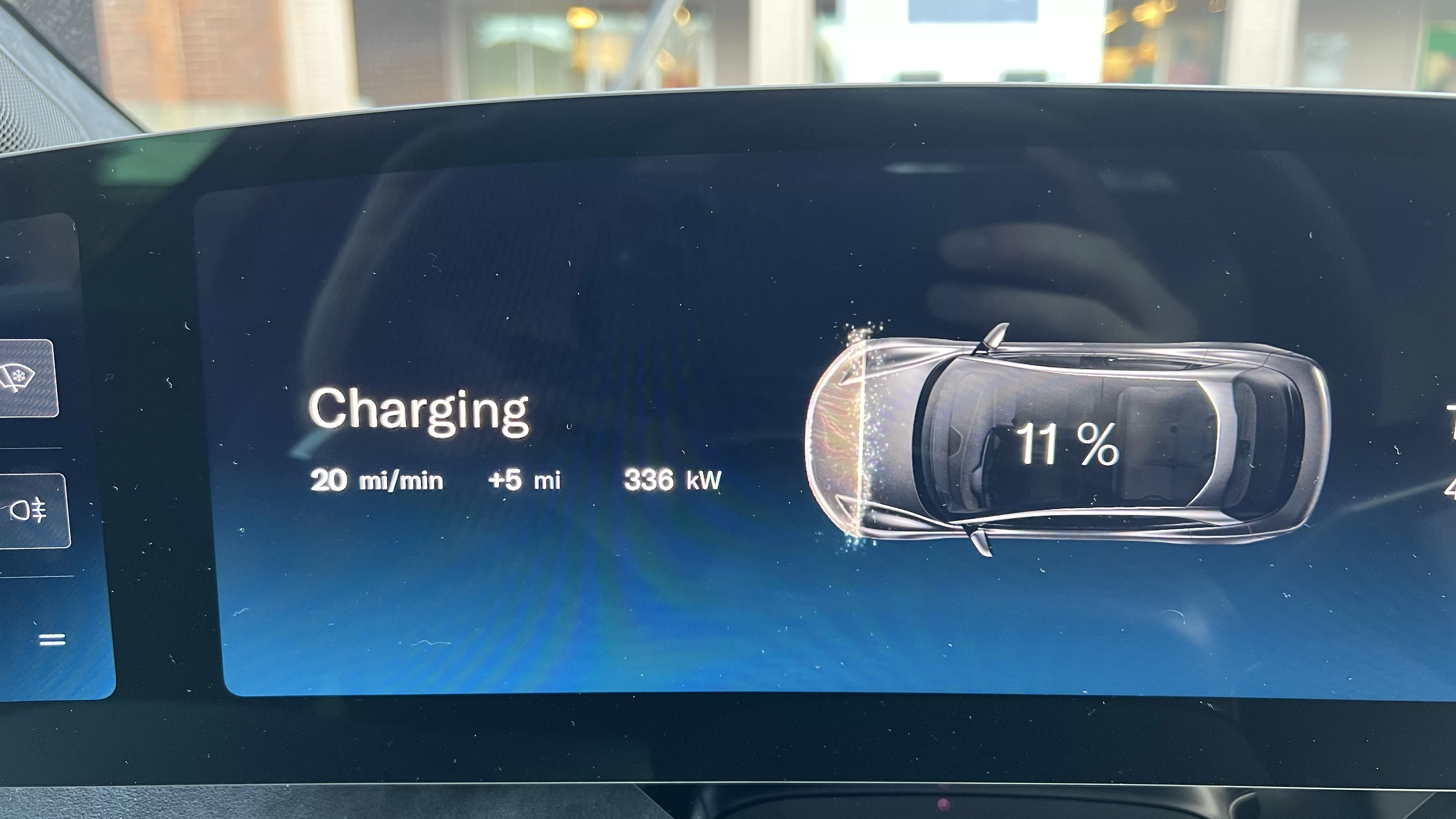

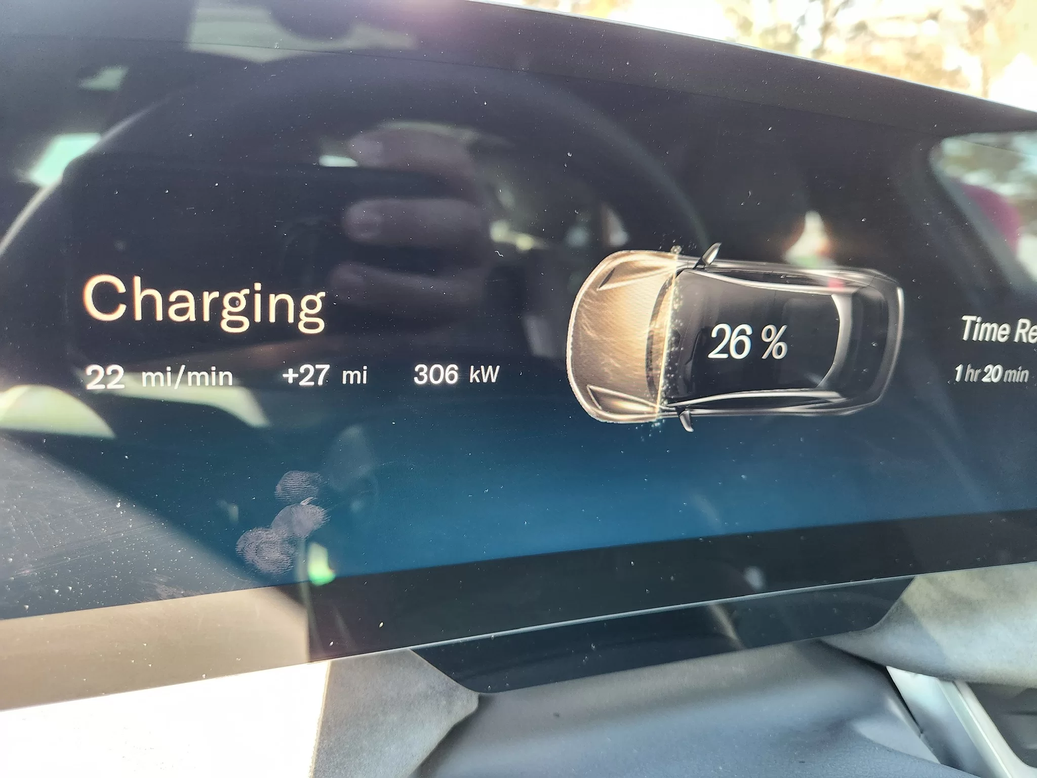

350kW is not the bar. The Air under perfect conditions is going to max out around 300kW and only below 15% state of charge.
At 29% max is below 250kW.

Very nice. i stand corrected. I should not have presented 300kW as an absolute. Average or typical max rates would have been a better choice.
Average is not a suitable matric here. Average will vary based on various factors e.g. your SOC.
To be fair, I've only gone above 300 once 😁
There are lots of factors. Including when you go over 300 it’s not going to be for long. 3-5 minutes max. In the testing that’s been done the Air typically self limits to ~300 as pulling more requires it to reduce faster as heat builds.
