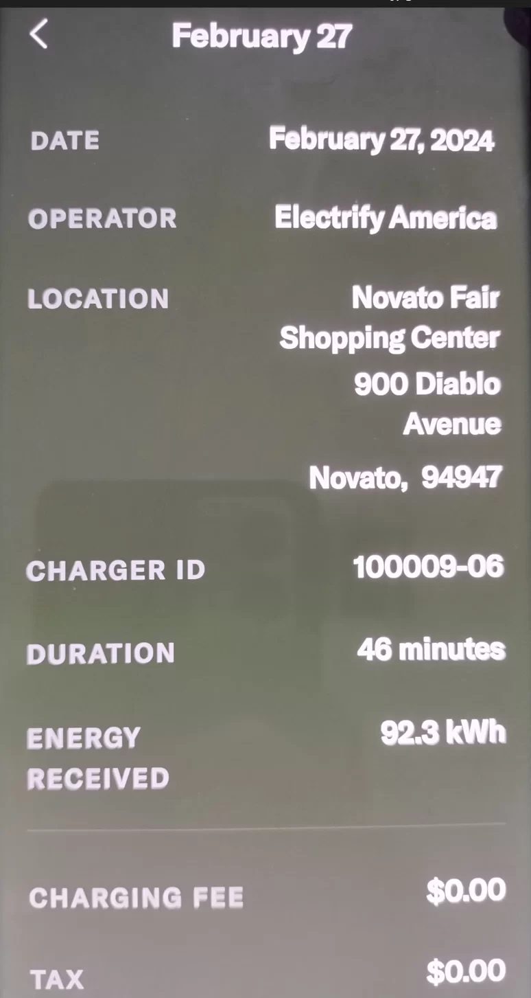

Here is one:
From about 1% SoC to ~82% based on this screen's metrics.
I don't know whether the Lucid App captures the actual "beneficial kWh added" (i.e., actually electrons in the HV battery that is now ready to power the car), or the # kWh charged by EA, which includes the overhead stuff. I suspect it is the # kWh charged by EA. If so, this includes the "non-beneficial" kWh as described in the SoC videos. If so, the 46min of charge time, plus about 3-5 min of setup and authentication, would have resulted in ~78% SoC fill.
Here is one:
Here is the screen shot
Welcome any insight.
Well for one, this isn't 10-80....this is an 82% total charge, so im not sure if that's 1-83 or 8-90....but maybe it's expected especially if you went above 80. It does get reeeal slow up there.
I don't recall what the starting SoC was. It is not unusual I'd run it down to below 10% before charging.
The second point is, I think this metric represents the billed EV kWs, which includes the non-beneficial kWh consumed during the charging cycle.
Since the available metrics might not allow us to pin point the starting SoC, we can still estimate the best and worst case bounds. Fair?
I think best case if this was 0-82 would be around 40 minutes.
Worst case If this was 10-92 it would be an hour lol.
