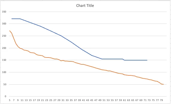

Just looking at 30% SOC, Shane's kw is 182 not 147?Here I drew it out. Is this clear? Rogue's GTP curve in blue...Shane's curve in orange
At 20% SOC, Touring is 58% of GTP (170/290)
At 30% SOC, Touring is 58% of GTP (147/250)
At 50% SOC, this is the absolute best the Touring does and is at 70% (111/155)
At 70% SOC, Touring is at 50% of GTP (75/150)
No, you're mixing up Volund's GT and Shane's Touring in his post. The Touring is at 147 at 30% SOC and the GT is at 182Just looking at 30% SOC, Shane's kw is 182 not 147?
Whoops, I take back my previous 3 postsNo, you're mixing up Volund's GT and Shane's Touring in his post. The Touring is at 147 at 30% SOC and the GT is at 182
Whoops, I take back my previous 3 posts![]()
