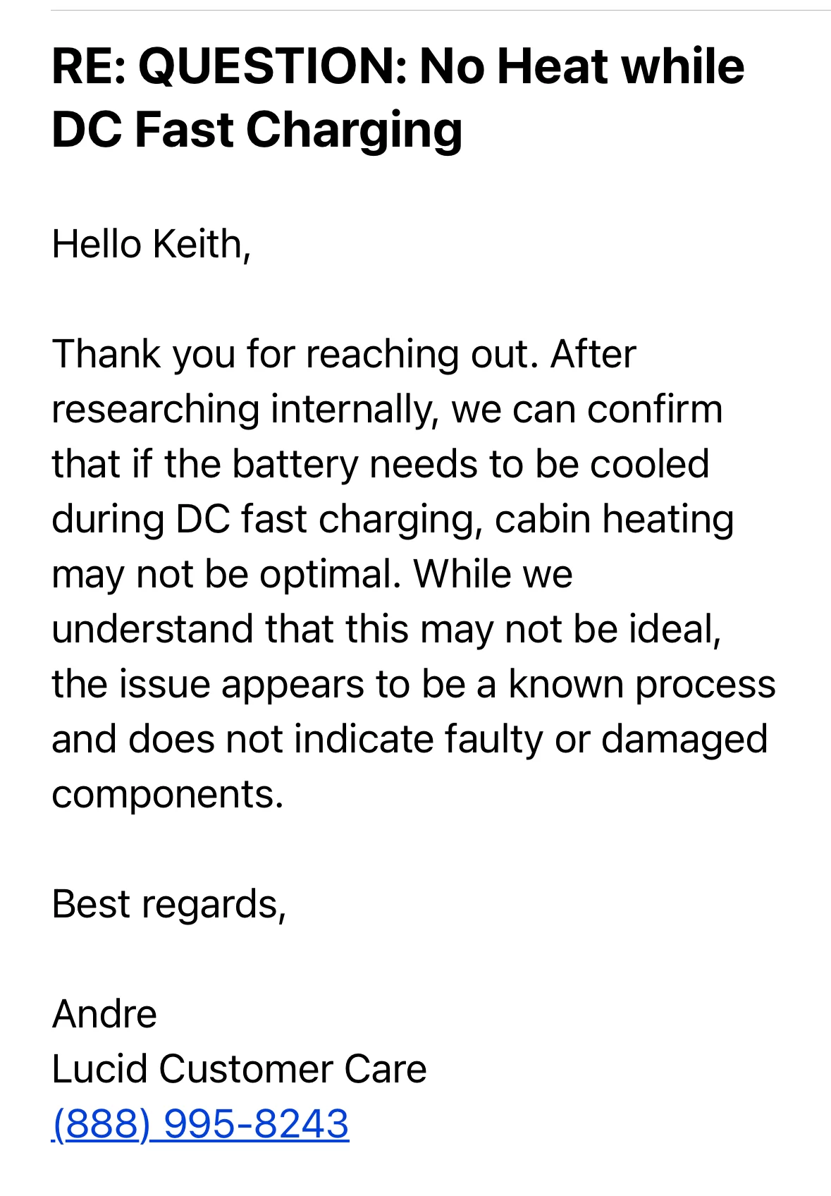

Over Thanksgiving last month we drove our Air Pure from NH to FL. Charging added about 4 hours to the trip, and thankfully the EA chargers worked and we really never waited in line.
One bothersome issue we had however was Cabin Heat while DC Fast Charging. I only noticed this the one time. While at Walmart somewhere in GA late at night it was very chilly and we put on the heat; the heated seats were working. Set to the maximum value, we never got any warm air from the vents. After disconnecting and driving off, we did have heat.
I spoke to the Mobile Tech (who was here for the Easy Entry Seat Homing) about this. He said he hadn't heard of this before and we discussed the "heat loop" and heater core radiator (which I didn't think the Air had) .. and he speculated that it could be an energy conservation thing while charging. I really didn't buy that .. and he said he'd check with the other techs.
Q: Has anyone experienced no Cabin Heat while DC Fast Charging?
Thanks /keith

I find Cabin heat is not functional when Pre conditioning the battery too. I am traveling from Minneapolis to Florida and have to stop every 200miles, last 50 miles of 200 is no heat 🥶.

FYI & FWIW - It *was* GA where we had no heat while charging (about 9pm). But it was missing in the previously posted table because is hadn't showed up in the Lucid App Charging History. The $$$ is calculated from .48/kw EA cost though actually paid by Lucid free EA charging. I estimated the numbers for line 6, and also added the Distance between charging as well per Google Maps. I suggested to Customer Care they add the odometer to the Charging History if that would be possible. /keith

I crank the the heat as I near the station and until battery cooling starts. The cabin has been nice and toasty for me with this methI’d….for the most part.
