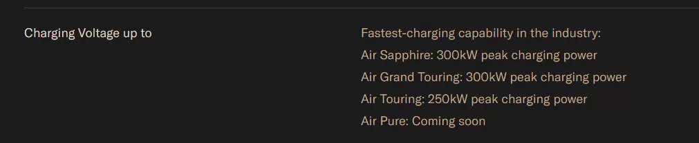

Thanks for the responses! The question I am asking though is what is the maximum rated KW (not kwh) input that the Air Pure model is capable of
accepting? The other models have posted specifications (see image below) but I cannot find it for the Air Pure model.
Should be similar to Touring.
It should be 250 kW like the Touring, yes. I've seen over 200 kW briefly in my Touring, but only when I'm around/below 20% charge and have preconditioned. And in warm weather. And at the right charger. Lots of conditions, unfortunately. That said topping out at 95 kW sounds like you're just at a bad charger if you're under say 50% charged. Like @Lucken said, 150 kW chargers from EA tend to be more reliable for some reason. Try some others and see if you have better luck.

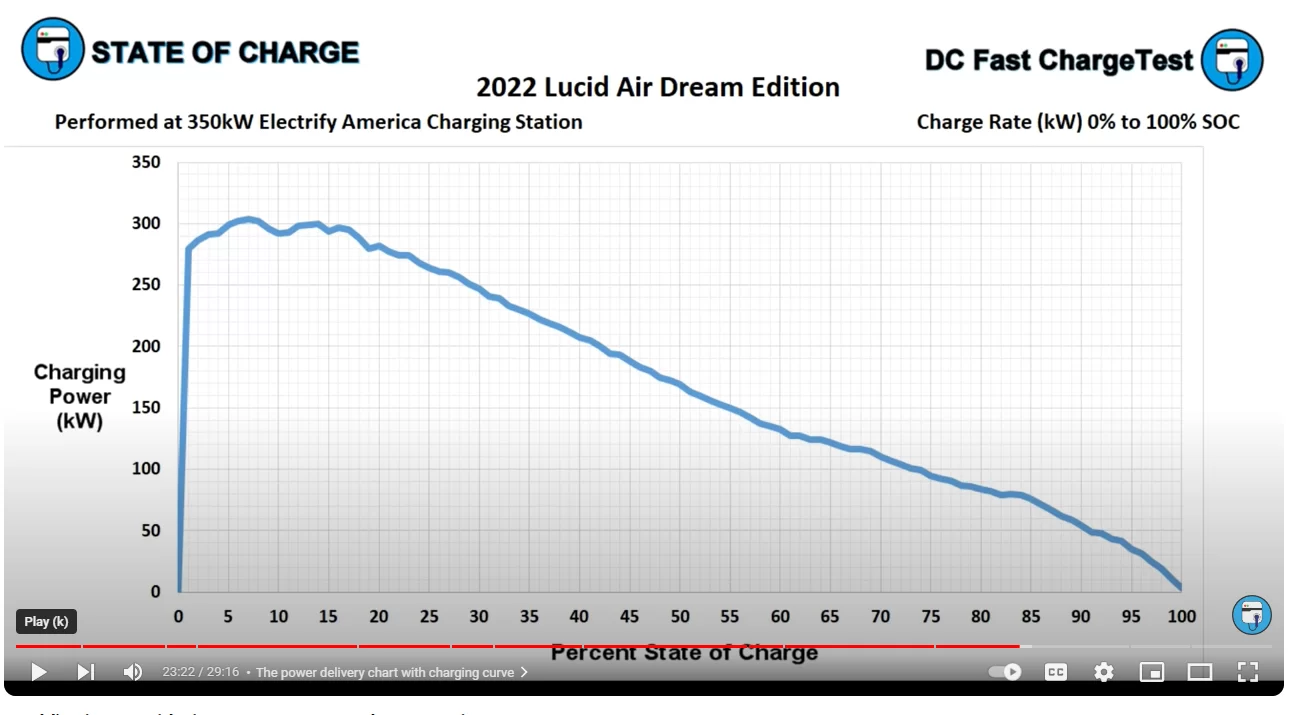

By the way, if you want to geek out on this stuff State of Charge website is an excellent source of information. All EV's have a charging curve- it is not a flat line so depending on where you are in the charging cycle the KW input from the charger to the car will vary. If the Air Pure truly can accept 200 KW input (not sure why they have not published that since Lucid is typically very open about this kind of stuff) then I should see close to that at the beginning of the charge.
Just so you know, this has been discussed many times here. If you do a search you’ll see the many discussions replete with many charging curve graphs.
Yeah- I assumed so, that is why I stated the whole thread with "I assume this has already been discussed before . . .". If you can point me to where someone answered my question about why I only see 95 KW peak input when it is presumably rated for at least 200 KW input that would be cool.

Keep in mind there are two different specs for the Pure. The AWD should be the same as the Touring, at 250. Not sure what the smaller battery on the RWD Pure gets.
I agree it’s odd if Lucid isn’t publishing that somewhere. I haven’t looked.

Lucid made a lot of changes to the Touring to dumb it down so people like me could afford it (without meanwhile getting a divorce which was a close call . . .). I am not ready to assume the charging infrastructure was replicated from the Touring. I think some official Lucid people monitor this forum and can answer my simple question. What maximum KW input is the Air Pure designed to accept from a DC charger?
Per Lucid, it is actually the same as the Touring model. 250 KW max input at DC fast chargers.

I usually see 156-174 kW early in the charging process at EA's 350 kW chargers but also their 150 kW chargers go above 150 kW sometimes. 2023 Pure.
