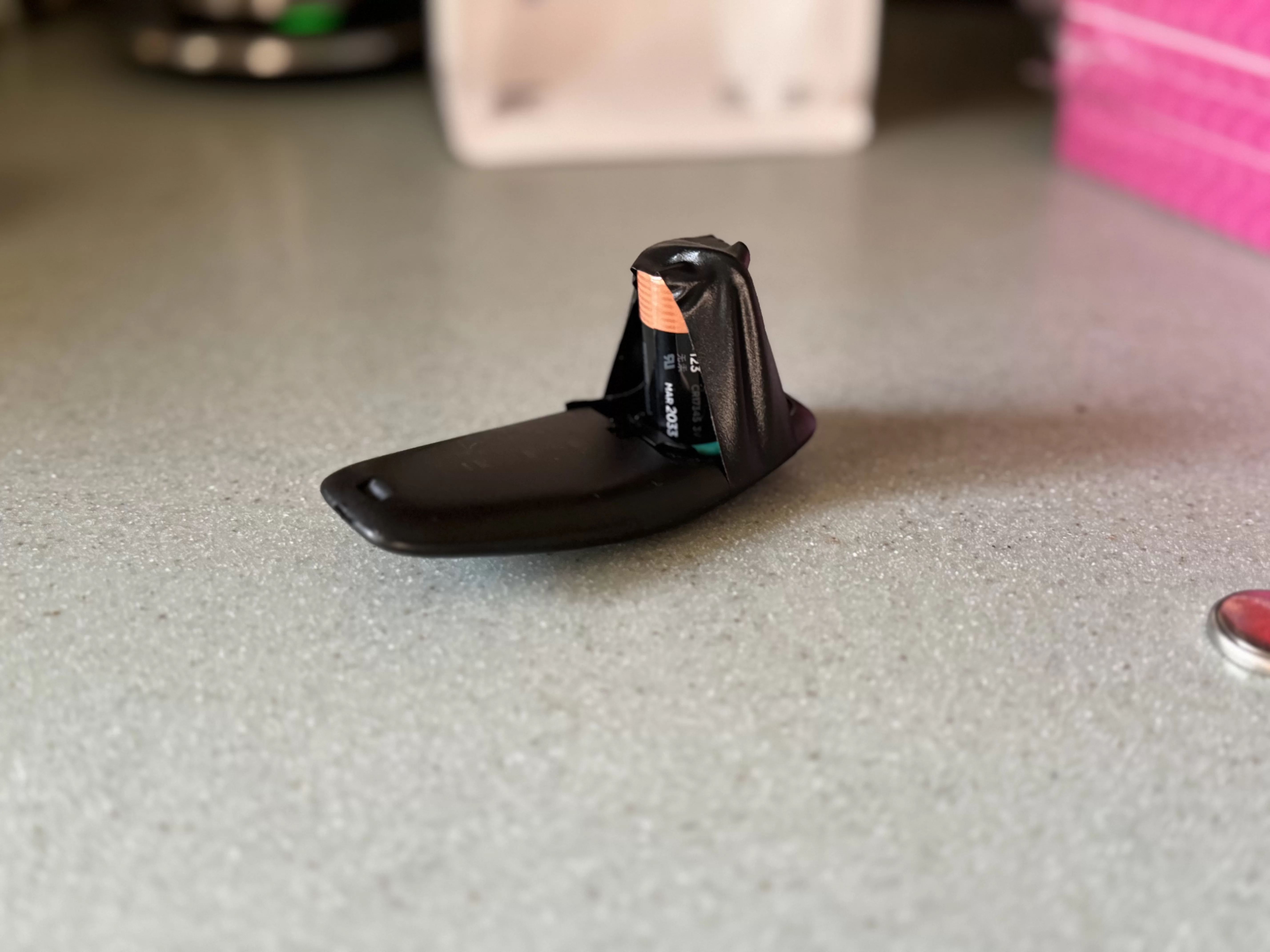

Seems we had some similar ideas
Works great!
The performance actually seems better as well, not just the lifetime, I assume due to voltage drop in all the mostly-dead CR2032s.
Works great!
And you won't lose it in your pocket!

I love that picture!!!! Thanks. I see at least 3 paths now:
1 - Live with it or use the mobile key. (Not for me.)
2 - Rube Goldberg. Fashion a new case or leather key case that would hold a CR2 or larger CR123. That method might include removing the electronics from the old Lucid key and putting it into the new shell or case - perhaps also including a proper new physical button. Are there any folks listening with access to 3D printing capabilities here? I'd glady pay $50 for a new shell.
3 - Pressuring Lucid for a proper key, including legal efforts. Are their any attorneys listening? Does the Gravity key solve this problem? It has nice needed physical buttons.
Every other car I have driven, including cheap barebones rentals, does not have this problem. I'm sure that Lucid could have found a key vendor to do a small run of generic keys with Lucid coding. Instead it appears that they picked a vendor that does high end stylish keys but ignored the power budget.
