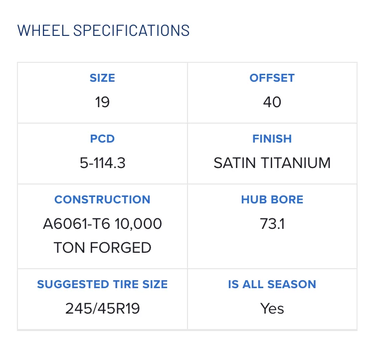

Indeed. But that’s not the state that many of us spend the majority of our driving time in. Stopping and starting as well as accelerating and decelerating may be more significant, especially with the Lucid on high regen mode where a slight variation in pedal pressure results in immediate acceleration or deceleration. Thus, rotational inertia (and therefore wheel weight) may have a larger role.For steady-speed freeway range, wheel weight makes little difference. Tire type (tread design, structure and compounds) and wheel aerodynamics can affect range up to about 10-15%.
I swapped out my OEM wheels for completely non-aero wheels that where significantly lighter and kept the exact same size and tires on them and I’ve driven over 6k miles since the swap and have noticed no decrease in range. That made me curious about the impact of rotational inertia or other factors on range in normal driving. But I don’t have a clue about the physics. @Jeanwoodie seemed quite knowledgeable, so I asked
