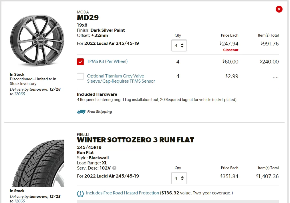

Tire Rack does have options for 19"s....just bought this set for the winter to replace my 21's.
So it looks like you spent about 3000 for non aero wheels through tire rack . I paid just over 4k for a factory set installed by lucid.
Total cost was 2,473.71 delivered including:

And just to follow up, I LOVE the 21's! But in upstate NY in snow and freezing temps, I needed the winter tires. I was going to get the 20's, as I like that look as well, but the cost of the 20's was $3900 without tires. When I priced out winter tires for the 20's, that was another $1200 (or maybe $1400, IDR). So it was $5100 for 20's or $2500 for 19's....I went with the cheap route.
Just so you know, the user manual specifically states Run Flats are not compatible with the Air.
Or, I should say, they officially recommend not using run flats. Not sure why.
I think your OEM is HL grade in load range where as his Pirelli winter tires are XL grade. Air is heavy at 5500 lbs skateboard battery recommended for HL grade.
