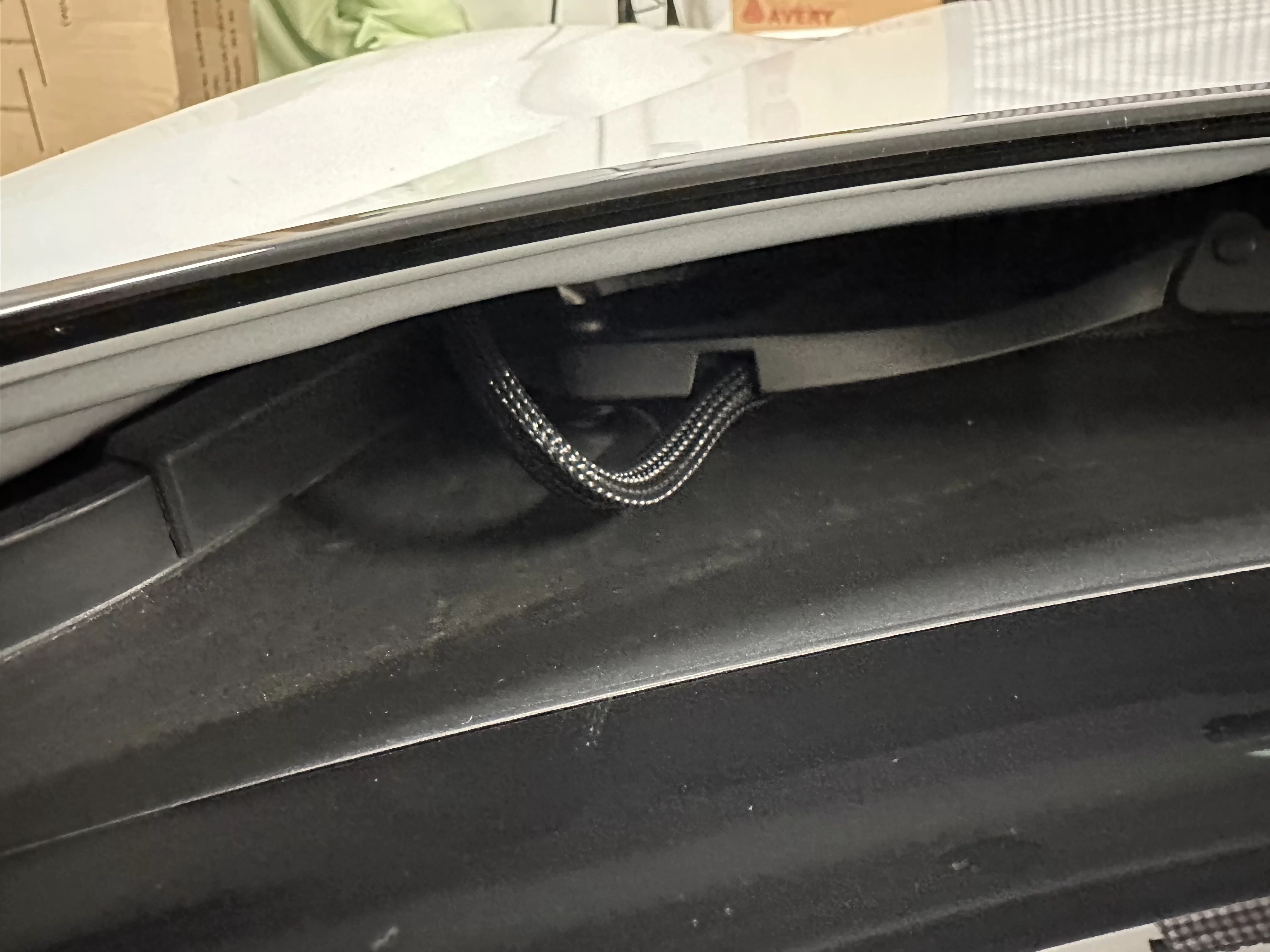

Interesting, my windshield at speeds over 72mph when it’s below 40 degrees makes a weird buzzing wispy sound that’s pretty quiet but still noticeable, at first it sounded like a loose piece of paper flapping but I think it’s a very small seal imperfection only noticeable when it’s cold. I’ll have them check it out when I get the 12k mile service.
I have experienced the same buzzing noise from the lower left side of windshield above 75mph speed.
IMO it might be the left wiper fluid feeding hose rattling with the hood.
Anybody visit SC with this noise?
There is a TSB for this. It’s coming from the ducts above the headlights. Techs insert a foam square into each duct. I fixed the fluttering noise for me. Call or text service.
