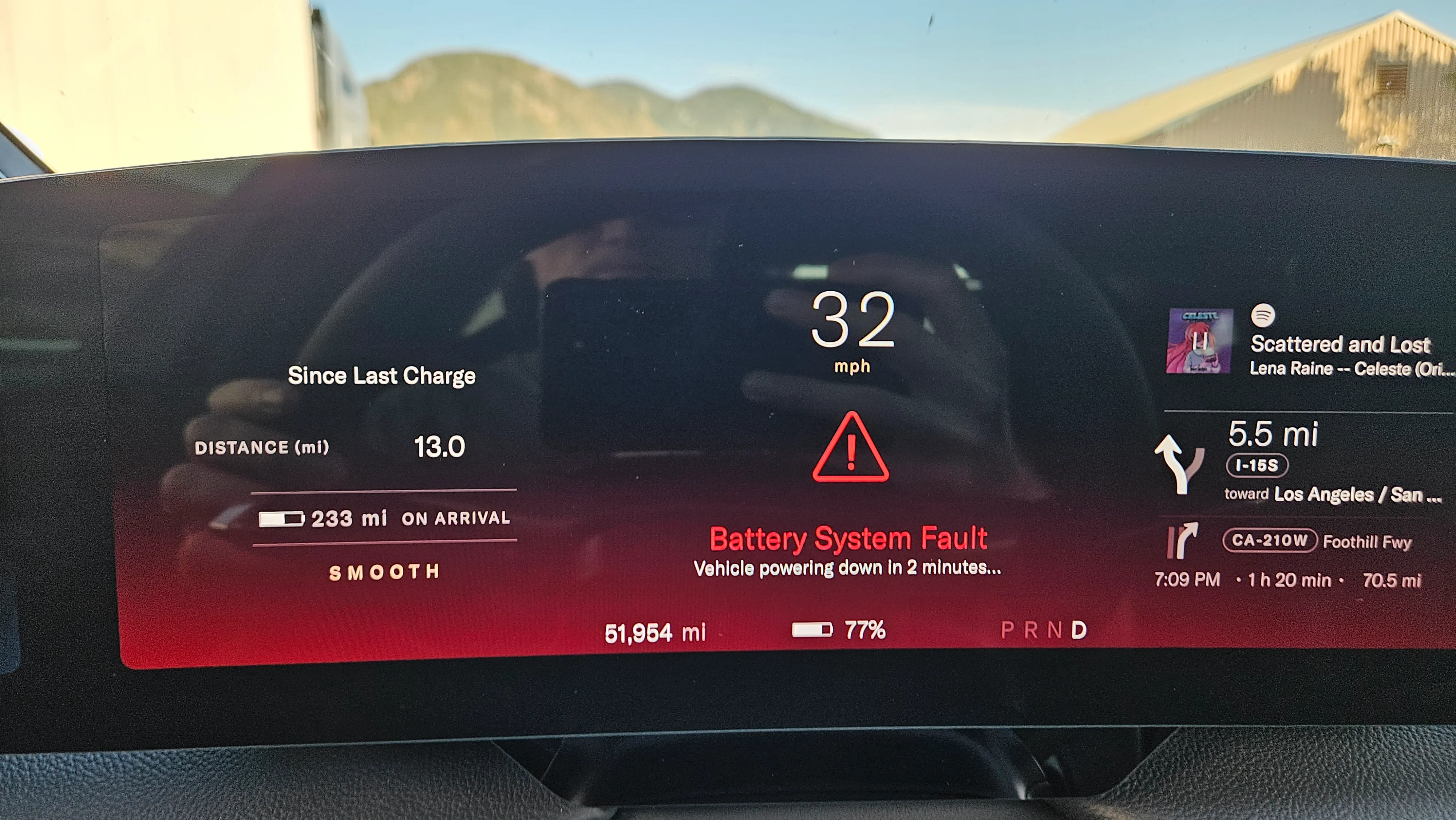

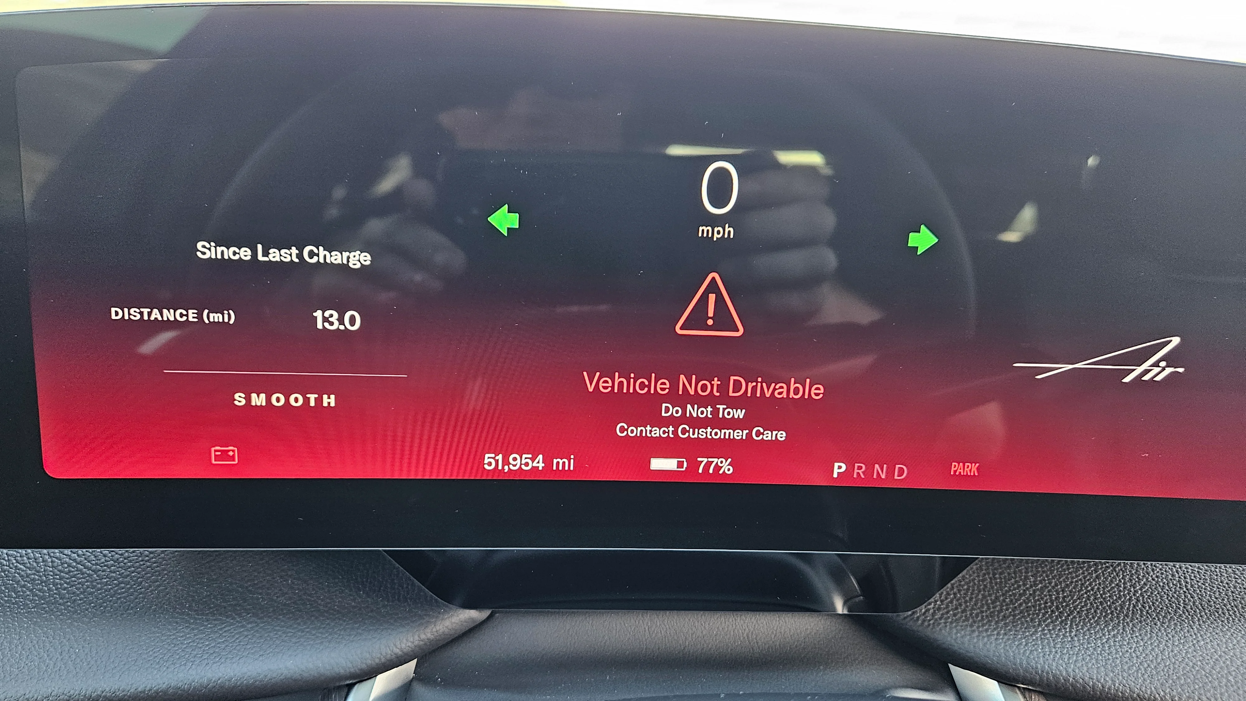

I just wanted to make other owners aware of the possibility of an AC compressor failure I just experienced with my car. For me, at least, it caused the vehicle to completely shut down, so hopefully this can help others avoid the same situation. I haven't heard of any others having this issue, so it's possible that mine is just an extreme or isolated case.
The failure occurred while I was driving out to California with multiple DC charging sessions and warm weather (95-100F). I first noticed weak charging performance on my 2nd and 3rd charging stops when temperatures were at their highest. On my final charging stop, I began to notice the AC compressor making unusual noises in addition to the poor charging performance. Also, air conditioning had stopped working at this point, so it seemed likely something was wrong with the cooling system.
After resuming my trip on the highway and about 30-45 minutes of driving, I received the dreaded "Battery System Fault" message and was given 2 minutes to pull off the highway before the vehicle shut down. The vehicle was then towed to the nearest service center where it is currently being worked on.

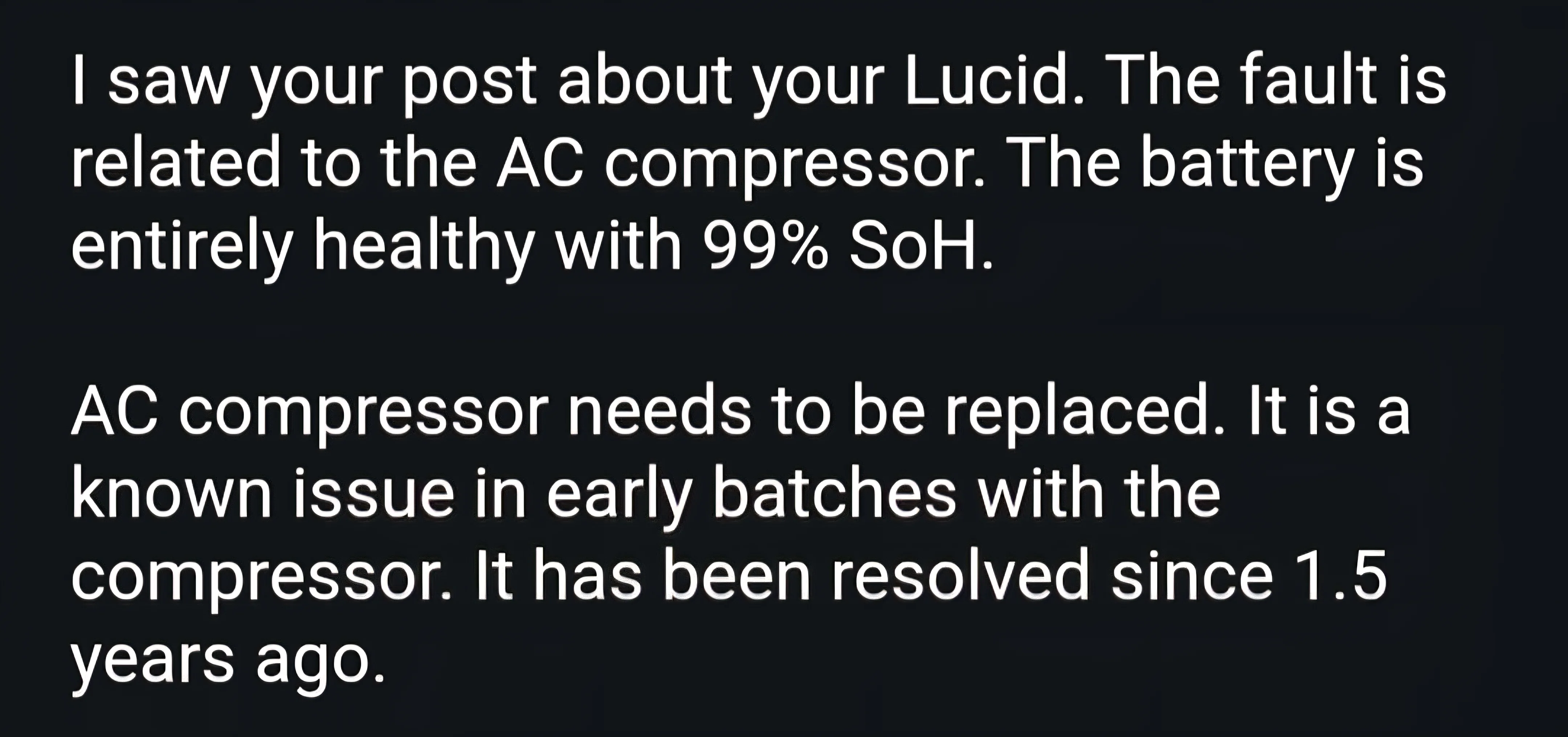

Per Emad Dlala himself, this was caused by an AC compressor failure, which is a known issue. Per his email, this was resolved 1.5 years ago, which is I assume means any Air produced before December 2023 (including mine) could have this faulty AC compressor. For reference, my car had a little over 51,000 miles when this occurred.
To summarize, if you notice weak DC charging performance in warm weather, odd AC compressor noises, and/or loss of air conditioning, just be cautious and reach out to service to have them evaluate. I've included a clip of the noises I was hearing, in case that helps.

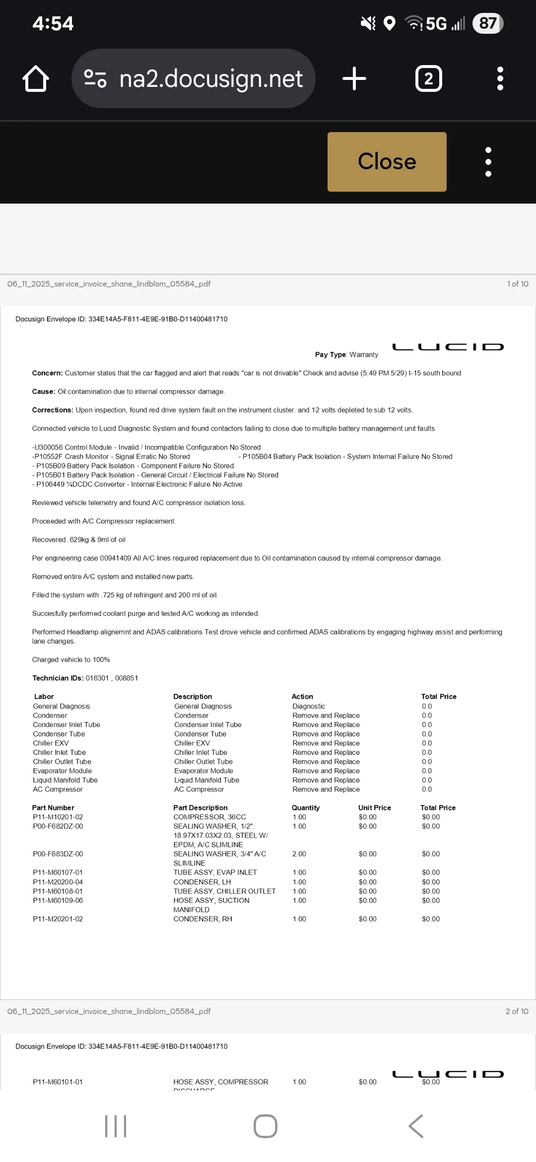

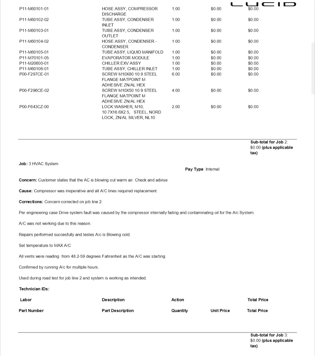

I am in Saudi Arabia and just had mine replaced. They replaced the whole system and brought it to Gravity level. Attached is the invoice post work. So many parts replaced.
The AC now is completely different, too cold and cools very quickly.
