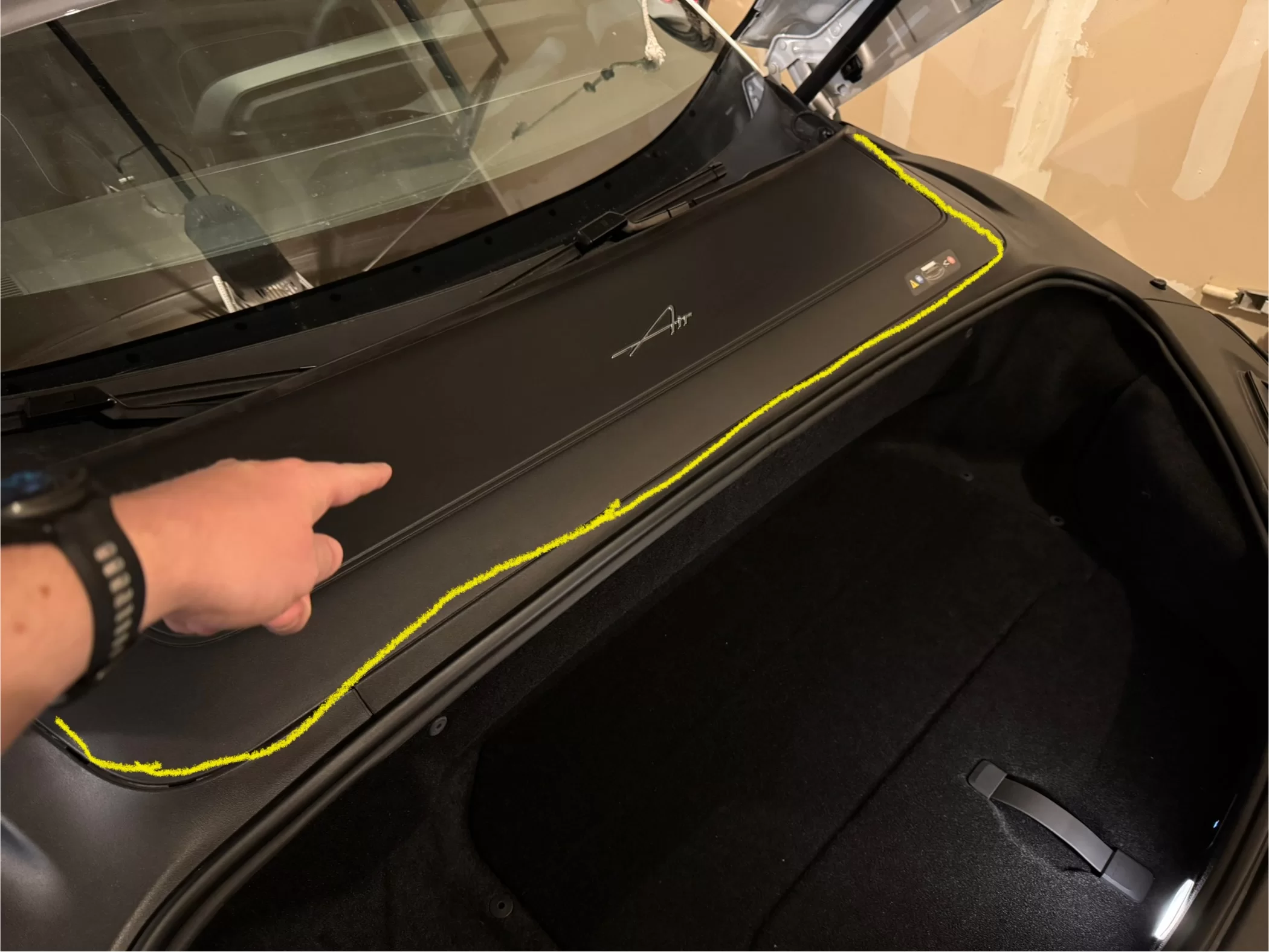

Those clips break basically every time you take that cover off, but I’ve never heard a knocking noise from it. Fascinating.I have my car back, and took a photo of the culprit element. It was replaced and everything sounds good so far. Photo attached, with my finger over the replaced part. It’s only part of the whole drape assembly. I (poorly) traced a yellow line along the edges.
On the underside, there are thin rib / filaments that run across which were bent / warped, and the technician also though the whole component had too much flex in the plastic.
Hope that helps, in case anyone else is facing a similar problem.
