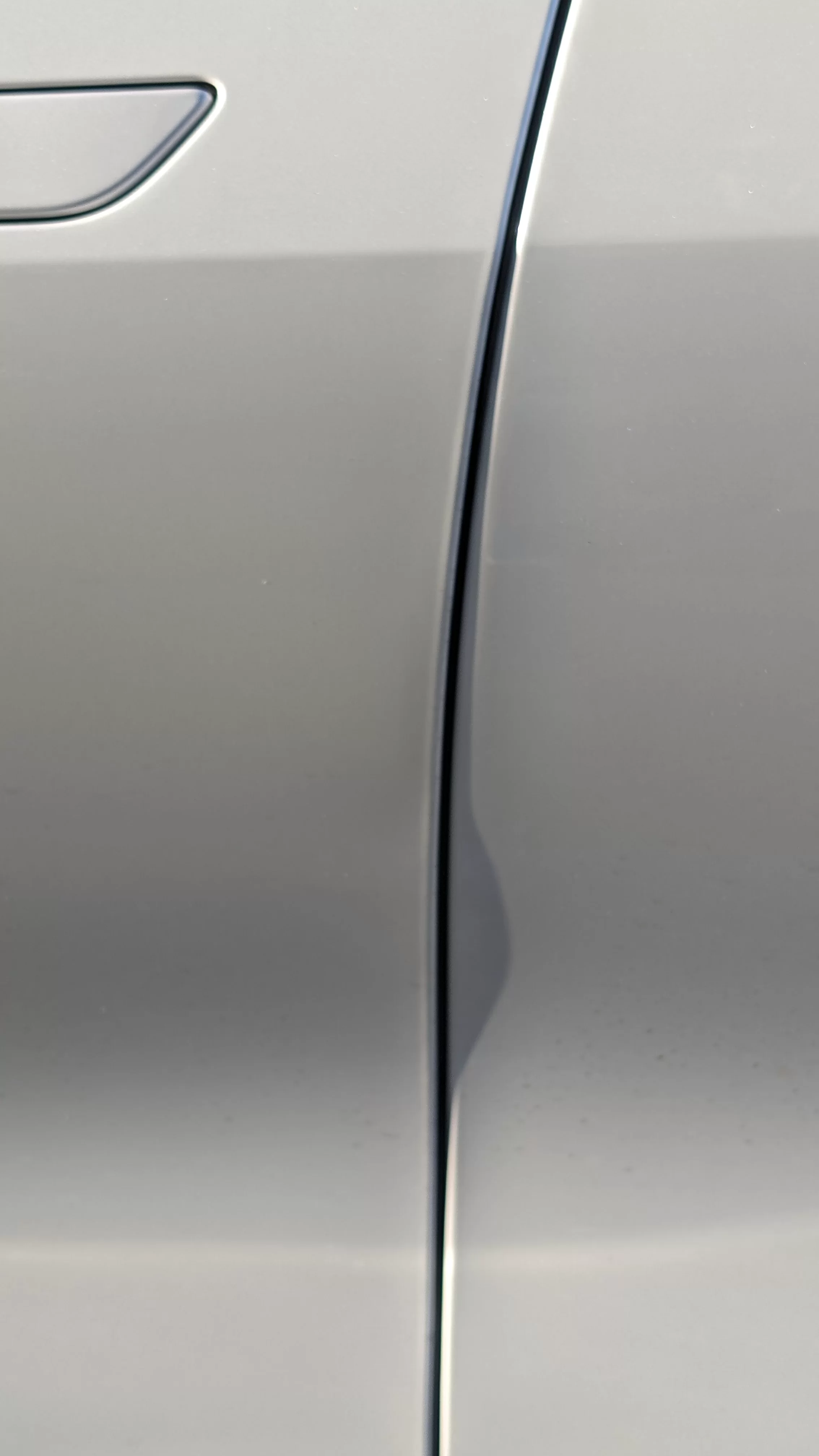

Per your request, here is a photo of the black strip I am talking about. With the door closed, pushing on the top of it will roll the strip a little closer to the body of the car. The objective is to gets the strip on the passenger door to stick out no further than the same strip does on the driver door, but it will also push the horizontal rubber gasket behind it a little closer to the body frame. If you actually open the door and roll it gently with both hands, you get more movement than you would if you just push on it with the door closed. While my service tech seemed to think that the improvement was due to a cleaner air flow, I think it's at least equally possible that getting that rubber seal in a little tighter may have had the bigger positive effect. Whatever the cause and effect, at least in my case, it seemed to help.

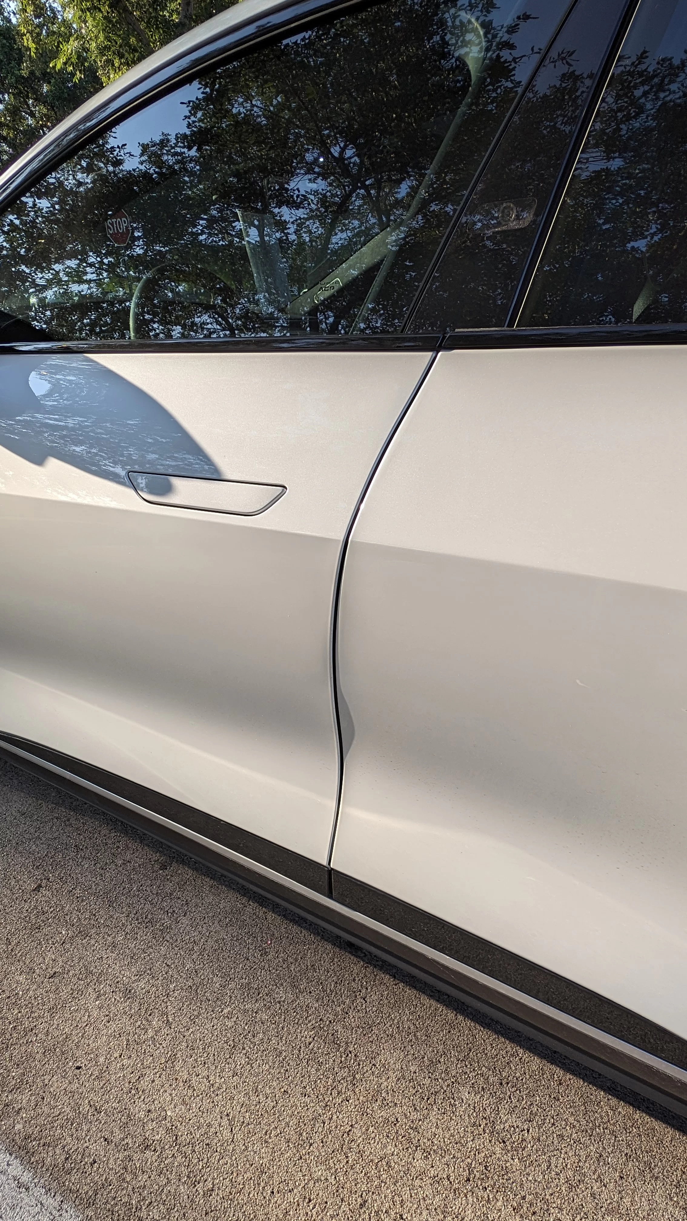

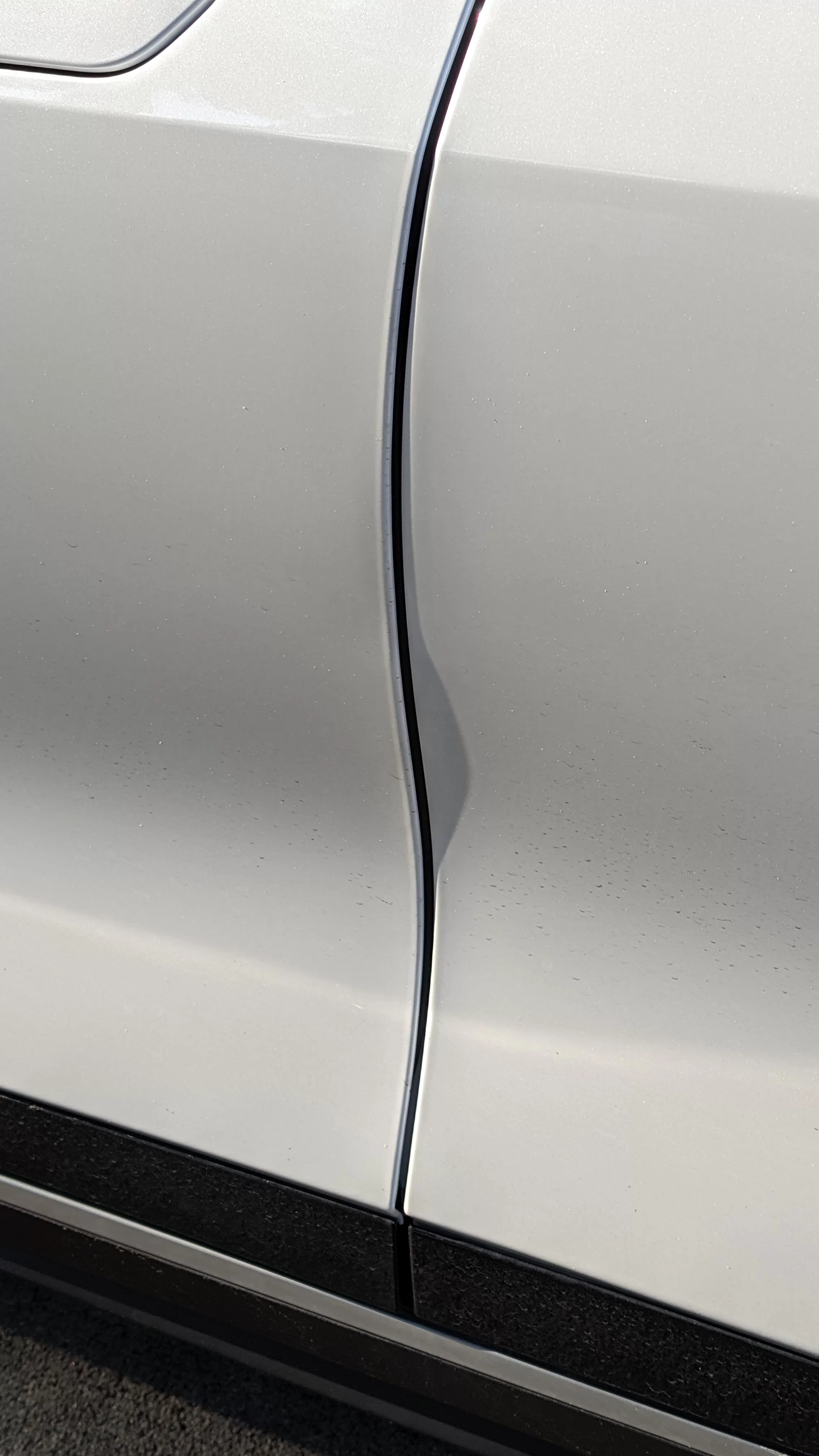

While walking towards my car around sunset this shadow stood out..! Is this the smoking gun for my wind noise issues? Thoughts and comments please? Could this be causing my wind noise or buffeting!?

Adjust the striker.
Don't know how to do it ..I unscrewed the screws which have tight tolerances..and other than screwing it back in..not sure what else to do differently
Adjust the striker.
I did this and moved the striker in and even gently bent an inch long piece of my door today with pliers so now it sits perfectly flush with the rear door panel. And though I've only driven on street roads not highway, the WIND NOISE SEEMS MUCH BETTER..I'd say up to 70% reduction...can't wait to take it on the freeway for a proper test...thanks @Bobby !
Took it on the freeway and tested at various speeds..while not 100% eliminated, the wind noise is now much less of an issue... previously I'd start hearing it at as low as 45mph..but now it doesn't make a sound until I hit say 70mps or so...which is huge for me...definitely it was the movement of the striker that helped out and I also ensured in a dark garage with an a flashlight that the shadow of the front door edge were perfectly in line with the read door panel...took a few mins..but now the car is much more in line with my expectations..

Sure, I'll try and get to it soon..give me a few days...but first step I did was to turn the lights off in the garage, and used a flashlight to run it a few inches behind the door edge to determine which areas were sitting too proud of the panel. Then I marked it with a dry erase marker. Then I unscrewed the door striker, and with the bolts quite loose, I was able to move the striker a couple of millimeters in towards the cabin of the car. I used my wife's help to hold the striker steady as I screwed it back in. This allows the door to close more 'tightly' if that makes sense and eliminated the door sitting too proud against the other panel. Once I was satisfied that the door panels are flush, it made a drastic difference in the wind noise/buffeting. REfer to some of my photos in a few posts prior to this one to see what it looked like 'before'.
