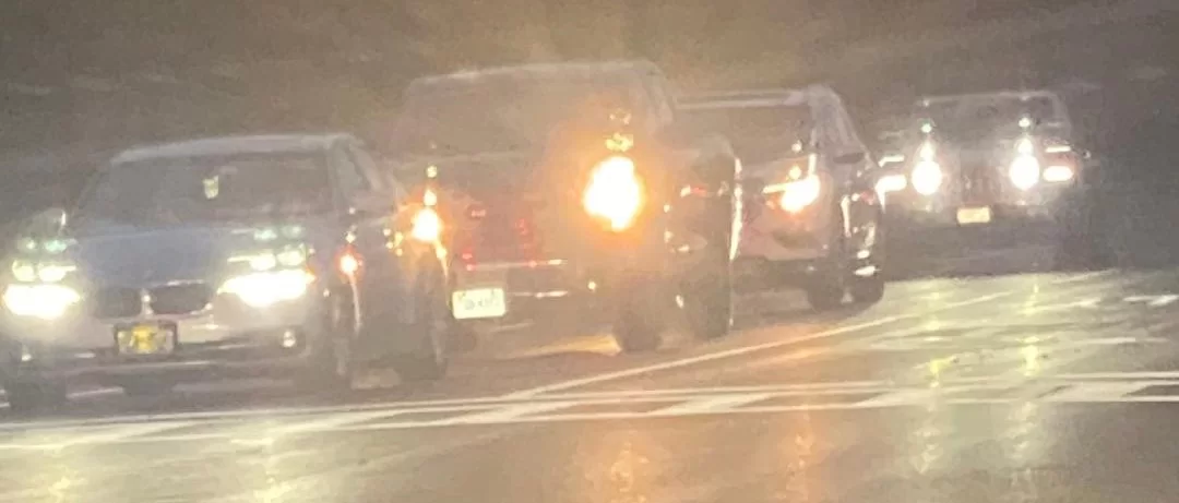

What Me, and some others, are referring to is this:
See how the headlights are showing up multiple times ABOVE the actual headlights? If I were to move the camera UP or DOWN by 6 inches, those duplications would disappear.
The doubling of the stitch is caused by the same thing. If you zoom in you can see that the stitch appears multiple times. If I'd moved the camera down a bit that doubling also disappeared.
Thank you sir! I stand corrected!
