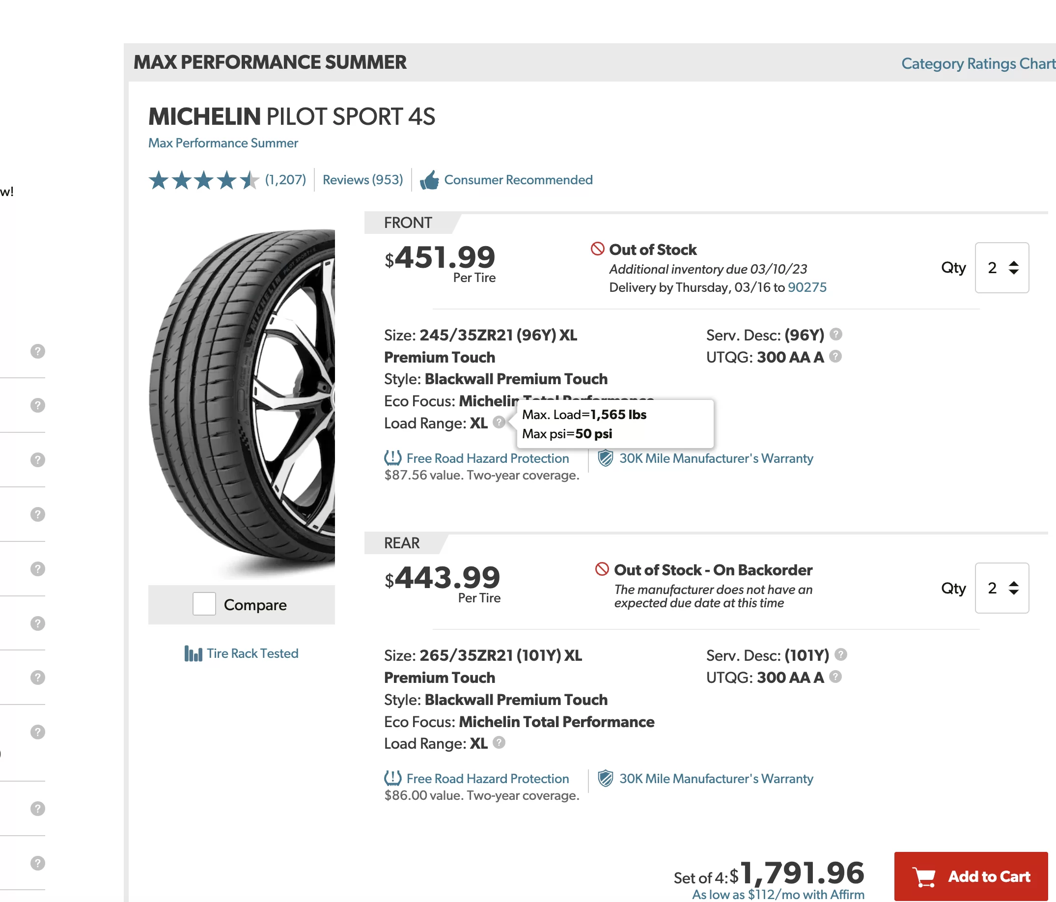

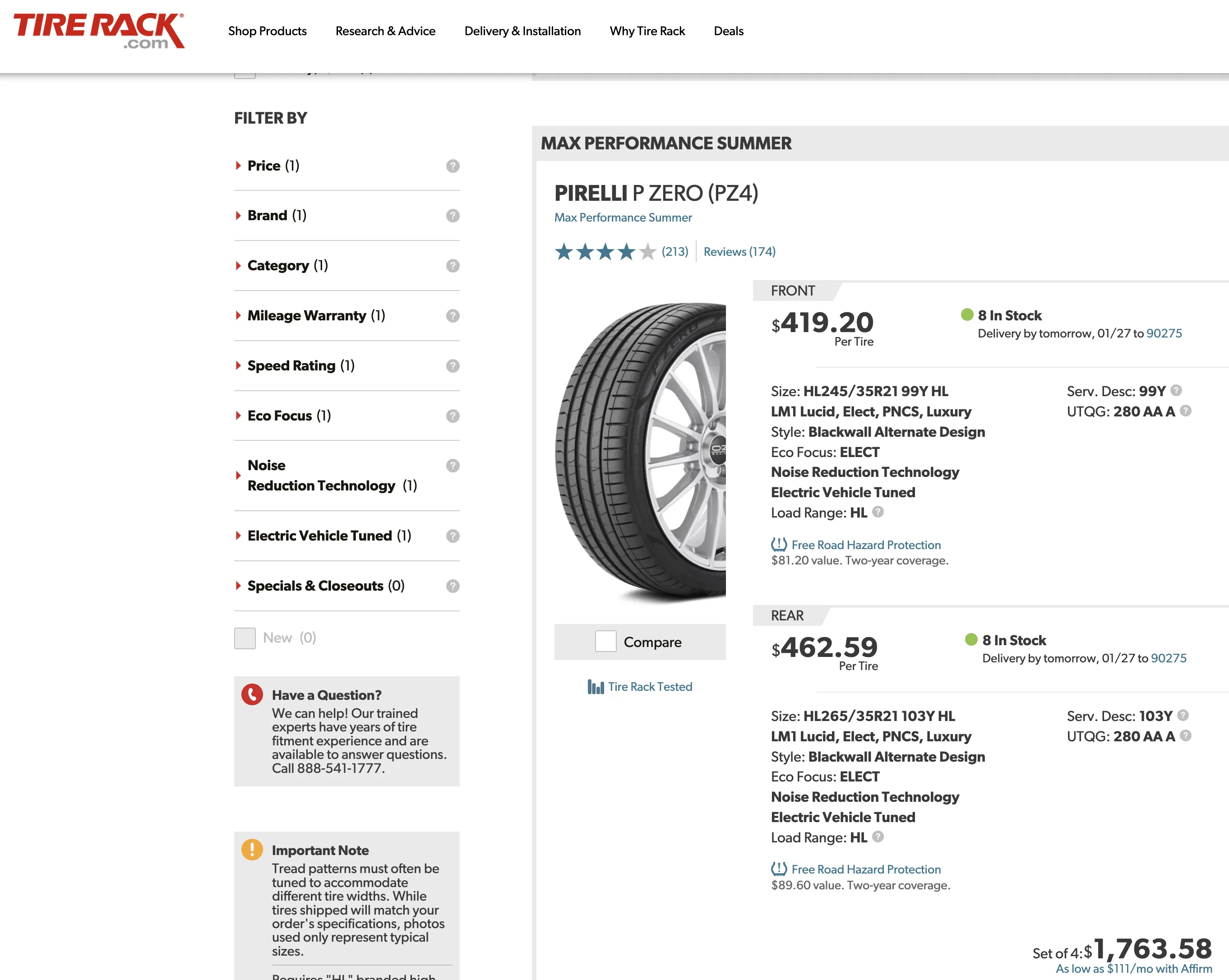

I looked at TireRack.com- Pirelli was the only offering for the 21 inch Lucid wheels w a HL load rating of 1700 lbs. There are other tires of similar size but the load rating is XL (1500 lbs). Not sure if 200 lb load rating is significant or not- thoughts?

The Gross Weight (fully loaded max permitted) is over 6,000 lbs (check your sticker on the door frame), so 1,500 lbs per tire wouldn't be within specs. 1,700 would be. Not that you might ever drive at the max weight, but if you were to be in an accident that could be a factor the insurance companies or lawyers take into consideration. Blowout? Well, wrong tire for that car. Ran off the road? Etc

The 21" selection is indeed a bit more problematic... 6000 lbs (4x1500) vs 6800 lbs (4x1700) does seem significant on a 5200+ base weight (then add in 4 people & luggage).
