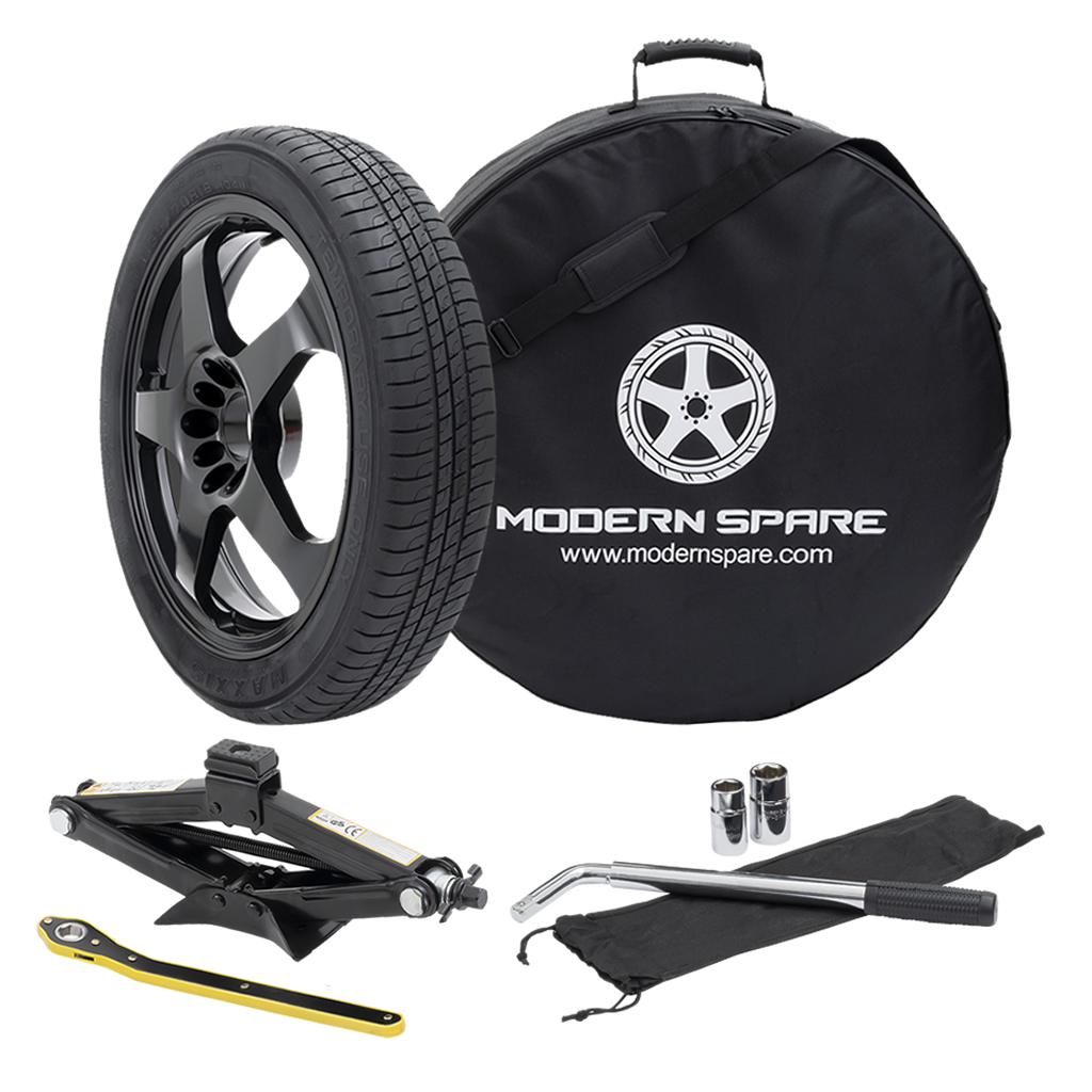

OK, what's the consensus on the best spare to buy?
modernspare.com
There are about 4 spare tire options specifically designed for Lucid. I went with EV Sportsline spare because I think it looks the best. Otherwise, they are all essentially the same. The spare tires are all the same size and should just barely fit in the lower well of the frunk with the cover in place.OK, what's the consensus on the best spare to buy?
Get a lug wrench. Be aware that ground clearance with normal tire pressure is low, and with a flat tire is too low to fit a jack under the car. You will need an air pump to inflate the flat until you can place the jack. I got a compact rechargeable air pump for $40 at Costco. It fits in the glovebox, and it works very well. If you cannot inflate the flat, I believe that the chassis is stiff enough to use the other jack point.I just ordered the EZ Spare but didn't order the accessory jack. I am looking to get a three ton jack, are there any specific brand recommendations? Do I need the rubber bumper on top of the jack (advertised to be intended to be used with Teslas) or does the jack fit into a cutout underneath the car? I don't see any lug wrench in my truck where the tow bar sits so I need to order one of those, and nothing listed on the Lucid accessories/parts website. I will reach out to their Parts Department unless someone has an aftermarket recommendation? Thanks!
