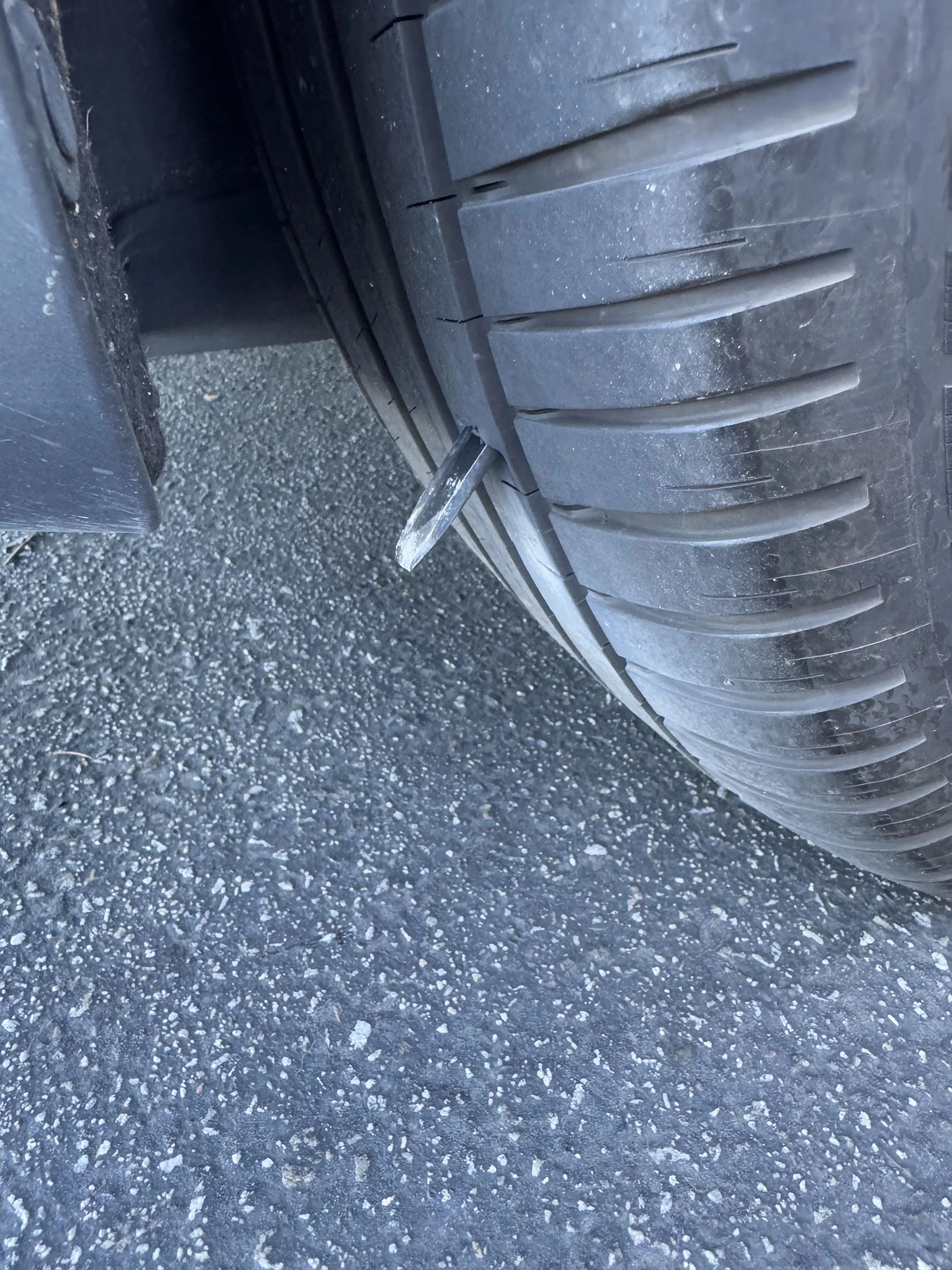

Navigating the Unexpected: A Two-Week Journey with My New GT and a Flat Tire

It has been 4 days, the tire is holding pressure, there is no vibration or anything unusual while driving. I'm thinking there is no need to replace the tire. I'll keep the two new tires I've ordered till I get a more serious flat that can't be plugged.
Well, the plugged tire lasted, along with the rest of them, 32K miles and got replaced with another set of Michelins - the two I bought a year go and the two more bought right before the replacement

Got a nasty one today on a Sunday. Lucid couldn’t swap in the field and wanted to tow to the nearest service center 60 miles away. I declined and called AAA to tow it to a tire shop 3 miles away. Because it’s Sunday and shops don’t stock the 20s, will need to wait. I am guessing since Lucid isn’t performing the service, they won’t offer a loaner.
This is not bad at all because the hole is not on the side of the tire, I have never bought into the paradigm of replacing an EV tire merely because it is flat. You can easily repair it and save the dough. Just ask the shop to do a cold vulcanization or a chemical cure process to repair your tire. You can even order a tire patch kit (rope plugs or sticky strings) from Amazon and patch it without removing the tire, albeit it is more reliable to ask the tire shop to do a cold patch for you. Word of caution, do not let the shop patch the tire by applying heat, that can damage internal foam of EV tire. Most shops do vulcanization without applying heat anyways.
