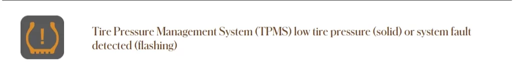

1. Lack of Tire Pressure Alerts: Surprisingly, the car's system does not warn of low air pressure. I scoured the system settings but found no option to monitor tire pressure, which seems like a significant oversight. Maybe it is there, but I can't find it.
I could have sworn that I have seen a LOW PRESSURE alert icon pop up on my screen.
It does do that. Maybe it doesn't pop up if you start out with a flat tire or something? No idea. But I do know when I popped a tire, that light came on immediately.

Today my low tire pressure indicator popped up on my way home from work. Checked the tire pressures - sure enough the passengers side front tire is at 40 psi, was nominal in the morning. Checked the tread - a short screw (1/4" long or so) in the tire. Got home, used my tire repair kit with gummy strips, sealed the leak. Used my inflator that I always carry in the trunk. Thought that is it... until I read the messages on this forum. Are you saying even such a benign puncture has ruined the tire? It may have not even penetrated the foam. Anyway, I'll have to drive on this tire until I get a replacement and have it installed. I am driving on the factory 19" ones. See photo by clicking the link below
