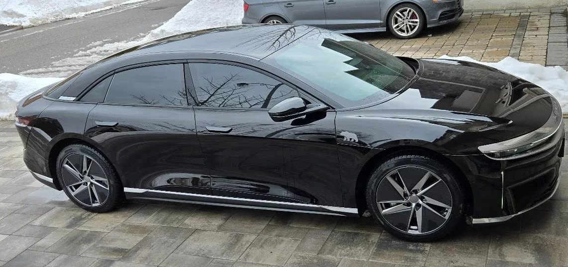

Wheel/tire combination has been excellent. Also very smooth (my local tire shop did a great job balancing the tires -- I'm picky for wheel balancing)View attachment 27800
Those look really good. I bought my lucid from inventory and the "best fit" for the colors/options I wanted came with the 20" wheels and summer tires. I need to get a set of 19s by winter. Do you mind if I ask exactly what sizes (width)/offsets you got? Is it square all around? I was checking tirerack and can't seem to find this brand though.
Fast Wheels EV01+ 5x120, ET37, 19x8.5", CB 64.1, Flow formed, Aero blades.
Width 8.5"
offset ET37
19" same on all 4 wheels w/ 245/45R19
Width 8.5"
offset ET37
