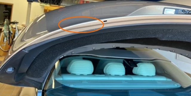

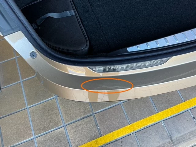

I "have" this problem too. The car is in service too correct this and some other issues. See attached pictures which show that the rear trunk is misaligned. There is a different gap between the trunk and bumper. On the left side, the trunk actually touches the bumper and the paint is already worn on the trunk and bumper.

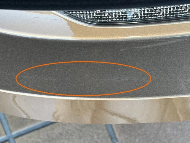

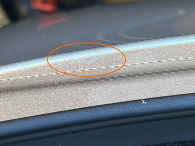

There are no horizontal scratches under that yellow oval on the car. That is an artifact of the photograph. There are innumerable discrete spots, almost as if someone had moved along a line using a tiny jackhammer. Same thing on the bumper and the trunk lid.
That's a really strange camera artifact that many of us are seeing. I've had a number of cars where I have fine scratches on the top of the bumper that look exactly like that. But you're standing there, so you would know best.
Here's one more picture, showing there are no horizontal scratches.
Keep in mind that this whole area is only about 1.5" long. These divots are very tiny and only are noticeable because there are so many of them. I really think it's road dust that got ground into the paint from the trunk lid scuffing against the bumper. That's the only way to explain identical paint damage on both parts in the same place.

YES!!! Alex, thank you. That is exactly the kind of damage I'm seeing, both on the bumper and the corresponding underside of the trunk lid.

My iPhone wouldn't focus at the close range I used in order to show these are not linear scratches but discrete divots.
Alex's pictures show exactly the kind of paint damage I have, both on his bumper and trunk lid.
The only difference is that my damage is almost dead center (near the trunk latch) instead of off to one side due to a trunk misalignment. My trunk lid and bumper show a consistent gap and don't touch when the car is stationary. That's why I think there must be some slight deformation to one component or the other during driving.
Alex must be experiencing this same deformation, too, as his lid doesn't seem to be touching the bumper when stationary (although the uneven gap is clearly visible).

OK, got it. What many of us were seeing were more common fine horizontal scratches below the damaged area you've been pointing out. It shows clearly in the first shot which is sharp, and it seems to extend quite a bit more than an 1 1/2". Those are more typical scratches most of us have seen on bumpers of cars we've previously owned.

I went out and looked at the area again from every angle, both in sunlight and under artificial light. There are no horizontal scratches on the car. That was an artifact of my bad photography.

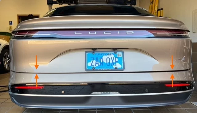

View attachment 624View attachment 625
Your rear image showing the misaligned trunk gap is outstanding. I noted the exact same problem a few days ago when my DE was delivered. The passenger side is gapped and protrudes outward, which is visible to the eye and definitely when you slide a gloved hand from rear quarter panel on to the trunk side. The delivering rep took a photo of it and I noted it in the delivery condition sheet I signed.

You can see from the pictures I posted how much it was misaligned. I can't say how it compares to yours. You couldn't really tell from looking at any other parts of hood gaps, though – just the trunk/bumper gap. The only reason it was sent to the service center was to see if they could correct the paint and to fix some other issues, which were better done at a service center, rather than by the mobile techs. I'm sure the mobile techs could fix the hood alignment. Also, it was convenient to have Lucid dropped the car off at the PPF place (a few miles away), rather than transporting it back to me (100+mi) and I would need to drive it back and get stone damage.
