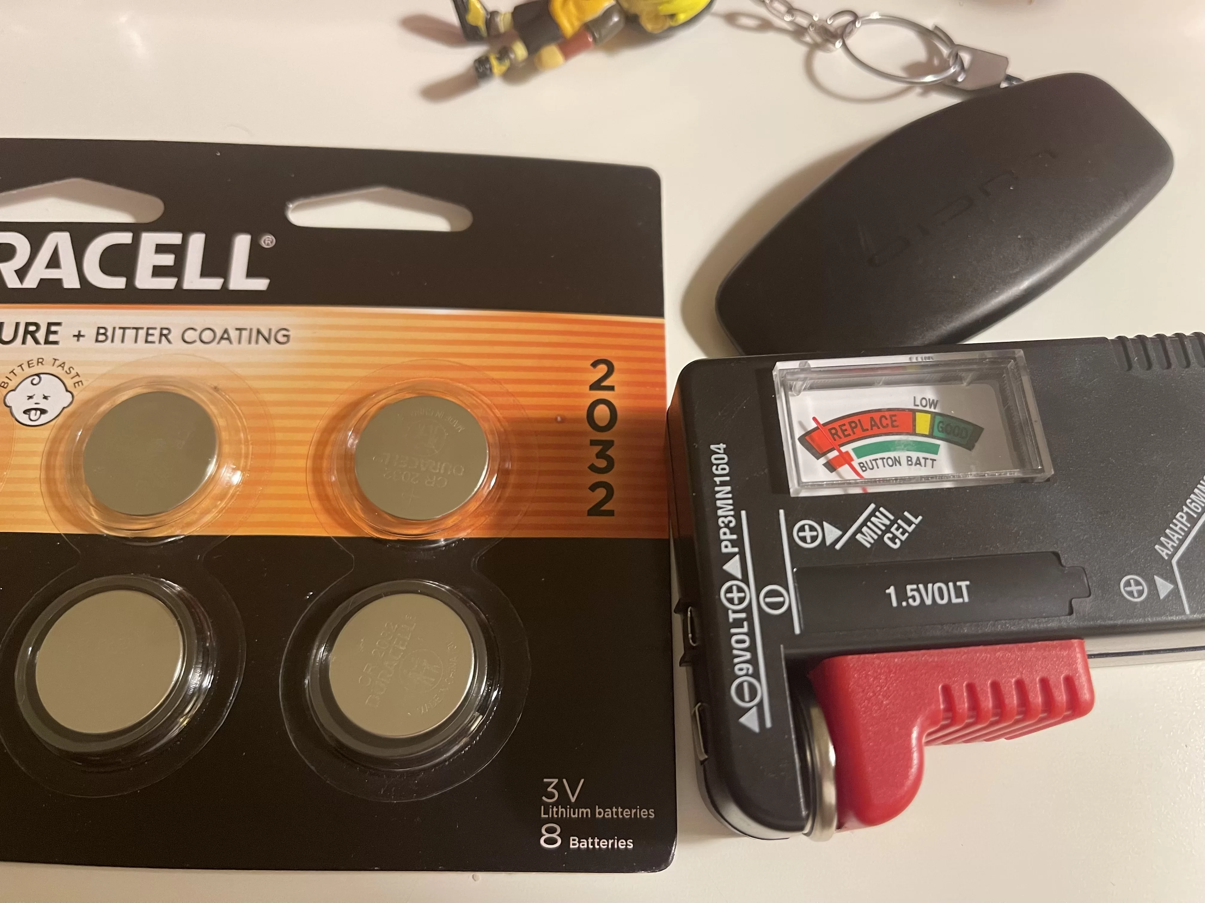

So it is indeed battery issue. I have to change battery 3rd time since delivery. And even when fob battery is dead, mine won’t work putting against B pillar to unlock, I had to use valet key. At this rate, I will only have to go thru 8 batteries per year. 🧐
Now unlock door is back to normal. I wonder why these fobs drain battery so fast even when I store them in faraday pouches.View attachment 4223
I store mine in one as well but I thought they drain in a week so think 26/52 🤪. I never use my Fob and it still drains but I have not checked. All the techs carry batteries. Maybe we need to put in a ticket for it and see if the can address it.
I'm actually going to go take the battery out of my second fob now and leave the two together since its not in use.
