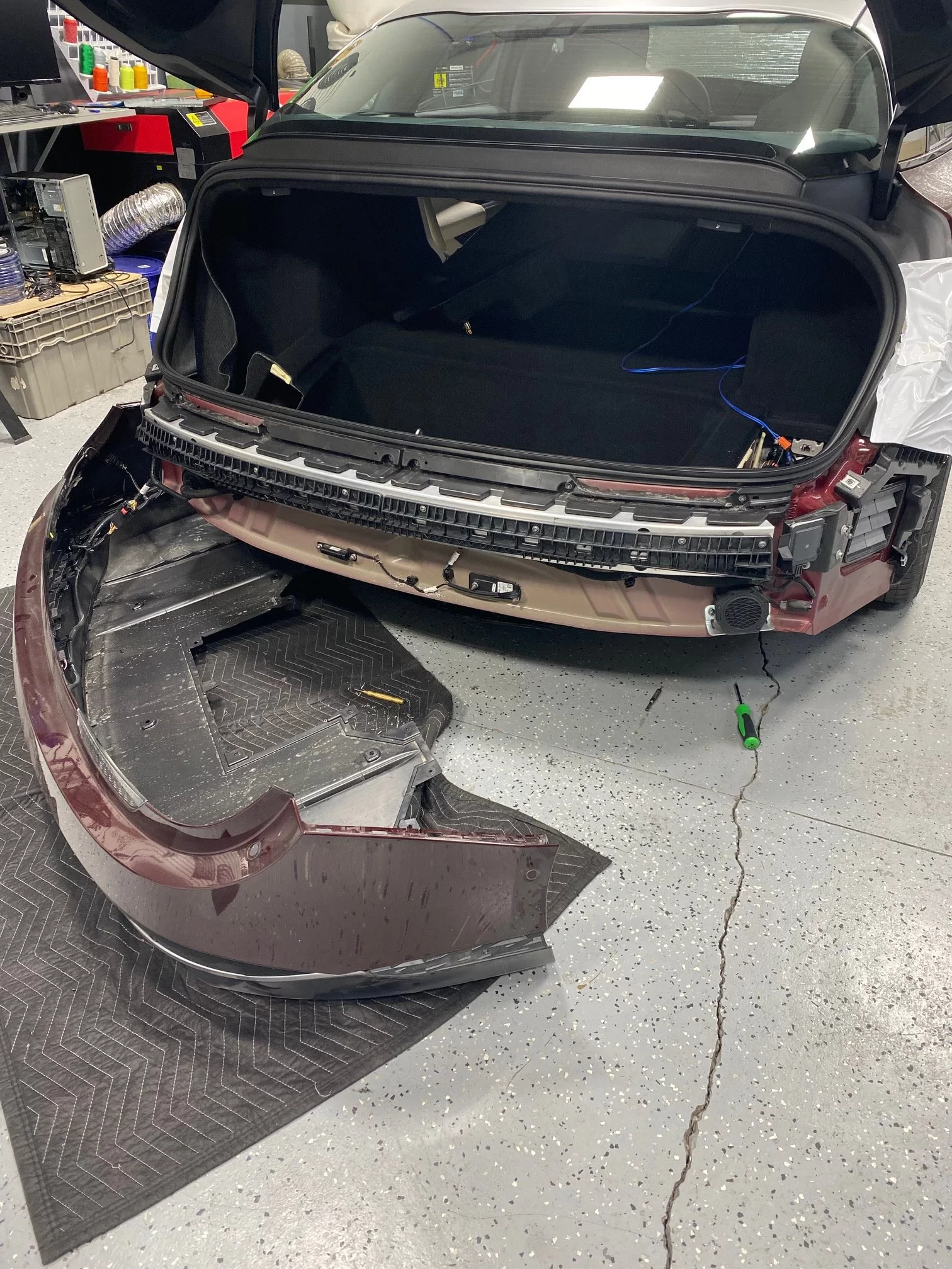

He's now working on the rear sensors:

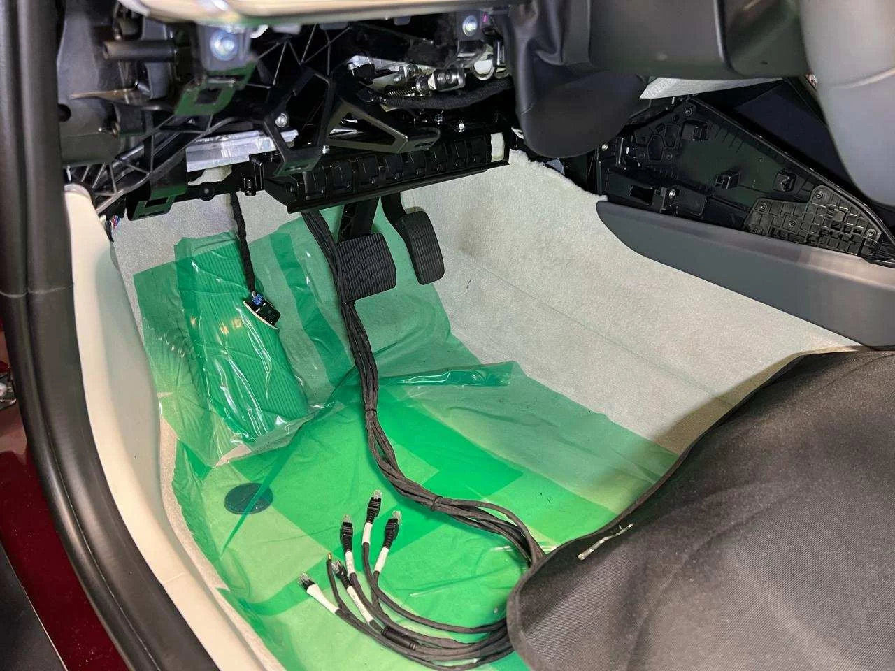

And the left underside of the dash is open to receive the wiring for the control/display unit:
This installer works on exotics such as McLarens and Ferraris, on high-end German cars, and drives a Porsche GT4 himself. I asked him for his impressions of the build quality of the Lucid. He said he saw little difference between this and other cars he works on, with the engineering approaches being typical of what he sees from other brands. He said that unlike some exotics which have to use fiber optic laser sensors due to highly-contoured front ends, the Lucid provides places to mount conventional laser sensors, which are more effective than fiber optic sensors.
He said the only unusual difficulty he encountered is that the wiring leads are very short in the Lucid, and some wires had to be unplugged to get at certain things in this car that he doesn't have to do with other cars.
