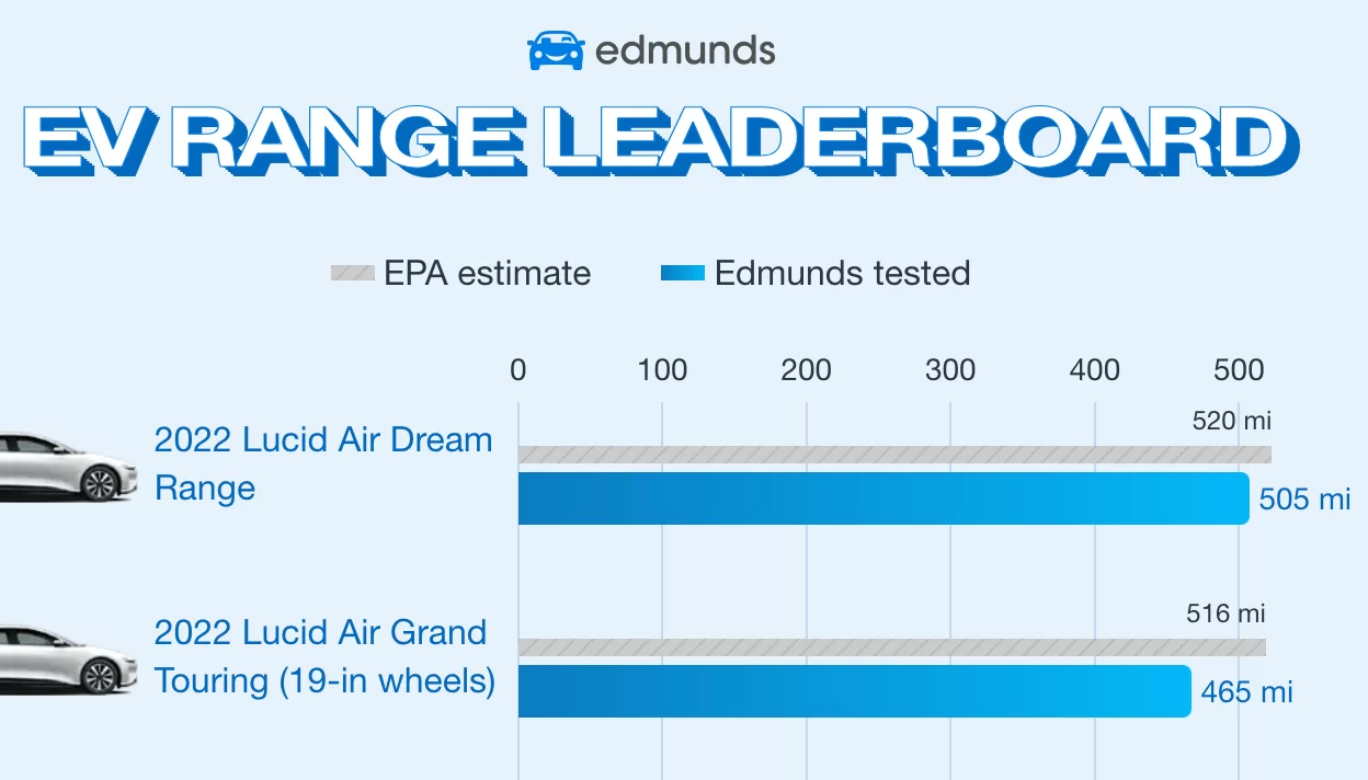

Edmunds tested both on their cycle and found a 50 mile difference between the two. Granted not 100, but still a significant difference

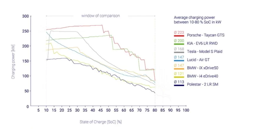

And here's a charge plot of GT. See how far it sits below the model S, whereas in the screenshot from @xponents the dream is slightly faster than the model S
You are welcome to trust a source that does not publish conditions for their charging test, especially when many here have seen more than the 270kW peak observed by Edmunds. I tend to discount anything from them.

Really? They show a lucid air dream doing 516 on their test loop and you think that’s biased? I think that’s pretty exemplary and shows they have no problem posting something that makes lucid look good. Their test of 456 on the GT I think is almost unbelievable. If I was Edmunds and had a bone to pick against lucid, I would cherry pick results that didn’t show 500 miles of range…
Also read this thread and look at the charging curves. And I don’t know why you’re focusing on the peak of 270. That’s not even important. The charge curves match what they posted
...Their test of 456 on the GT I think is almost unbelievable. If I had a bone to pick against lucid, I would publish my 3.0miles/kw rating and say 300 miles out of 500 sucks haha

Lol I said if I was Edmunds and had a bone to pick that’s what I would do. I think they are being extremely generous to Lucid in their results. You can read the range report thread on this forum. Edmunds test is way more optimistic than users on the forum. If you think what I’m saying is incorrect, please share something that says otherwise. I shared public links with very positive results, yet they are still bashed for being biased.

Thanks for clarifying. This thread is about slow charging curves. Am I in the wrong for asking why the dream edition and the GT have significantly different charge curves? Everyone is commenting saying I’m wrong lmao. But how am I wrong!? It’s a public fact and charge curves are posted everywhere that show that the dream has a better charging curve.

To your question on charging curves: the Dream Edition was a limited run, special edition of the car. As such, it had different, way more expensive to produce, charging chemistry. That battery pack was never meant for mass production.
For reasons that go beyond my understanding of physics and chemistry, maybe Lucid has deemed that pack capable of handling a slightly more aggressive curve than other trims? I don’t know. That’s my best guess, if the curves are in fact different. I don’t stress over such things.
What I do know is Lucid has to guarantee all packs for a minimum of 8 years of sustaining at least 80% of their capacity. Their engineers might have deemed the Dream can handle the heat, while the GT, etc might not?
They have science to back that up. It’s not just to spite GT owners. I can guarantee that.
Regardless, curves can be tweaked over time. So it may happen that Lucid reads these packs over the next several years and determines maybe they can push them harder after all? Maybe the curve will be amended at that point? They don’t have any cars on the road for 8 years yet to know for sure. If you were them, wouldn’t you want to be a little more conservative, given you’d be on the hook for replacing thousands of batteries?

I just realized you have a Touring. Your charging curve is also different from a GT and I can't see any data online that shows the charging curve of a Touring. You will also never achieve higher than I think 276?kw? @Adnillien has the math in his head.

You can just multiply the charging power shown on the vertical axis of a GT charging curve by 18/22.
