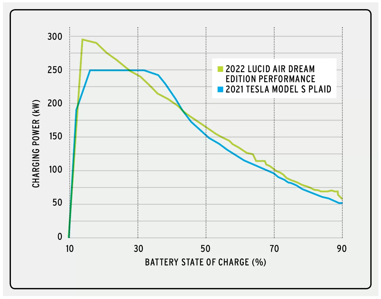

This is all very interesting as i was just reading an article in one of the auto magazines rating the five fastest charging cars. It mentioned that Lucid had the highest peak number of about 320 but that its average was 78 on a charge from 10-90 percent. A number of the other car brands beat us in average charge rate over this test model. I have experienced this same issue when I charge near my home. It starts at 110 but quickly goes down in the mid 70 range. I have a 2023 touring with 3500 miles . Is this a known issue with Lucid? Apparently other are experiencing this same issue.
Not so much an ‘issue’ as Lucid’s preference in formulating the charging curve for the car. They could decide to change this is the future, but for now that’s the way it is.

Where do you go to see the charging curve graphic that I see posted here? I just charged my Pure AWD at EA for the first time. A seamless process, and I added 55.1 kWh in 35 minutes, taking it from around 25% to 80%. Not bad, but nowhere near the 350 kW posted on the charger. I preconditioned the battery on the 20 minute drive there. It was about 50 degrees outside at 5:15 AM, with only two of eight chargers in use. I'm guessing it's the car that limited the rate, as there was no indication on the charger. I think seeing that curve would help me figure it out. Thanks.
