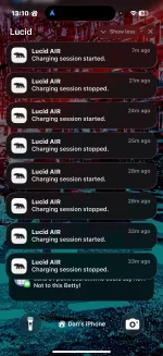

I'm on version 2.8.0 and I'm having the same issue. Multiple start/stop cycles charging. I did not have this issue previously. I am using a Tesla Gen 3 Level 2 wall charger set at 48A on a 60A line. I'm using the Lectron 80A adapter - Since Lucid doesn't offer anything here and using a 240V line isn't possible in my garage.
When the app informs charging stopped, I cannot "re-initiate" charging. I have to wait some period of time before it will start again. It's taken me nearly 3 hours to limp my way from 30% to 40% SOC. Something seems off. Initial thought was because of the high ambient heat in the garage, yet the wall charger is not signaling this at all. It will indicate if so, and previous high-temp charging sessions worked just fine. Not sure what to do but this may be a service call.

I informed on the latest 2.8.0 build and that I noticed there is a "Charge Limit" function now, which I do see in the release notes was added in this version. It was set at the default 80A for the vehicle. Of course this is a "limit" so didn't think this was a problem but I set it to match my wall unit to 48A. My hunch is there could be a software issue with this new charging update. This behavior is very recent for me - Only seemed to notice it after 2.8.0. Will see what Mobile Service has to say.

Unfortunately, no change. I'm able to charge in 15-20 minute sessions before the "Charging Stopped" appears. Waiting for a callback to confirm the mobile service appointment.
I've reached out to Lectron on the 80A adapter I'm using with the Tesla wall unit. Sounds like the vehicle is sensing temperature and stopping charging before the wall unit, which makes sense. I see it stop when the wall unit is green lights and happily flowing current. This new 2.8.0 "charge limit" function came just in time. I've cut from 48A to 40A. which is what the Lectron rep suggested as well. Will give that a go next time I need a charge. It just seems odd that I can pull up to a DCFC in 110 degree heat and charge more than 48A but can't on AC. I'm guessing the heat/cooling is different between AC and DC?
Adjusting charge limit in the car to 40A did the trick. Completed charging, no issue. Glad we now have this feature.
