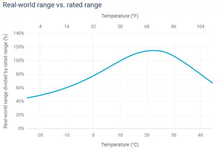

Isn't it super cold? See this graph

I love this. It explains why I get so much more range when I drive to LA (always in the morning) and get much less range going back to PA (always in the afternoon.). Thanks
Also there's generally a north wind along California for most of the year. Cyclists have long known to ride the coast from north to south to have a consistent tailwind rather than headwind.
This graph is very interesting and it appears to be in rough agreement with what we believe we experienced during our recent 4000 mile trip to Denver and back over the Thanksgiving period. What is the basis for this graph? What data did you rely on to produce it. Has it been vetted against other sources. I am asking simply I would like to use it in the future but have learned the hard way not to trust unvetted data. Thank you in advance.
On our one 250mile trip in cold weather, 26 degrees, we got only 50 percent by my very rough calculations.
Got it from this

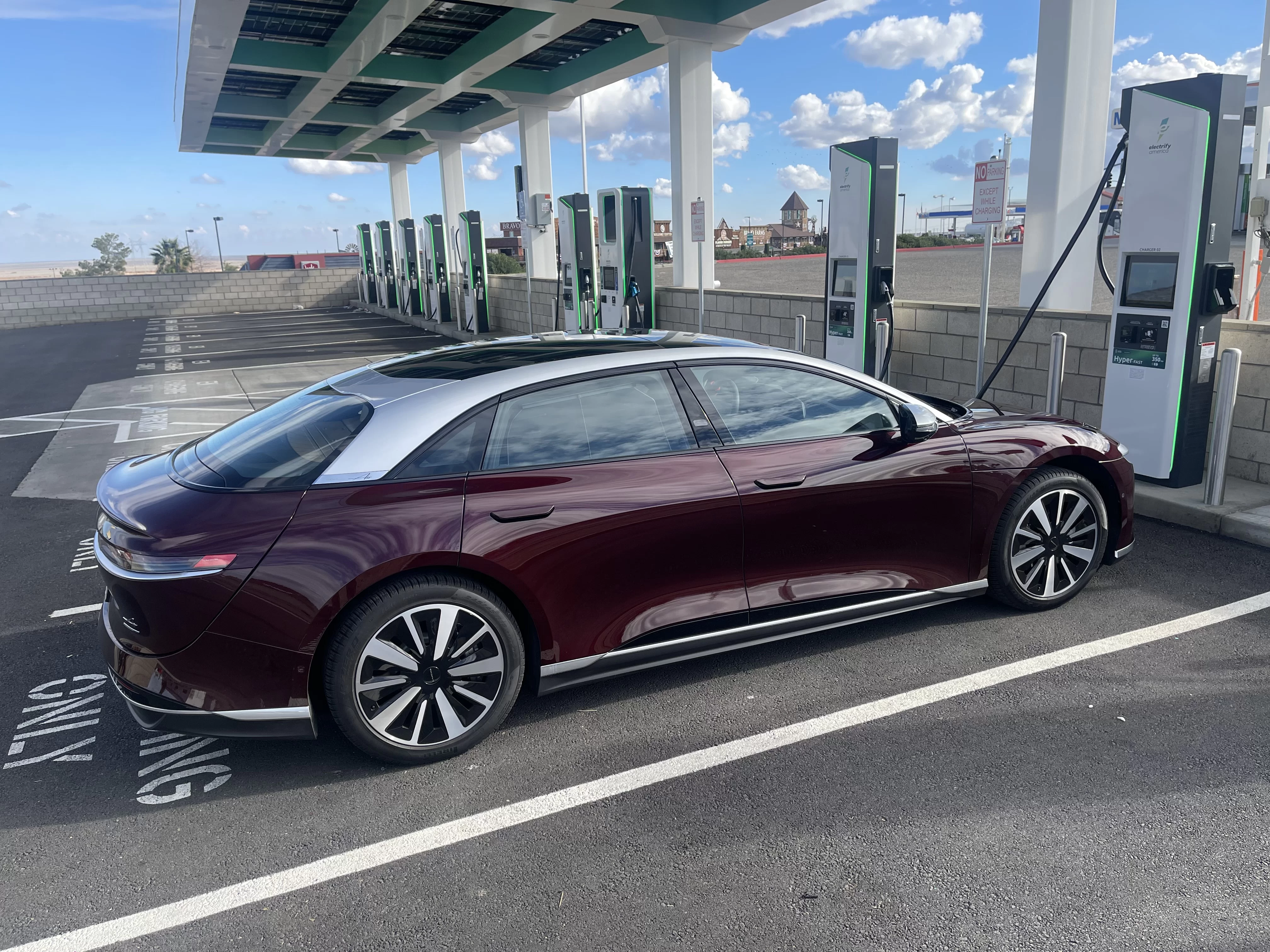

I drove from Sierra Madre near Pasadena in LA area to Fremont, CA today on I 5 and 99. I checked the EA chargers at Walmart Santa Clarita. Walmart Santa Clarita EA has 5 new stations starting today. All 350KW. Also at Bakersfield.

I highly recommend 99 instead of I 5. Also 101 from the other side. So many charger locations. So many food choices. Mostly 2 lanes 70mph speed limit. Even without EV 99 is an used gem between SF and LA.
Thanks for the intelligence and advice. Will take you up on that.
