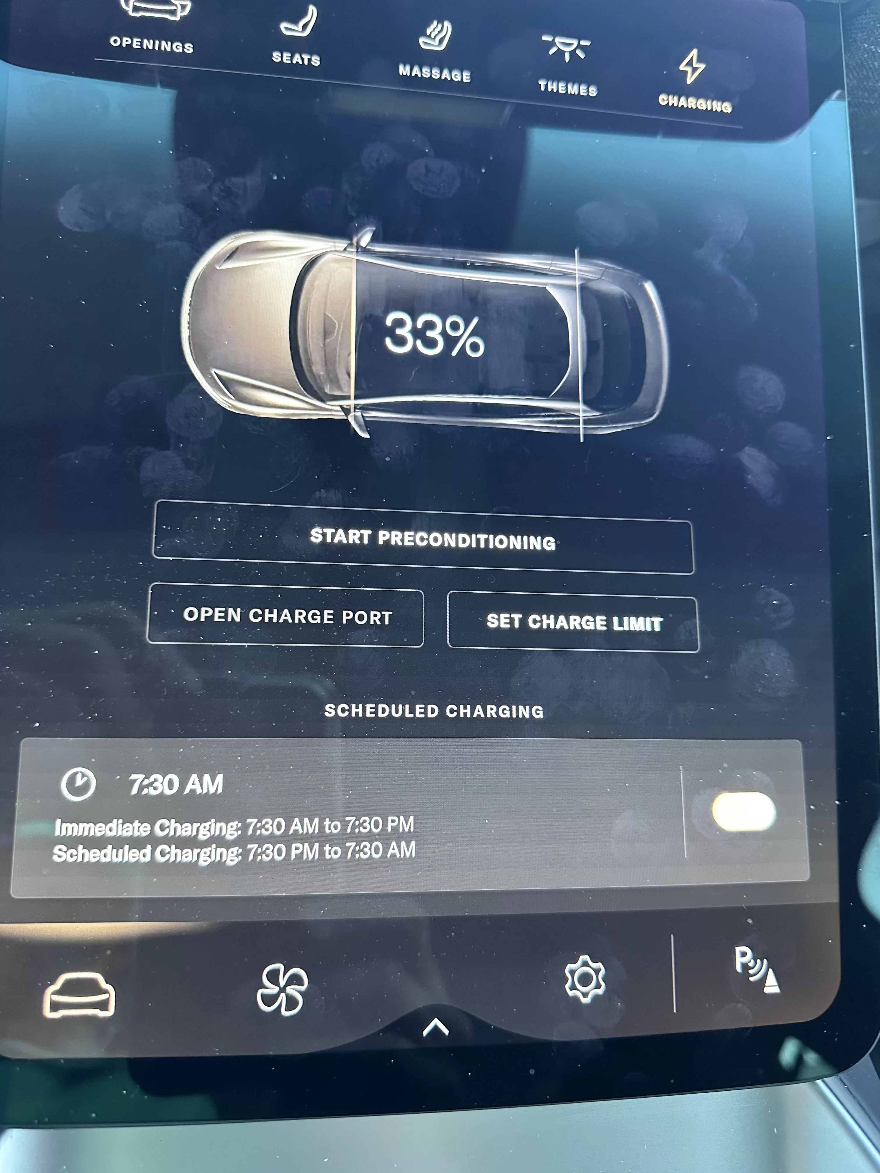

I feel like I'm being stupid with this scheduled charging. Here is a picture of my charging screen. If I read this right, charging is 'scheduled' to start at 7:30pm. But, it also says immediate charging is between 7:30 am and 7:30 pm. So, if I plug in my charger at 4 pm, hoping charging starts at 7:30 pm, it starts charging immediately. What am I doing wrong?

You are assuming the instructions are in English. They mean the opposite of what you'd first expect. "Scheduled charging" means a time period where charging won't happen.

As Deane said, Lucid did no one any favors with their wording. You set the time you want it to start charging (7:30 pm?). It will charge for 12 hours from that time (7:30 pm to 7:30 am). This is listed as immediate charging. The other 12 hours is listed and scheduled charging, which (in Lucid speak) means it won't charge until the scheduled time.

I’m confused. Skywater’s pix shows the opposite, 7:30pm to 7:30am is shown as the scheduled charging period.

Lucid chose their labels poorly. 'Scheduled charging' is actually when it's not going to charge. I think they meant for it to mean 'if you plug in during this time period, it won't start charging until your schedule start time.' Hence the 'Immediate charging' label - the car will charge immediately when you plug it in during this period.

His pix shows that the car will immediately start to charge between 7:30 AM and 7:30 PM. He plugged in at 4:30 and it started charging as it should. I agree that it is confusing.

Correct. It was Neurios's comment, "It will charge for 12 hours from that time (7:30 pm to 7:30 am). This is listed as immediate charging." which didn't seem right to me. The time period from 7:30pm to 7:30am is listed in the pix as scheduled charging, not immediate charging. So to me, Lucid's description on the screen actually makes sense...at least to me.

I was not using his screen as my descriptor. It seemed as though @skywaterbanjo wanted to start his charging sessions at 7:30 pm (opposite what was displayed), so my ranges were based on that assumption. Sorry for making a confusing situation even murkier.

Hi, your issue is your start time there is set to 7:30AM, not 7:30PM - you can see that in the upper left of that box. If you set it to 7:30PM, then the “immediate charging” window will be 7:30PM-7:30AM, which is what you likely want, and between 7:30AM and 7:30PM it will be scheduled to start at 7:30PM.
