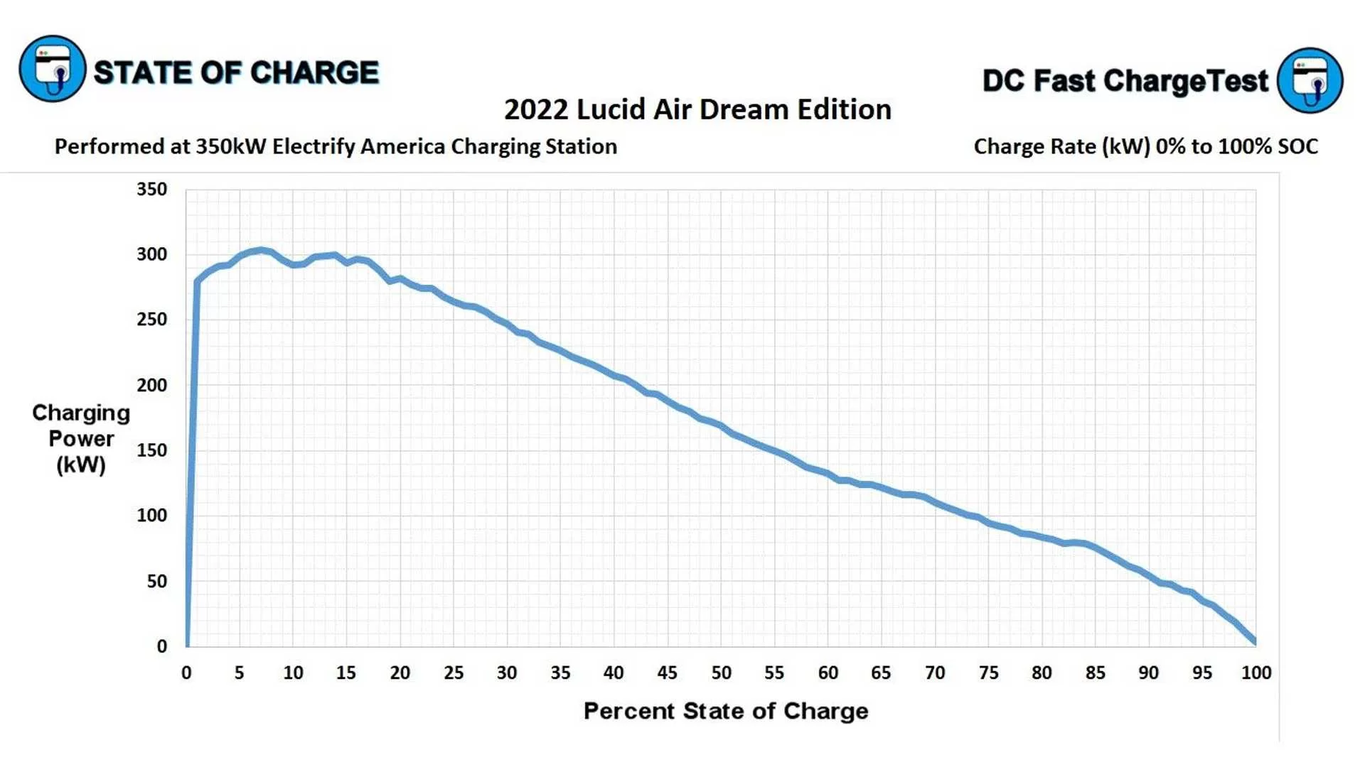

Charging curve reference.
Hope this help. @wa_lucid

Thanks for the reference. This matches what I know and expect.
I had around 30% SoC to start. I believe that is low enough on the charging curve to draw a lot more power than I was able to get, given 60 degrees temp.
The car started drawing about 87kw then dropped to 65kw or so once it crossed 60% or so SoC. Given another Lucid was just able to draw twice as much from the same station, I was left wondering if it is my car's electronics somehow.
