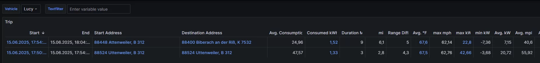

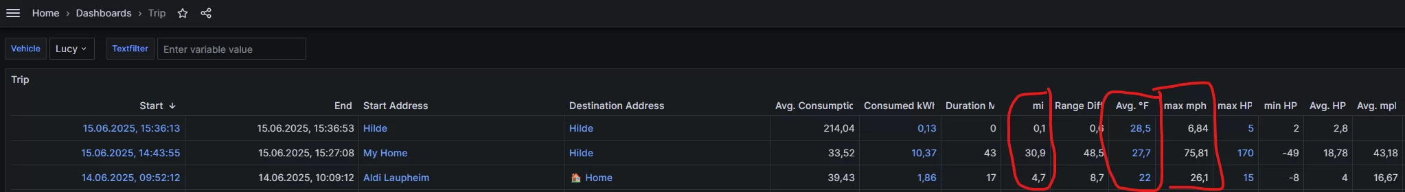

For anyone wondering, I'm running this on a Synology DS220 NAS and I'm not having any issues with performance. Everything seems to be working really well and smoothly. It'll pulling in all the data from above. The issue I'm seeing is that the data is in KM and C versus Miles and F. Not sure how to make that change if it's even possible. The settings have the option, but it doesn't seem to impact the datasets.
I tried to switch to miles and F and at least for the trip dashboard it works. But the temperature is still Celsius.
If you find any dashboards with bugs, let me know.

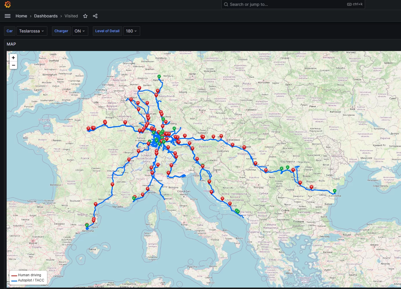

Let's talk about that after you have 100.000 miles driven and try to open die visited dashboard over 8 years.
But the most dashboards are quite fast even with slow hardware.

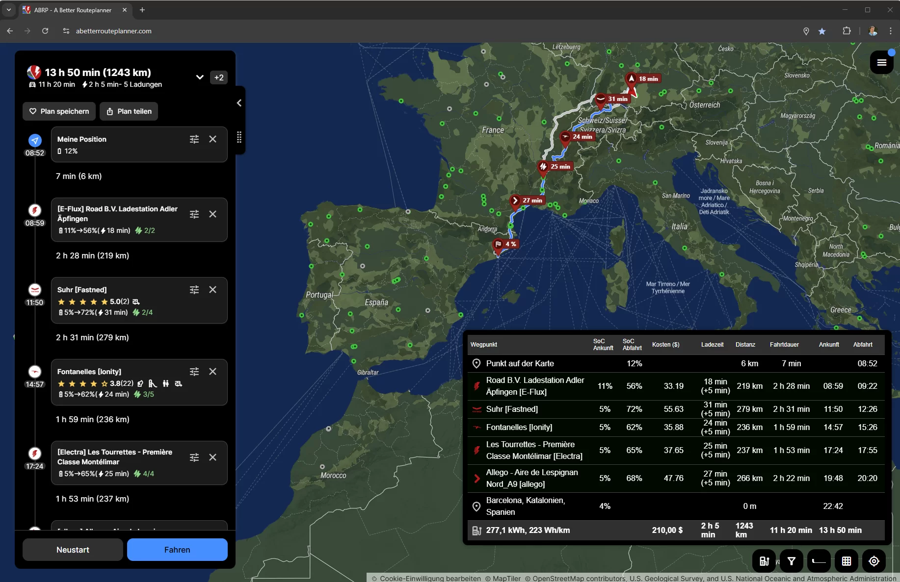

LucidLogger with Abetterrouteplanner
Are you guys using Abetterrouteplanner for trip planning?
LucidLogger / Teslalogger can connect with Abetterrouteplanner and calibrate your consumption (different tires / wheels / air pressure / etc).
It also sends current SOC / speed etc... so the planing is very accurate.
Here is a quick tutorial how to connect abetterrouteplanner to LucidLogger:
