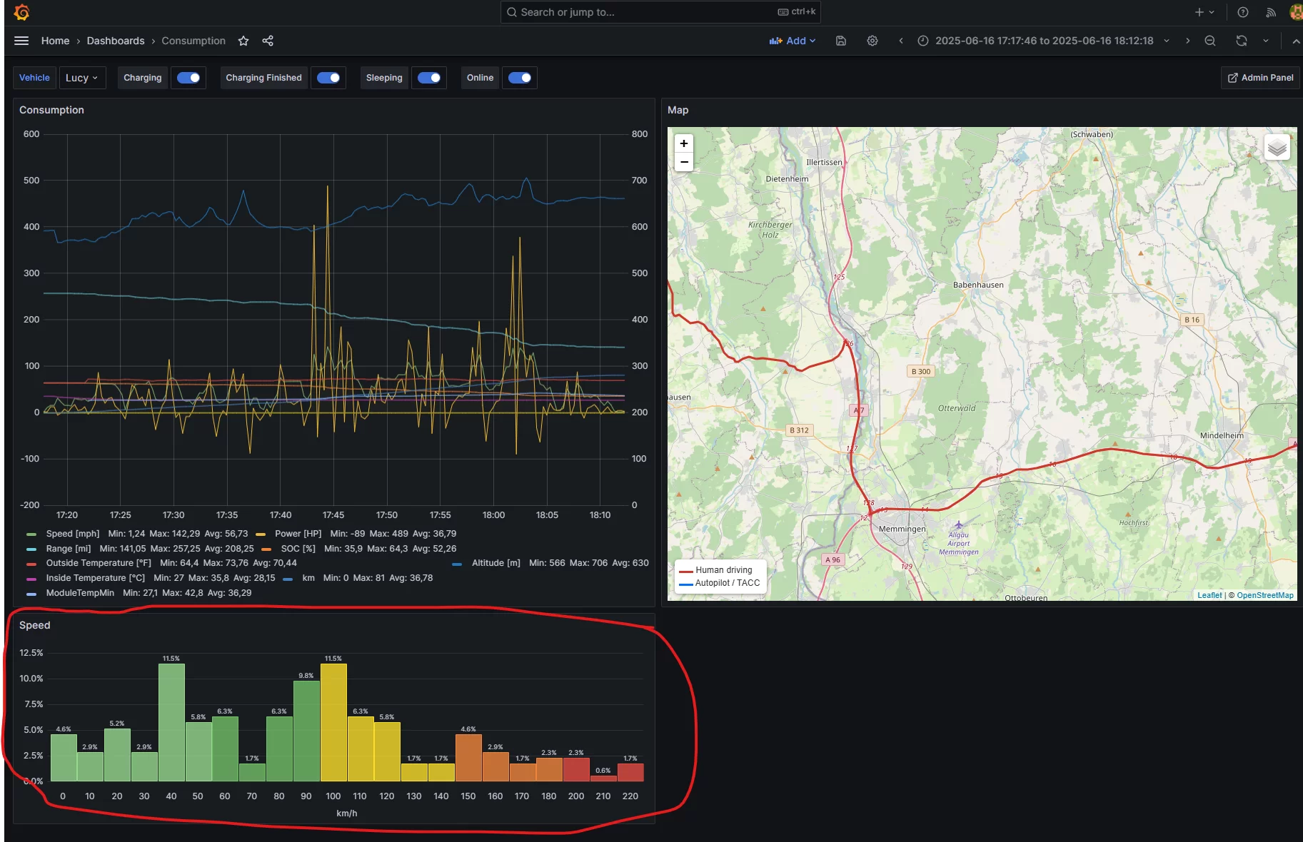

I found a chart using just kph. How should it divided? Every 5mph? I'm pretty sure you wouldn't see very often 220kph (138mph), so it would make sense to have more bars.
I would suggest blocks of 5mph up to 140mph. It would add 6 more bars, but I think it would make more sense.

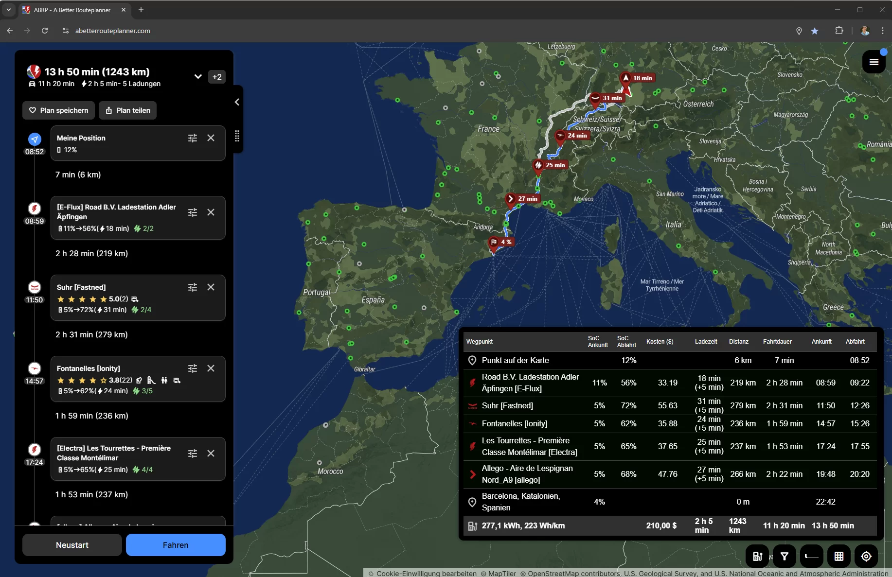

Are you guys using Abetterrouteplanner for trip planning?
LucidLogger / Teslalogger can connect with Abetterrouteplanner and calibrate your consumption (different tires / wheels / air pressure / etc).
It also sends current SOC / speed etc... so the planing is very accurate.
Here is a quick tutorial how to connect abetterrouteplanner to LucidLogger:

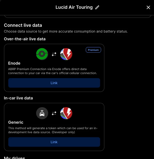

Can you add teslalogger without the premium subscription? I only see this in my account:
Yes, works perfect without premium subscription. Just use "Generic". Im in contact with Bo (Founder) from Abetterrouteplanner and he promised me, it will be free forever.

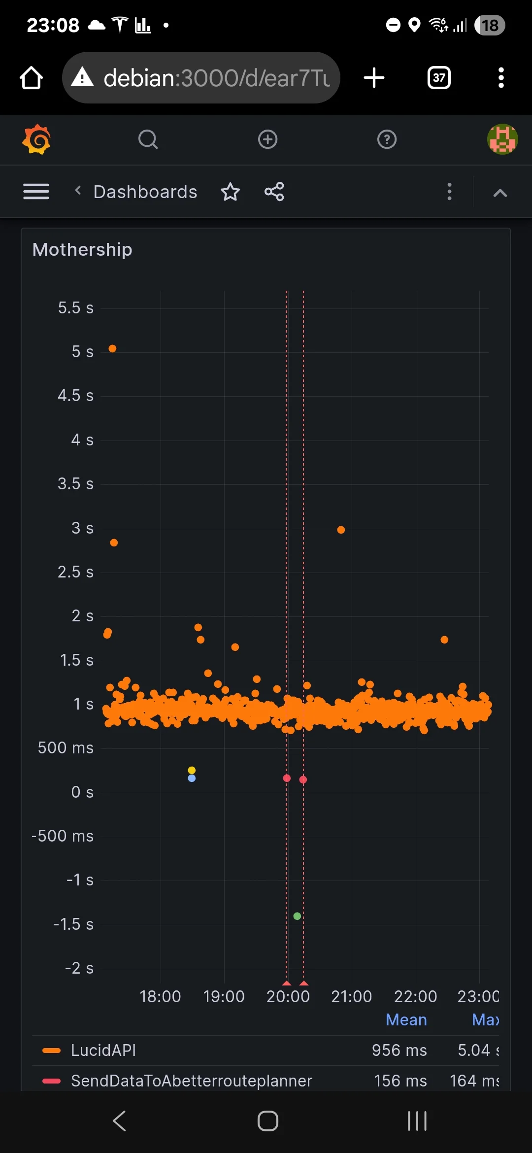

Odd. None of my data from today has been pulled by LucidLogger. The containers are all active. I just restarted the service via telsalogger interface. Any ideas
Anything auspicious in logfile?
And check mothership dashboard if lucid api has been polled.
No trips for today for me, "No data" in the mothership graph.
I think I figured it out. I put a sleep time on the app and I messed up the container TZ setting. I had to update it in the YAML file correctly to the right TZ. Now all my data is skewed, but I believe new data pulls will happen properly because it'll see the proper time.
