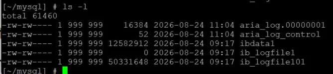

ok. I did as instructed and I have the same issue. Still errors with mysql and then with the JSON error with the My tesla / my lucid button.
attaching the log from the ip:8888/admin page
converted to pdf.
also added the files that are in the mysql folder
