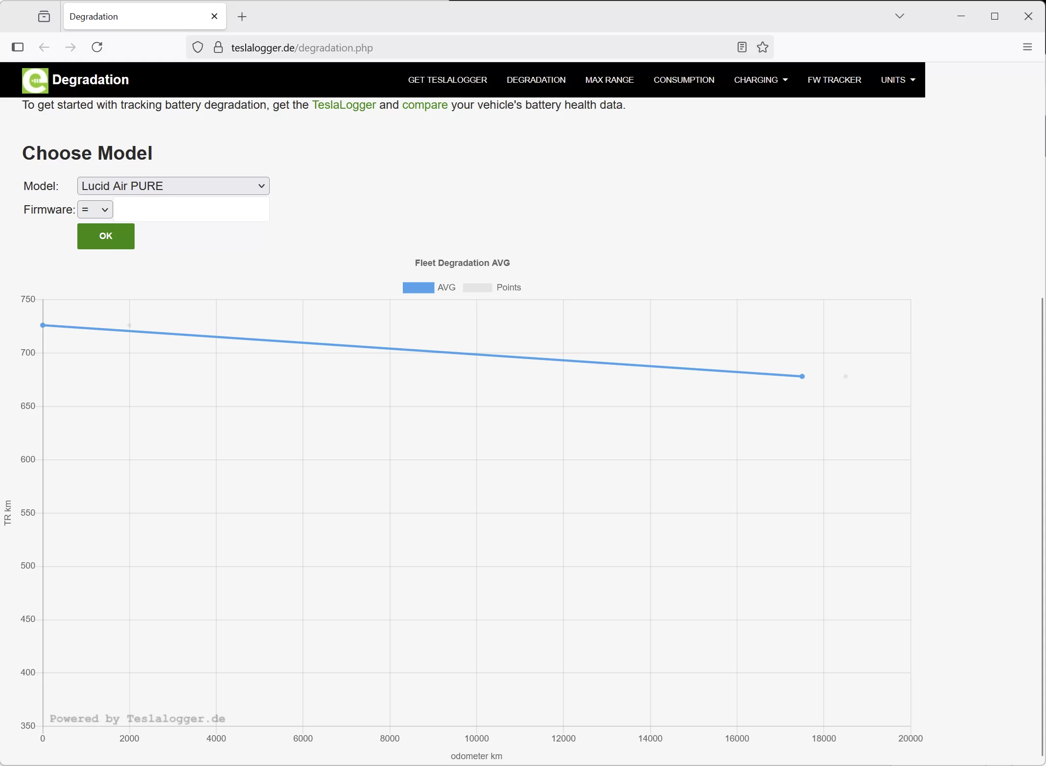

This is very cool indeed. I set this up locally, and to my pleasant surprise, the estimated range / degradation info is sent to Teslalogger if you turn it on, and you can compare your car with the rest of the fleet at https://teslalogger.de/degradation.php. The dropdown does not have Lucid models, but if you edit it in HTML, you'll start seeing data (see below, in km, with only 2 data points currently). I'm not sure what the exact name of the other models are in the API.
