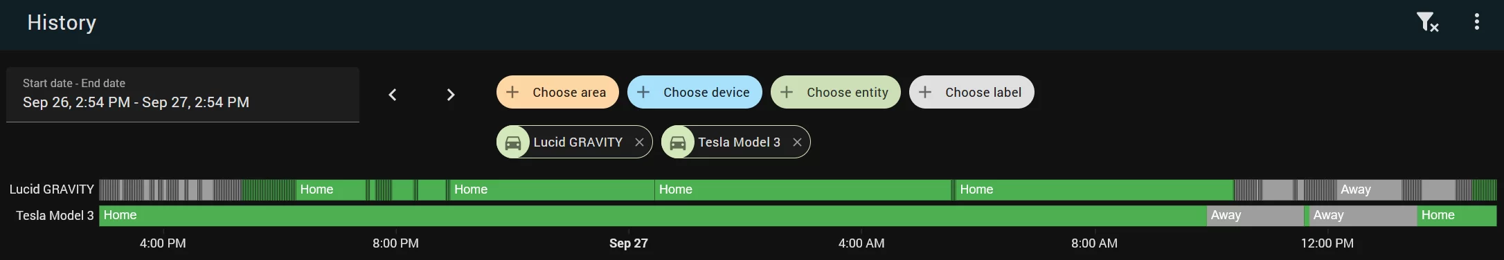

Mine does not seem to have a gap during that time period, but it does have gaps sometimes; it just depends on where the car is, if it has cell coverage, if the server is down, etc.Is it normal to have these kinds of gaps in the data?
My automations don't seem to be triggering as result, at least how they're currently written...

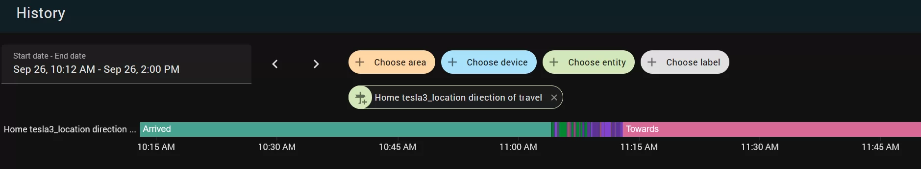

Here's what it looks like for my Tesla:

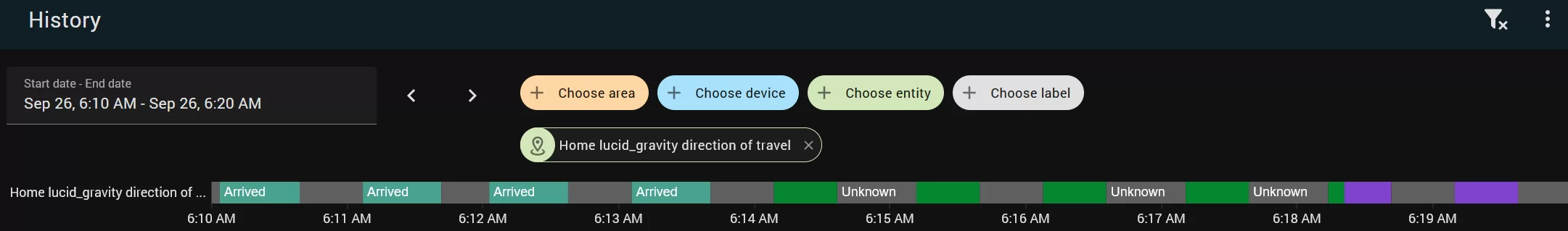

Trying something else, I installed TeslaLogger to see what the data looked like via MQTT. It also has gaps but not at the same times:Strange... the connectivity or the API is super spotty, even just sitting at home on my WiFi connection which unfortunately makes it unusable for location based automation.
Any troubleshooting suggestions?

The issue I see is that every minute all entities become unavailable and then refresh again, filling the log with cycles of "became unavailable" and then becoming available again.
Over the course of several hours there were a few periods when entities remained stable for 4 minutes at a time, for some reason, but the rest of the time it cycles every 1 minute.
I assume this is not normal, any advise how to troubleshoot?

Thanks for that. I think Lucid may have finally started rate limiting the API to some extent. I'll have to mess with it and see if I can figure out what the rate limit is so we stop hitting it.Error fetching Lucid account <my lucid account email> data: Error communicating with API: StatusCode.RESOURCE_EXHAUSTED:
