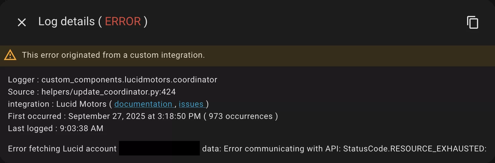

Just a quick note that I shut down LucidLogger this morning and I'm still getting the API exhaustion errors.
Just curious if others who are using the HA integration are seeing the same thing as me (and presumably @Electric123). You can check by going to Settings, System, Logs and see if you have an error like this:
If so, could you include your vehicle and vehicle software version?
Thanks
Thanks
Yeah, I'm seeing the same. There's clearly a bug, we need to stay within their new rate limits. We are more than happy to accept pull requests! I may take a look, but I'm technically on vacation in Wisconsin until next week. Maybe @segbrk gets a minute to take a look or...

Yes, same error in my log, Gravity on latest 3.3.2.

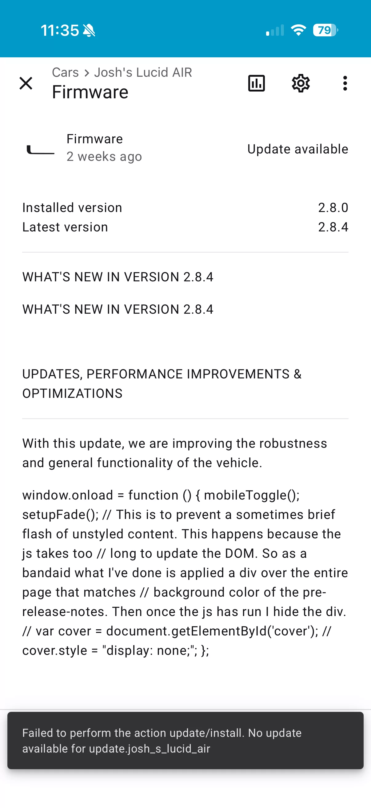

Getting this when i try to update the integration in HA. Anyone else?
That’s not updating the integration; that’s updating your Lucid Air’s firmware. :)
You can update (or redownload) from the HACS interface on the left side

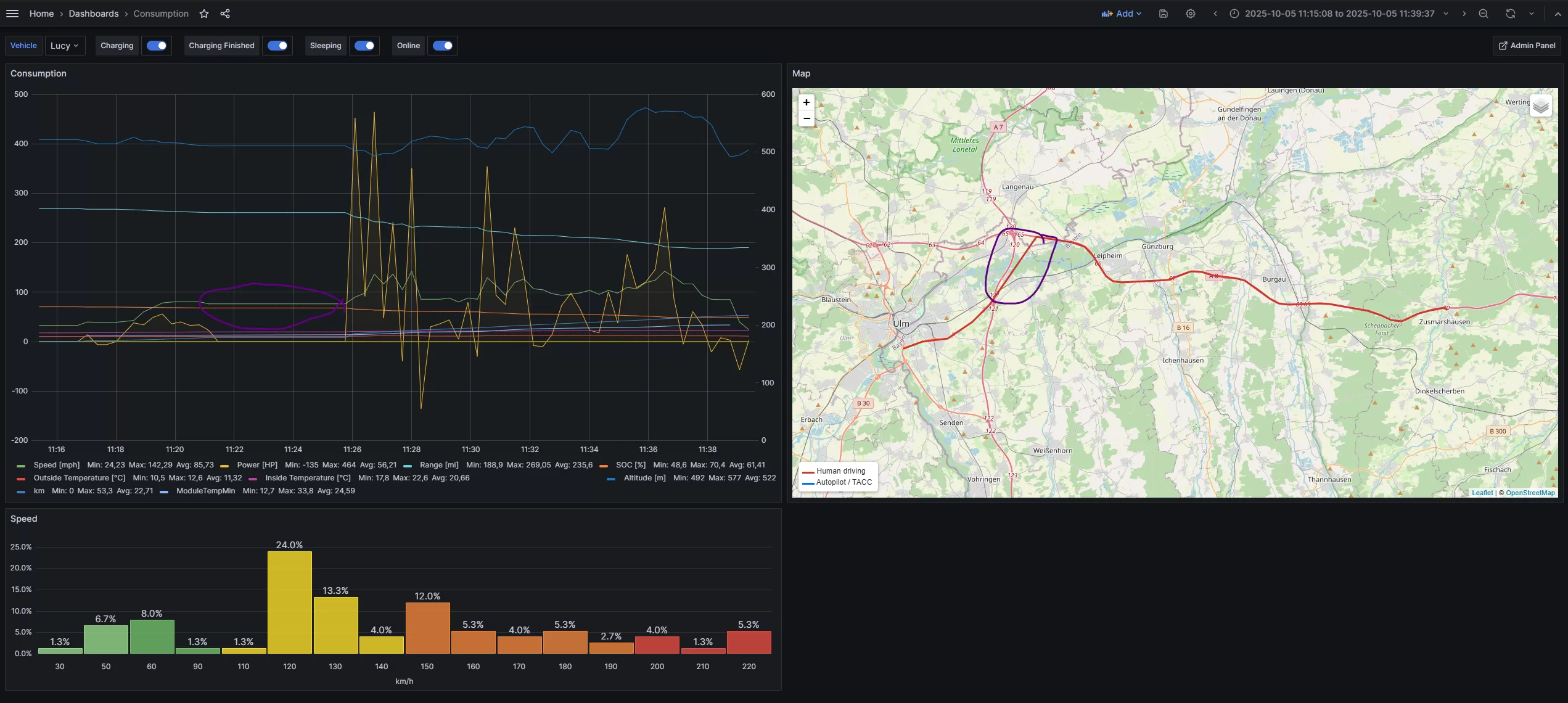

LucidLogger is heavily impacted also. Pretty sure I didn't drive through the landfill on the way to work.

It seems like the Europe server is affected es well.
So if Lucid has introduced a rate limit for polling their APIs and we want to run HA and LucidLogger / TeslaLogger side by side, LucidLogger needs to get the latest response from the server via the Home Assistant Plugin. I would suggest to make a HTTP Request on HA Plugin and get the latest response?
that's what I execute from LucidLogger right now:
FileName = "python3.13",
Arguments = @$"/etc/lucidapi/examples/teslalogger.py --username {username} --password {password} --region {region}",
Phew glad I'm not the only one experiencing problems. I updated my firewall and core switch a few weeks ago and my garage door integration stopped working. I'd assumed I bungled something to do with the HA firewall rules during the upgrade. Just sitting down to troubleshoot, it seems connectivity is super spotty when the vehicle is awake:
…or just poll less frequently?
