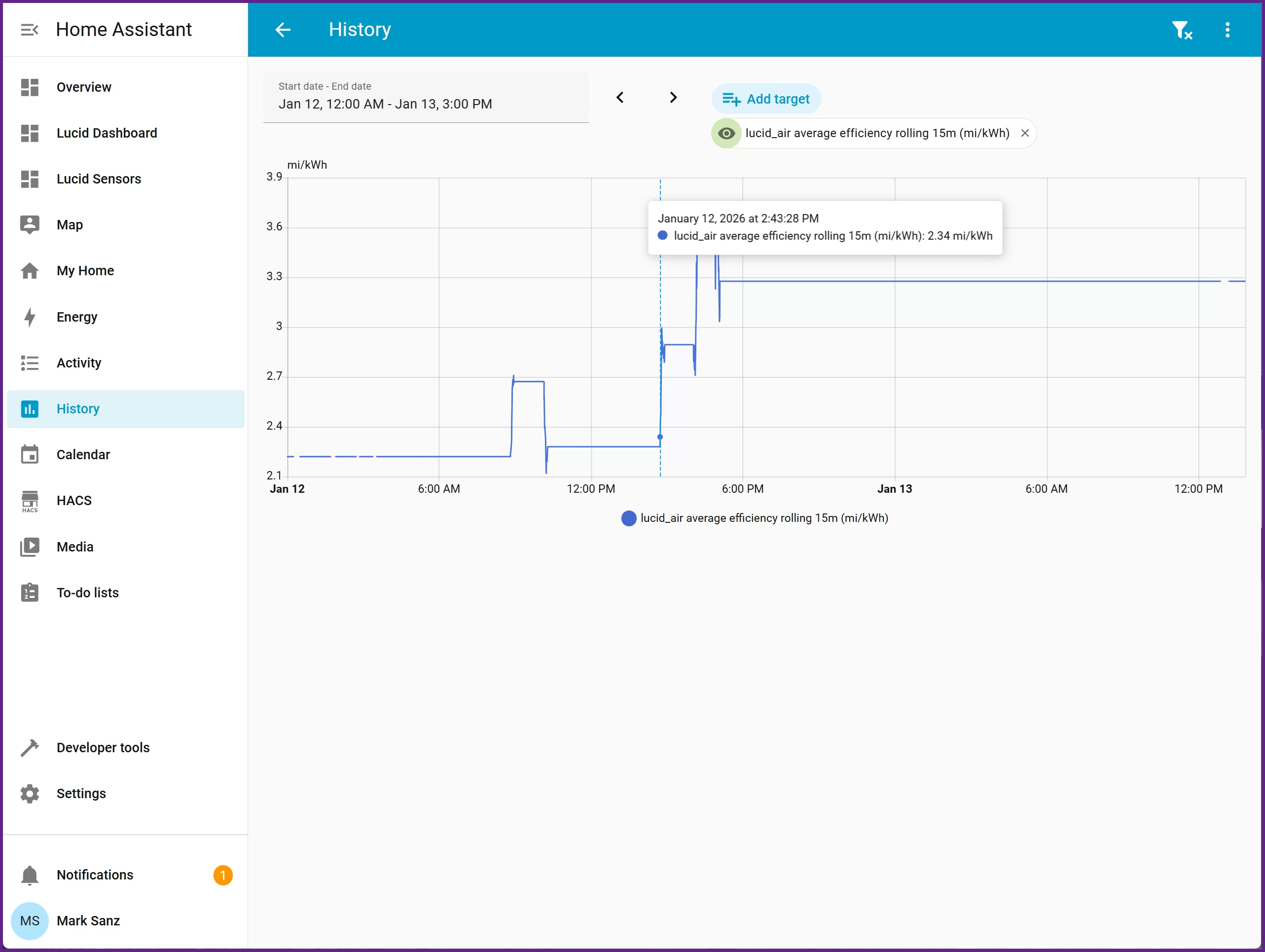

I am not sure where this is polling from but it is pretty accurate. 15min rolling average efficiency last 24 hours. haven't driven much in last 24 hours. This is 2022 AGT in Home Assistant. And no, i have never seen it displayed in the car itself in years. There was a brief time when I bought the car almost 4 years ago when it did but then Lucid took it away. The Trip number is pretty useless as is the remaining mileage in the car. Our 11 year old Prius does it better. @segbrk, where does this come from and is it accurate. you are the expert.
We're computing that in the Home Assistant integration. The car reports a (very accurate, like down to the centimeter) odometer, and similarly very accurate kWh remaining. We just track the difference over a rolling window, change in odometer / change in kWh. And no, I have no idea why the car doesn't just do this itself.

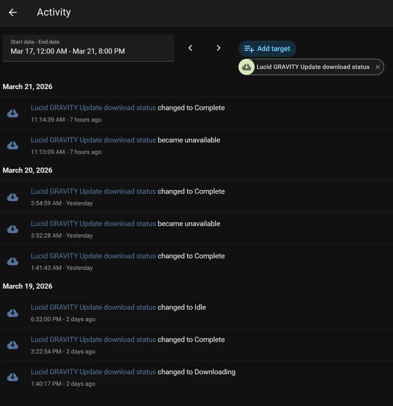

Question about alerts for Gravity downloads. I created an automation to alert me when the Gravity has a download and noticed that not only did I get one for the update a few days ago but a few more since then. Looking back in the logs I can see that the Gravity does a download from time to time that isn't related to an OTA update. I assume this is just something normal going on in the background but it'd be nice to be able to remove them as false positives for the alert if possible.
This is just a quick screenshot of the last couple days. I got the 3.5.1 update Thursday night, which lines up with the times on the 19th but also had downloads the last couple days. I notice they don't have the "changed to Downloading" for the other ones so that's probably how I'll filter to see if I can capture just the OTAs but figured I'd ask to see what other Gravity owners are seeing.

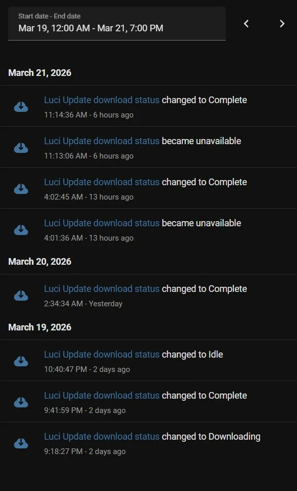

Mine looks identical.

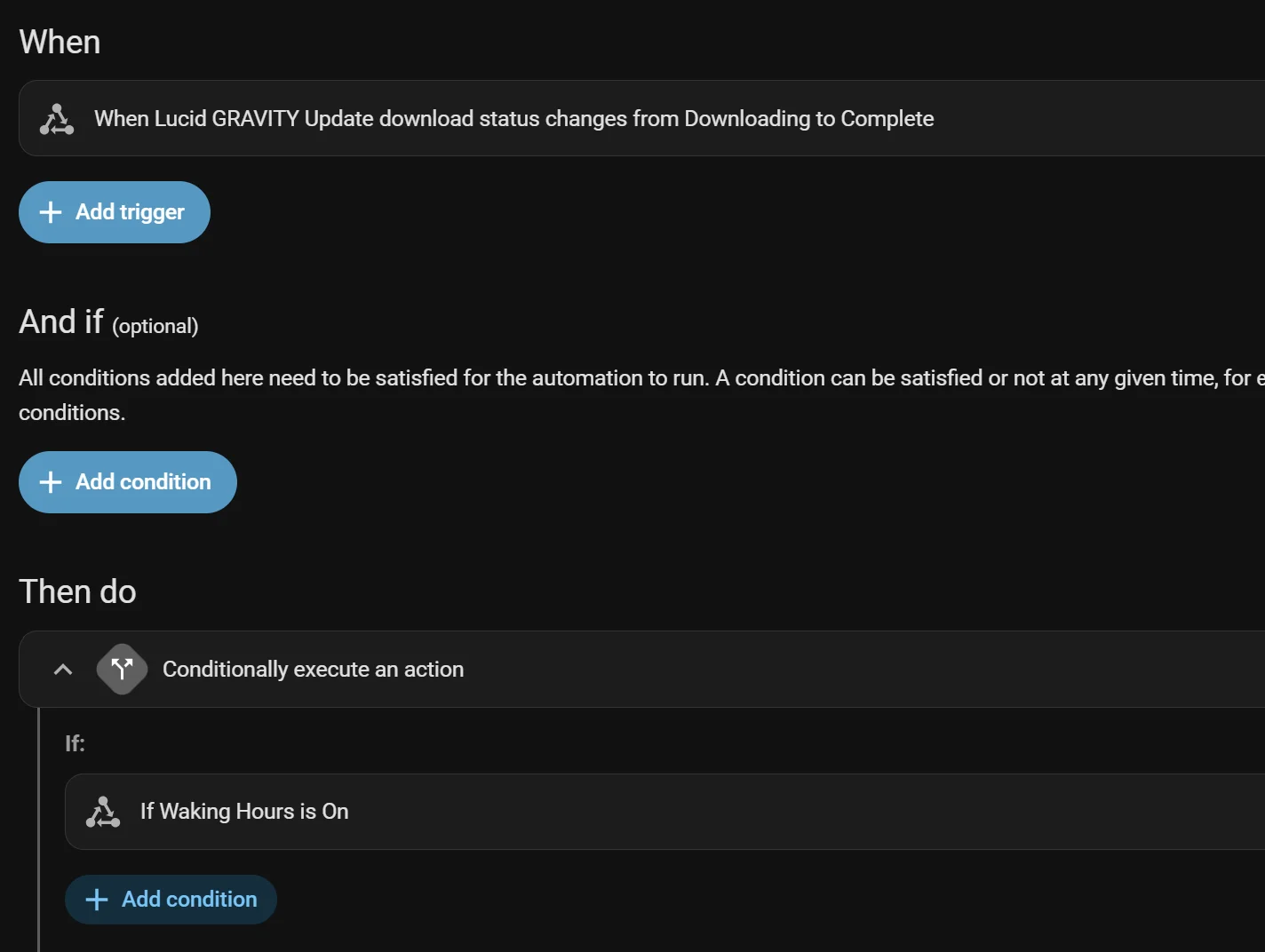

I hadn't thought about it, but my automation is set up to work properly for this:
