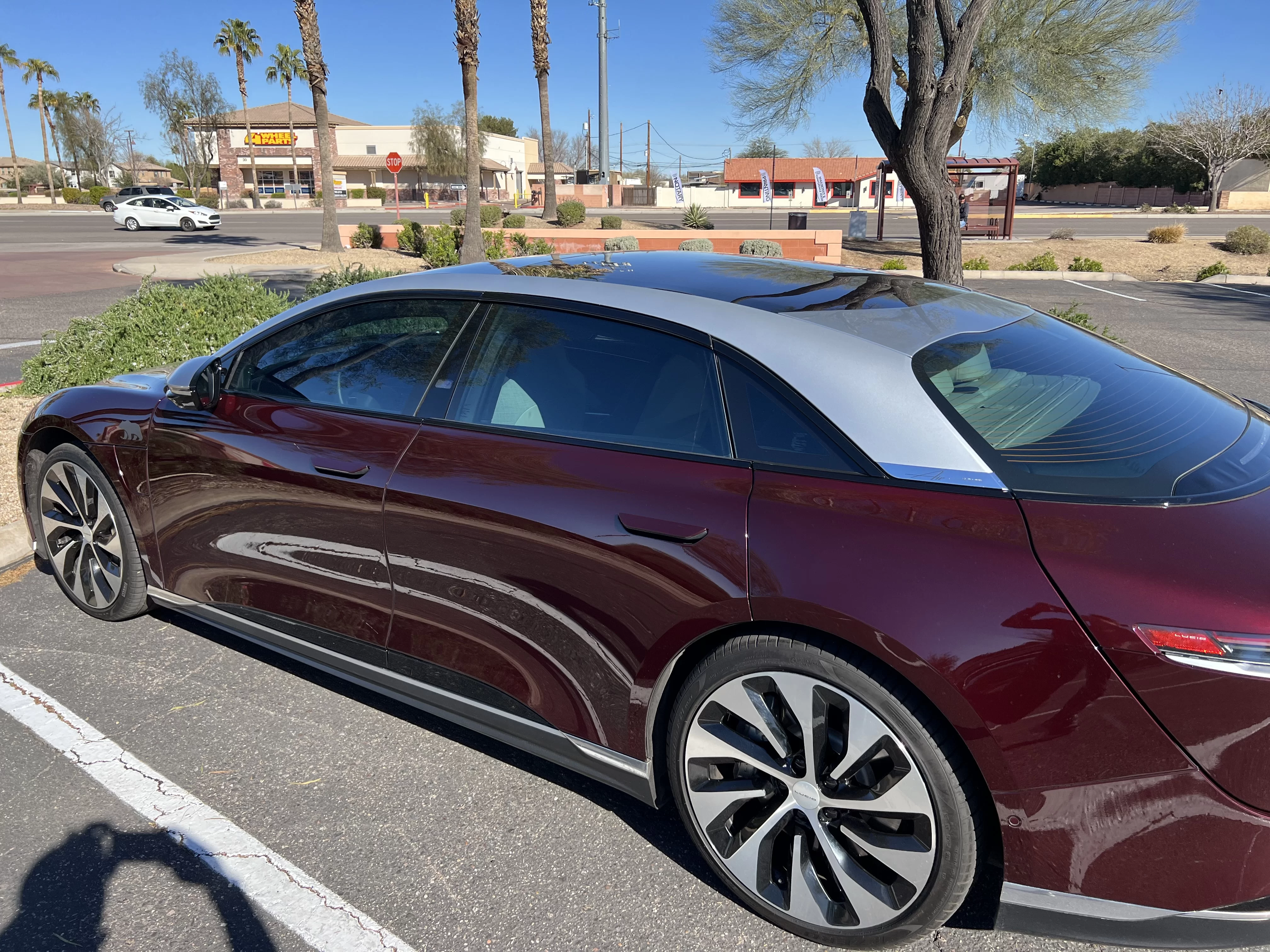

So Lucid has decided to change my HV battery in my car due to some test showing potential for failure. The battery was doing fine as far as I know and it’s being done as preventive maintenance. I handed my car in last week and am told it make take 1-2 weeks. I am glad that Lucid is being very upfront and just doing this out of warranty. They tell me they may replace the inverter, and wonderbox as well to keep everything same version. I asked if they used refurbished parts and they said they mostly do not. They gave me red lucid GT loaner with 14k miles on it. They told me it has speed reducers at 85 mph. I have not experienced a reduction in speed. Did your loaners reduce your speed past 85? Overall I am sad I don’t have my car, but glad that Lucid service is taking good care of me. In the end if I get a brand new battery I guess that’s winning. My car has 12k miles on it so this will be a reset I suppose. It does not reset the warranty tho so it’s the same longevity of the warranty I think 8 years /80k miles.
If you are curious how the new battery performs we can run tests once I get my car back. I am thinking I don’t get my car until near end of Feb that’s my guess.
It’s nice I got a loaner so life hasn’t changed too much. Altho I have no Alexa, or any of my apps purely relying on car play. With loaners do you used your Lucid login? Install apps like Alexa etc?
I got no clue but car play has been sufficient.
So Lucid has decided to change my battery in my car due to some test showing potential for failure. The battery was doing fine as far as I know and it’s being done as preventive maintenance. I handed my car in last week and am told it make take 1-2 weeks. I am glad that Lucid is being very upfront and just doing this out of warranty. They tell me they may replace the inverter, and wonderbox as well to keep everything same version. I asked if they used refurbished parts and they said they mostly do not. They gave me red lucid GT loaner with 14k miles on it. They told me it has speed reducers at 85 mph. I have not experienced a reduction in speed. Did your loaners reduce your speed past 85? Overall I am sad I don’t have my car, but glad that Lucid service is taking good care of me. In the end if I get a brand new battery I guess that’s winning. My car has 12k miles on it so this will be a reset I suppose. It does not reset the warranty tho so it’s the same longevity of the warranty I think 8 years /80k miles.
I got no clue but car play has been sufficient. View attachment 18310
I wouldn’t log in to anything personal on a loaner. Speed limiter should be at 88mph, sometimes they aren’t set.
