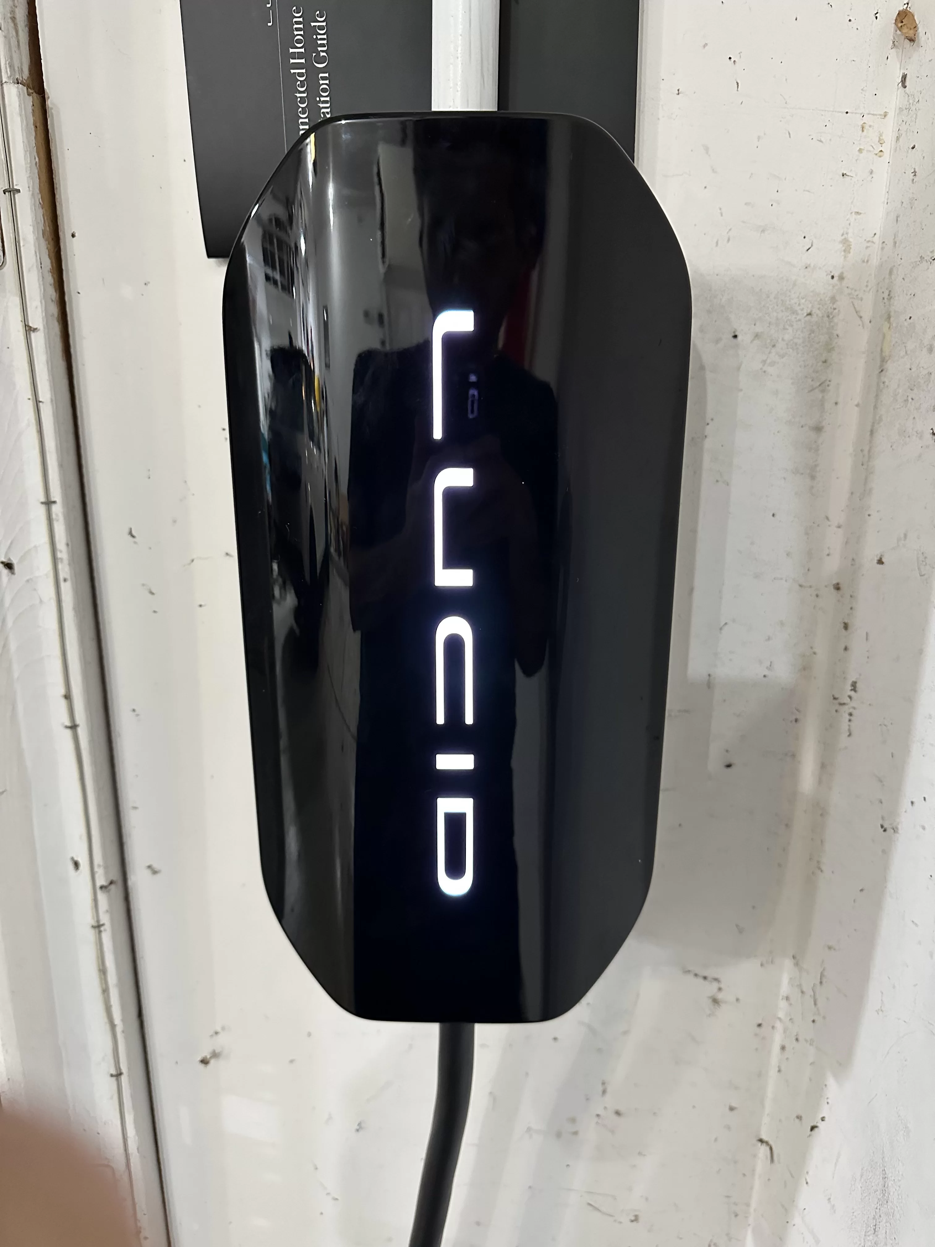

After 3 days, and 4 trips to the hardware store, it is alive!

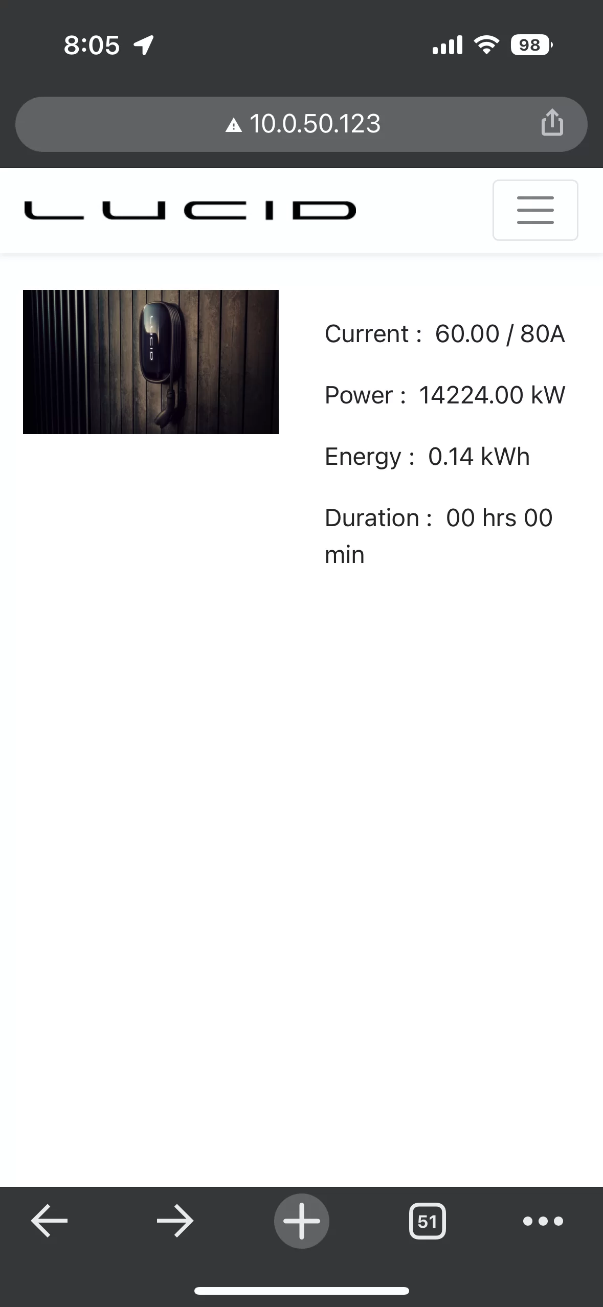

  • It has a rudimentary web server. It provides the current & power.
  • Is there an app to schedule charging etc? I searched the app store and the normal Lucid app, but did not find anything charging related.
  • My old Tesla charger was charging at 13kW. I was hoping it was related to the adapter. However, the car is still charging at 13 kW. The charger web server states the Current is 60/80A. I will reach out to support for more discussion.
