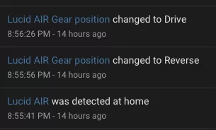

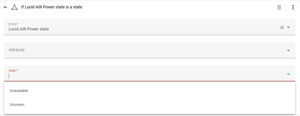

This has been a common problem. Occasionally the API will error or fail to respond, which shows in Home Assistant as e.g. "Lucid Air XYZ has become unavailable." The location changes from Home to ???, then back when the API starts responding. One suggestion would be to add a condition to your automation, "If Lucid Air Power state is Drive" to make sure your car is actually driving and not just popping around in its sleep.I have an automation set up with ratgdo so that the garage door will open when my car enters my Home zone. Last night at 3AM, it got triggered even though my car was in the garage (already Home) all night. This has happened multiple times. I looked at the HA Logbook and confirmed that my automation was triggered by the Lucid entering the Home zone.
The automation ran yesterday when I came home so HA knew that the car was in the Home zone. I have another automation to close the garage door when it exits the Home zone, and the Logbook does not have an event of the car leaving the Home zone last night.
I'm at a loss how this automation was triggered last night. Any ideas on how to debug this?
It's not aware of the options, you just have to type it in. Capital D.Thanks. I'm trying to add this condition but I'm not seeing "Drive" as an available state. I only have "Unavailable" or "Unknown" (see below).

I think your "drive" and "reverse" just need to be title-case, "Drive" and "Reverse" - pretty sure it is case sensitive. Also, if you go to your automation and click TRACES, you can step through exactly what happened when it was last triggered to see why conditions are failing.Anyone having issues getting things like the Garage Door to trigger with HA. I've messed around with this so much but still can't seem to get it to trigger
