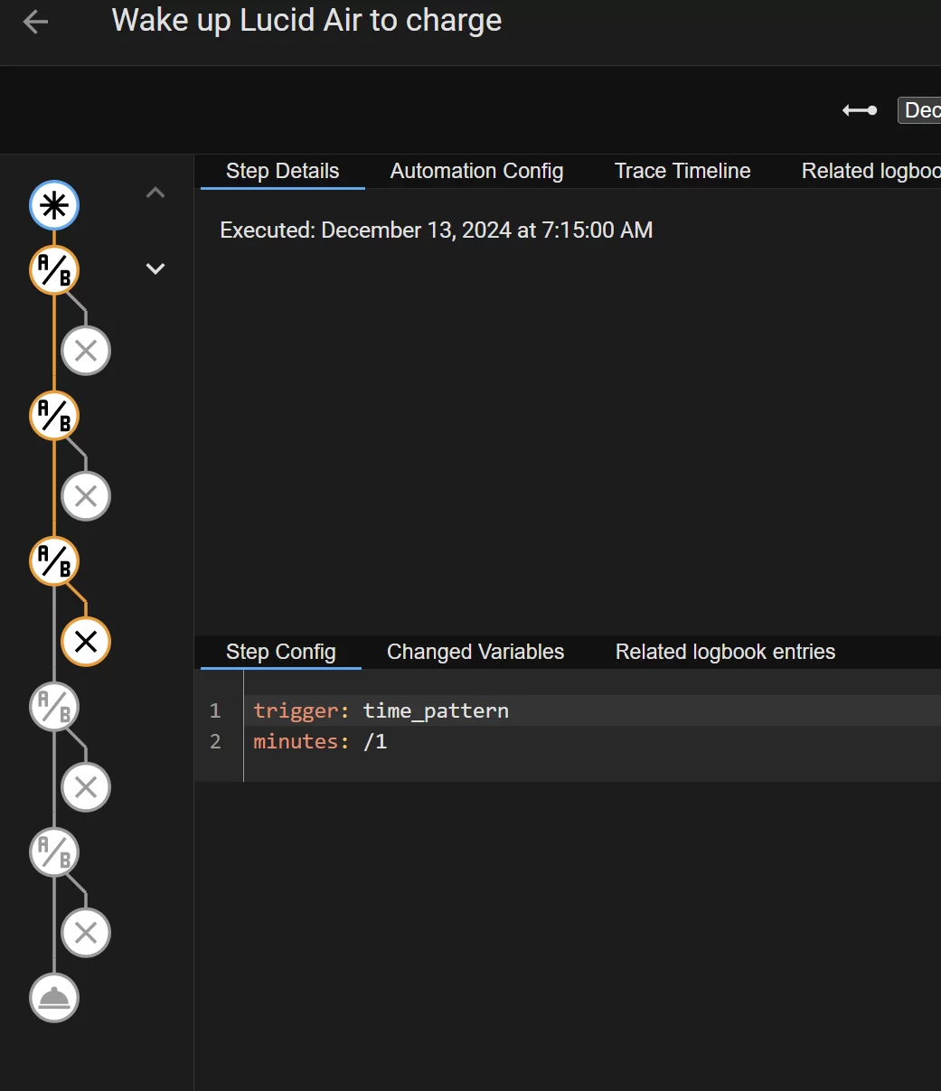

Someone who knows more than I may correct this, but I believe the automation triggered because remaining_battery_percent changed. Take a look at the automation's decision tree on the left to see its progress through your automation. It should have bailed out upon deciding that the new remaining_battery_percent was not below 60.
The trace is insufficient for understanding the automation. It looks like you are trying to poll SOC every minute. Not sure that makes sense. Post the yaml of the automation.

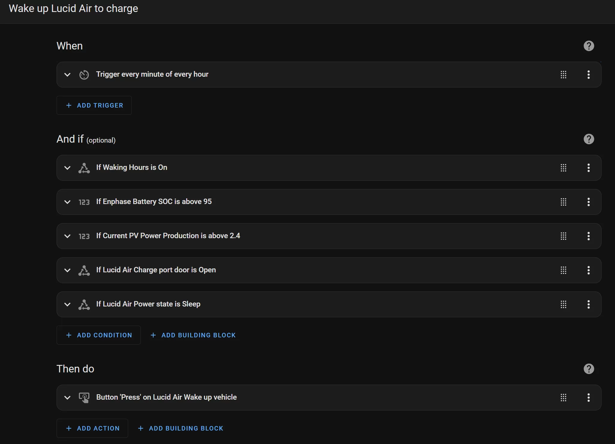

I charge our EVs when possible using excess solar PV power. This comes and goes with sun/clouds/oven/air conditioning etc coming on and off. So available charging power is often interrupted by dropping to zero for an hour or more. When this happens, the car goes to sleep with the charging cable plugged in, and does not wake up again. It's the exact same problem the car has with externally-scheduled charging. My automation checks periodically for this condition, and wakes the car so it can begin charging again. It only bothers Lucid's cloud when it's very likely that the car should be charging.
Interesting. Why poll every 1 minute versus a longer period? Literally just curious.
I wanted to minimize the amount of time the Air spent asleep when it should have been charging. Before I added this automation, the car would stop charging and go to sleep several times per charging-afternoon, and I had to observe that manually and wake the car up via phone app.
I started with a five minute polling interval, but saw that my HA CPU usage was negligible. I'd had a fair amount of grief with both Enphase's and Lucid's charging software and decided WTH and switched to one minute.
