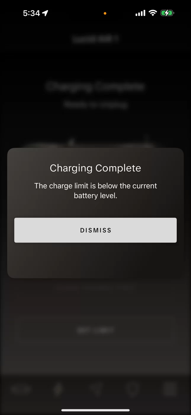

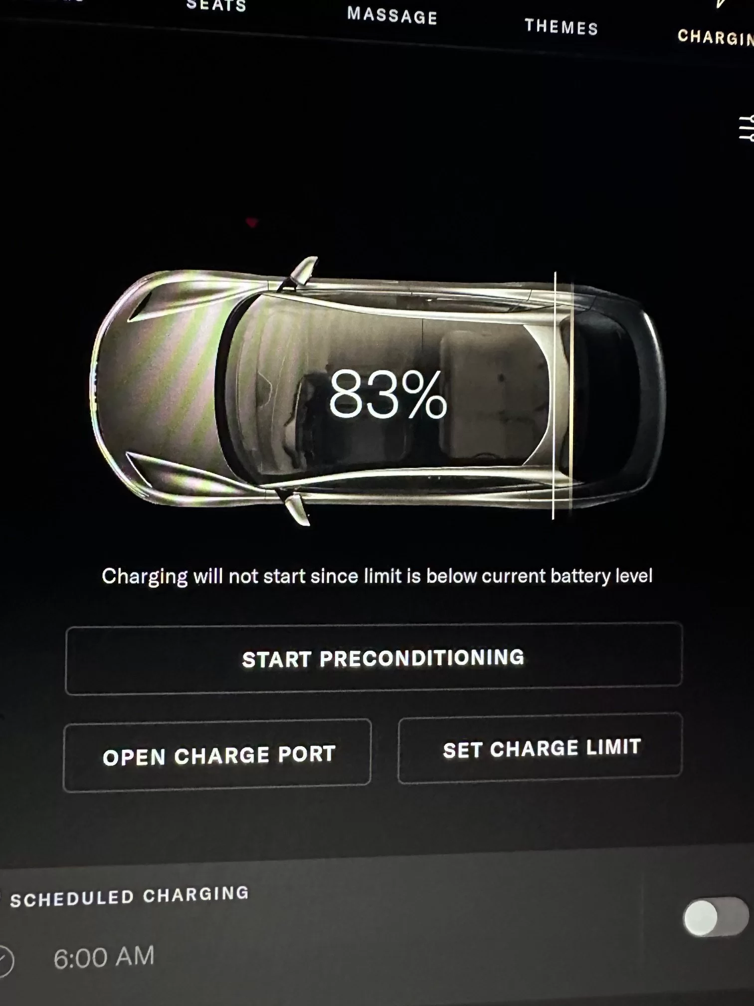

I'm at my wit's end. I'm convinced Electrify America is having problems in the southeast. Besides all the other problems we saw other drivers having, the ringer was when the Lyric driver who was charging next to us but off a different charge station had his charging session prematurely terminated at the same time we did.
On the other hand, the car is behaving bizarrely. Last night when we got home I set the charge limit to 80% and plugged into our garage plug. When I checked this morning, once again the car had charged beyond the set limit. You might remember this happened on the trip at a L2 ChargePoint charger at a hotel (that time to 85%).
I'm going to start another thread about this issue to see if anyone else has seen this problem. Both the Atlanta and Lucid Customer Service have told me they have never encountered this issue.
