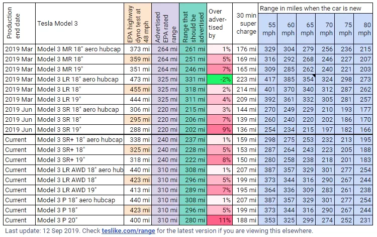

Range decreases exponentially with velocity, because the force of drag (which is the primary resistance to a vehicle moving at high speeds) is proportional to the square of velocity.
At low speeds, the main limitations are electrical needs to keep the vehicle running (heat, cooling, etc) and different kinds of energy loss due to friction (drivetrain, tires).
EPA highway efficiency is rated at 55mph, so manufacturers generally try to maximize efficiency at that speed.
Here's an old table comparing Tesla's various tire options for the Model 3, but also includes efficiency at various speeds: View attachment 7474
55mph is much better than 65mph, which is much better than 75mph. The sweet spot would probably be about 15-20mph; you could probably go at 15-20mph for almost double the EPA rated range, I'd bet! But if you did that you'd get murdered by other drivers. :)
If you're on a long road trip, I'd stick to 65-70; you won't be in the leftmost lane, and you'll occasionally be getting passed, but hey, you'll have the range you want (although I have to stop every few hours to pee/walk around anyway, so why not just coincide that with charging stops). Otherwise, enjoy going 75, 80, 85, whatever... just know that with each increase in velocity you lose range by the difference in that velocity squared (simplifying, of course, but all other things being equal).
This is also why the extremely low Cd of the Lucid Air is so important; it is by far the biggest impact on range.

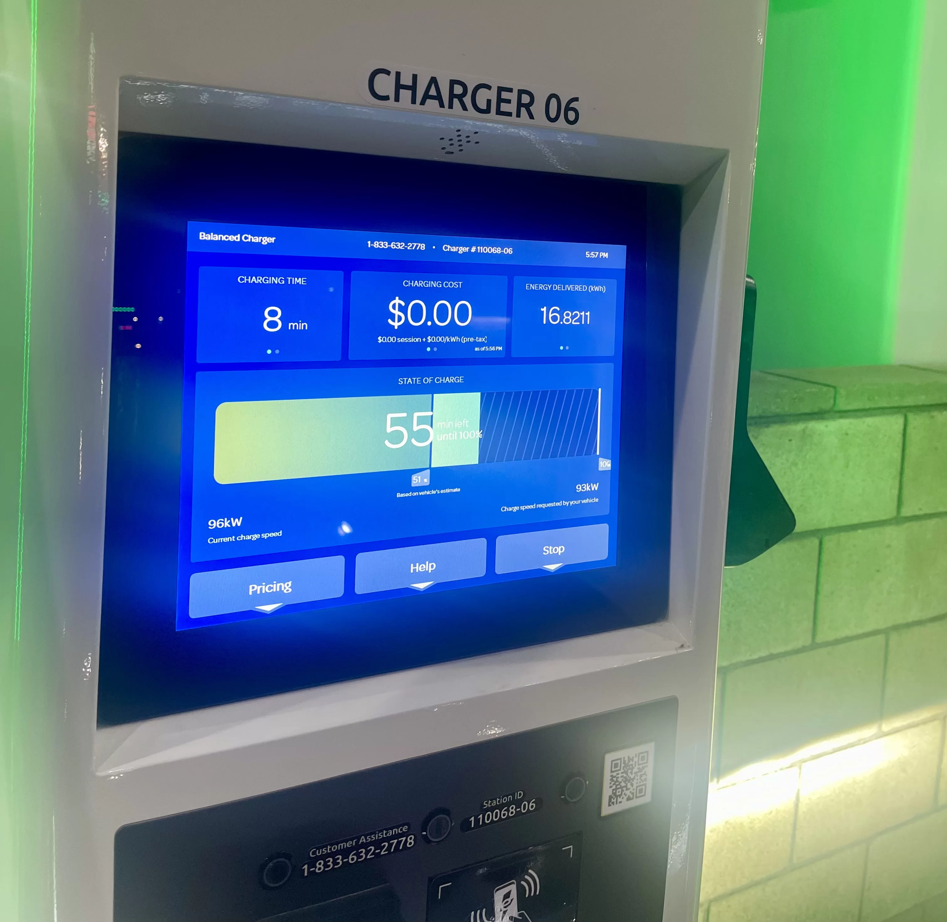

At the new 350kW EA station, I note that it now says (and maybe did before) whether the car or the station is limiting the charge. Am I correct in thinking, as in the picture, the station may want to deliver more than my Lucid is willing to take? At places where we have reports of low kW, is the car limiting that? Just curious.
Most of the time it is limited by the EA station, but the car can limit it if you didn’t precondition, battery temperature, or based on where you are on the charging curve.
Don't trust the "charge requested by vehicle". It's almost identical to what the charger is delivering and I think it was implemented by EA to use as an argument that it's your vehicle and not the charger that's the problem. When I had my e-Tron it charges 150Kw flat to 80%, I pulled into a charger at about 25% or so and was getting 19Kw and according to the EA charger it was "what my vehicle was requesting". II contacted them and said "wtf is going on" and they instantly blamed the car and said there was nothing they could do. In the meantime another charger became available so I unplug and move the car to the that charger and surprise, surprise I was getting 148Kw and my vehicle was requesting 148Kw.
Someone else pulled up to the charger I was having issues with and it was doing the same thing. giving 19Kw to the car and making out it was the car that was requesting that speed. In other words, don't believe anything that comes out of an EA reps mouth or what the charger is displaying.
