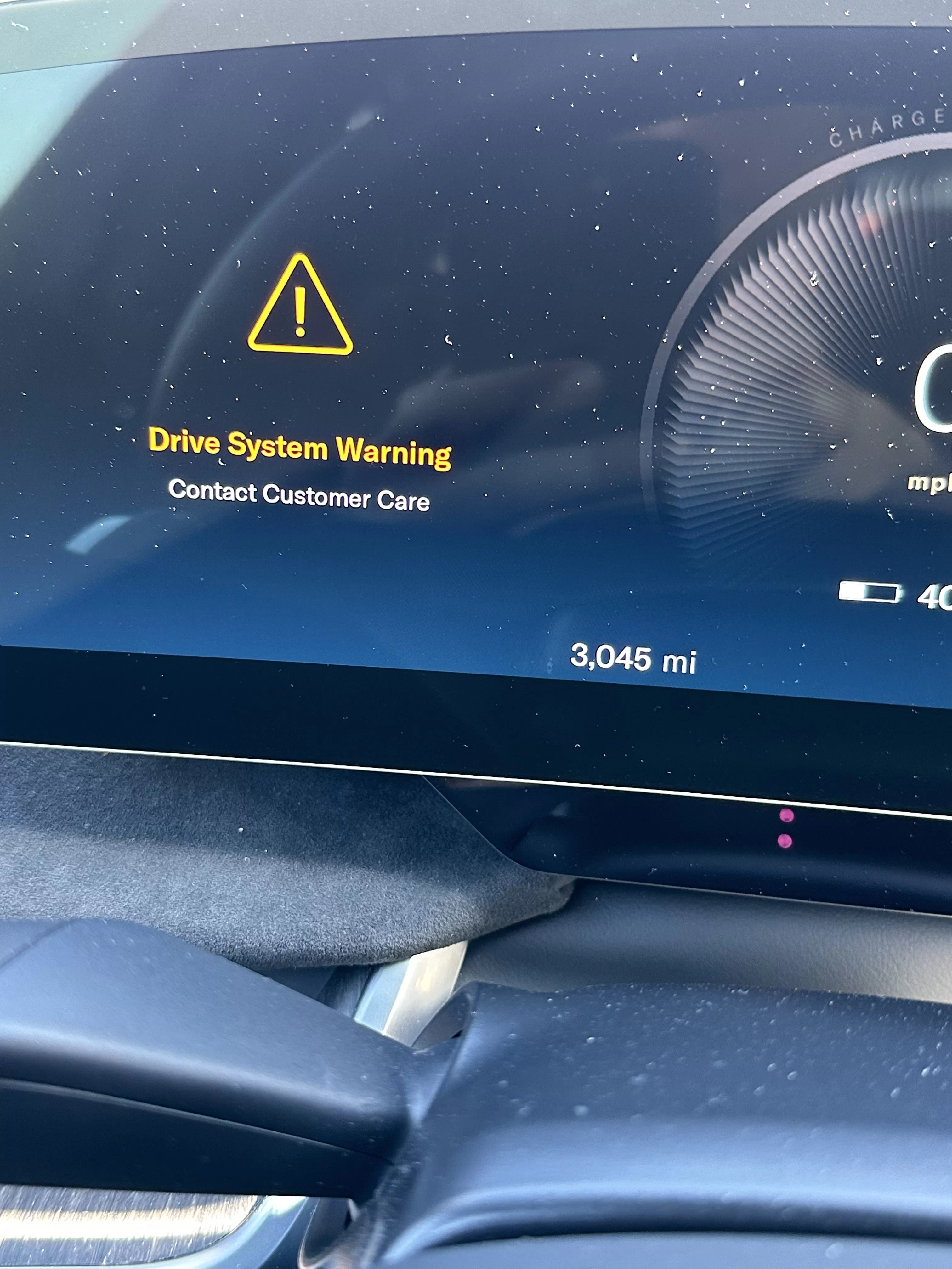

My message was in amber instead of red, and it said “Drive System Warning, Contact Contact Custmore Care.” I drove back the half mile back to my house after the warning appeared, and my car ended up getting transported on a flatbed back to Lucid Service in Costa Mesa. Less than a fortnight later I got a brand new main battery out of it.

I had a Drive System Warning pop up on my GT a few weeks back. Car seems to run completely normal. BTW, this is not the Drive System Fault warning light that I have seen discussed on this thread.
I called Lucid and they asked me to take it in ASAP. The car has been at the Costa Mesa service center for about 2 weeks. No one knows whats going on yet. They said they were discussing with the engineers back at HQ.
Anyone else have an idea of what's going on or have had similar issues?

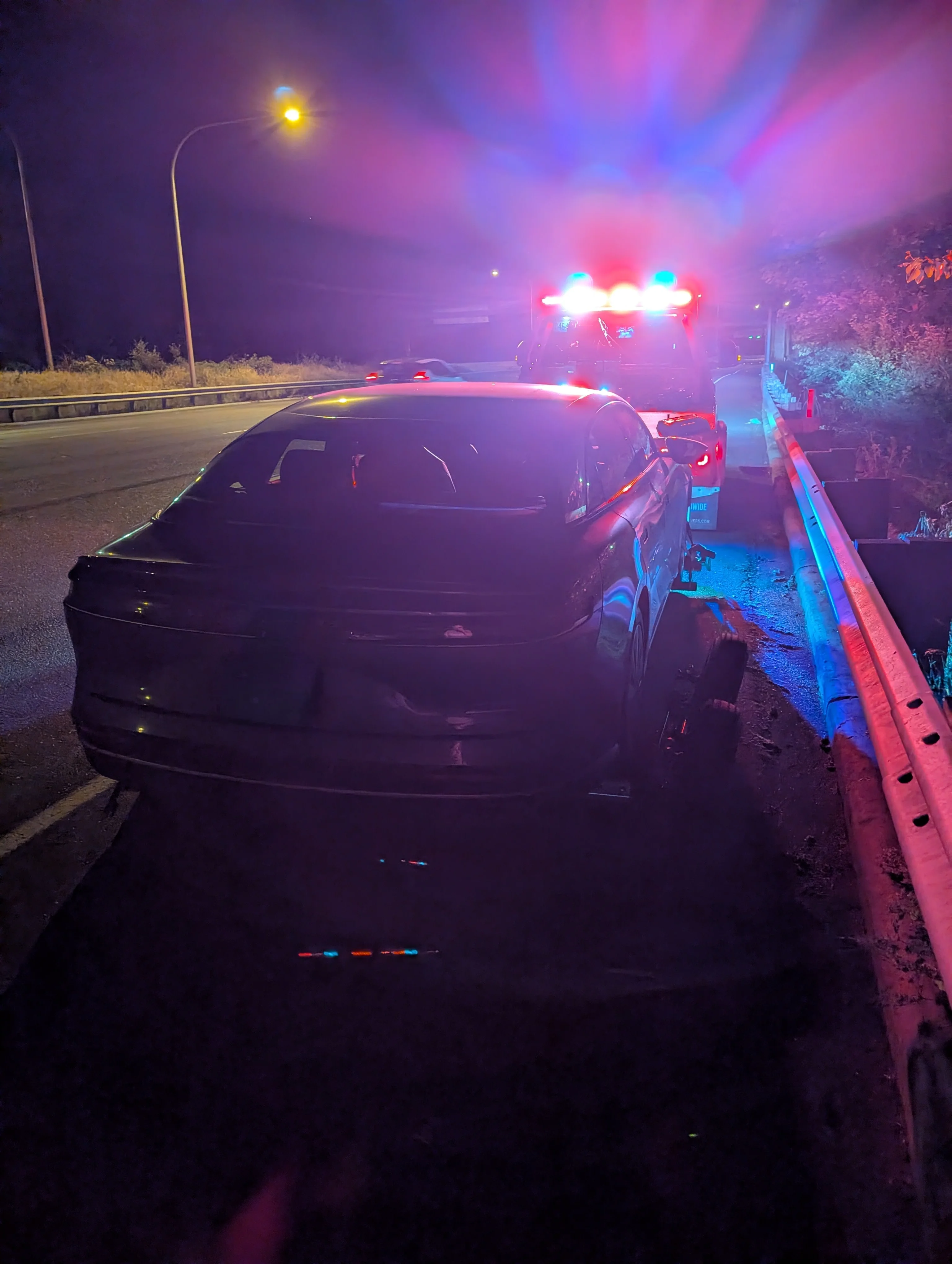

Add me to the list of those with the dreaded "drive systen fault" problem. Suddenly happened while doing 60+ on the 520 in WA state. The car was barley drivable for me to thankfully stow it on the shoulder to call for service. Sunday evening, no one to pick the phone but emergency road assistance.
2 hours of waiting later and this is the status.
