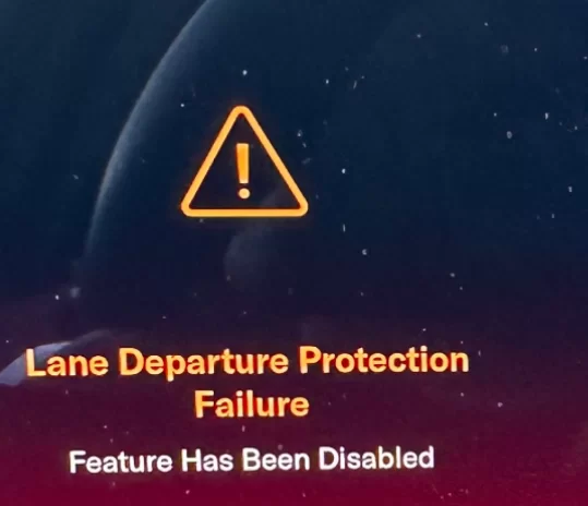

...fast forward to yesterday. Had the issue again of the right panel not showing up Again. Did a power cycle and got that lane departure error again, but needed to leave and drive to my errand, but texted customer care. finished my errand so the car had gone through another power cycle and everything was working. Meanwhile, Costa Mesa service center had left me a message. I called them back and said everything was working now. I just had called it in because they appeared to be software glitches that they really need to get fixed.
They told me that they wanted to bring my car into Costa Mesa mid-February as the remote diagnostics indicated some High voltage battery pack power surges and they may have to replace the battery pack. Do not know if all these other little issues were from that or not, but I thought I would put it out there. My car was Delivered in July 2022 and has 27k miles on it now.
It seems to me that your car has a hardware problem, not software. Hope Customer Care identifies it quickly.
Just before Christmas I had a the right screen not load while I was driving some friends to dinner. That was the first time they had been In a Lucid so it was not the best visual for them. i told them it was a software thing and after the car cycled during dinner, it would reset. Well, after dinner, we got in the car and now both the right screen and the pilot panel did not work. I did a reboot the screens came on but got the lane departure warning as noted earlier in the thread:
Needless to say, my friends were not impressed and I doubt they would ever buy a Lucid after seeing all these errors. This resolved after I had taken them home and another reboot. A week later I was driving and changed the radio station. The radio station changed, but now I had the old and new station playing at the same time.it Fixed after the reboot but came back another day. We did several reboots while on the phone with customer care. reboots caused me to even loose the ability to control the volume off the steering wheel and roller. They scheduled mobile service to come by In two weeks (mid-January). Frank rolled by. At that time, everything was working fine and no errors were showing up.
For what it’s worth, the lane departure warning comes on every single time there is a logo reset or nuke reset; it goes away after a few seconds.
