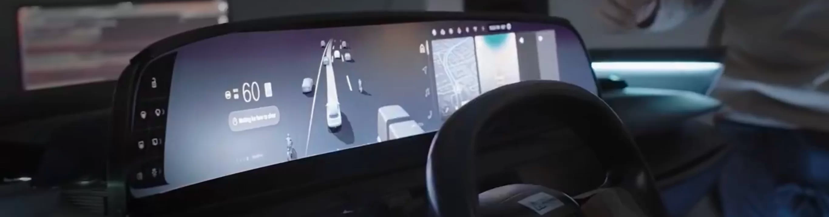

I didn't notice that Lucid was selling a "hands-free" feature until I saw it on Gravity:
I mean EOYSomething is cooking behind(4 lines), hope this gets before EOD.
