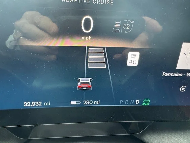

So when I press the dream drive button on the top of my screen it says adaptive cruise. Whith this image. Never see any vehicles in front or anythign like that. Just my car with the follow adjustment lines.

But as you drive, and get closer to the left or right line, do you see the car in the animation following? Or it's stuck? Also, do you hear a bong when trying to engage Highway Assist?
To be clear, I'm just curious if it has the same symptoms as mine, aka we share the same bug.
No long bong when trying to engage. The only time that happens is when I try to engage and the car is parked. It bongs and says can't do this while in park.
I see red line animations when getting close to lines aka lane keeping assistant. which is working.
So it's not the same thing :( That explains the fact that it doesn't go away after sleep or reset. You might need to take it back.

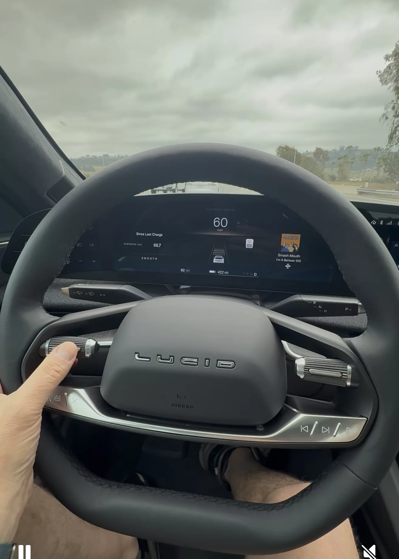

I only tried DD once before but remembered the car being centered in the lane. I had issues with mobile key and service replaced some antennas. Now the car is not centered. Could that be why I cannot get DD to work?
