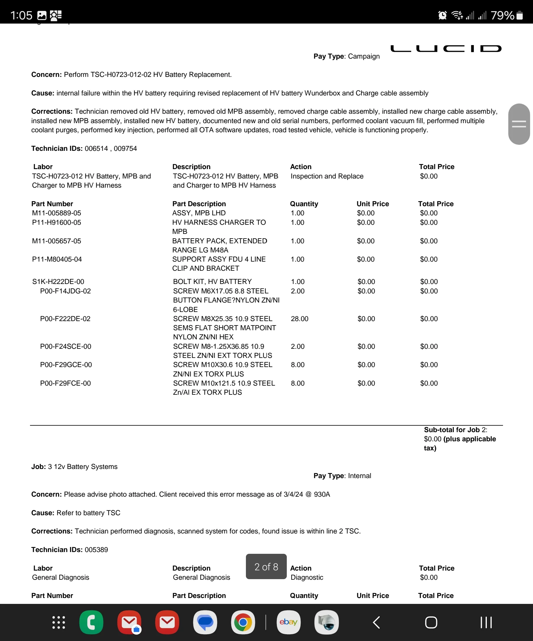

Based on the cause description, I guess they did. Parts didn't state it, but maybe came with a certain assembly.Did they need to replace your Wunderbox?
This is not a Wunderbox replacementBa
Based on the cause description, I guess they did. Parts didn't state it, but maybe came with a certain assembly. View attachment 19551
According to this post it is:This is not a Wunderbox replacement
Thanks for clarifying it! Made me confused in the "cause" section that they required replacement of it and then told it wasn't.According to this post it is:
