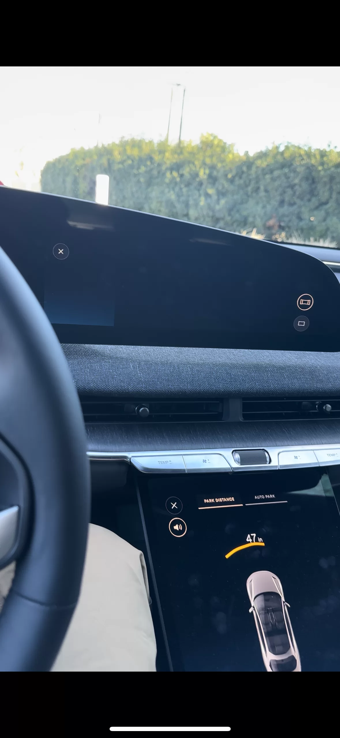

Z zhanovich New Member Verified Owner Joined Jan 26, 2024 Messages 3 Cars Air Pure Jan 30, 2024 #1 Has anyone faced an issue where back up camera is just black, it still shows distance and distance line, but no picture? Attachments IMG_8872.png 7.4 MB · Views: 33

hydbob Referral Code - R0YBCKIJ Admin Verified Owner Supporting Member Joined Nov 14, 2021 Messages 10,408 Location Los Angeles, CA, USA, Earth, Milky Way Cars Dream P DE Number 33 Referral Code R0YBCKIJ Jan 30, 2024 #2 zhanovich said: Has anyone faced an issue where back up camera is just black, it still shows distance and distance line, but no picture? Click to expand... Try rebooting the car, settings, About, Air logo for 10 seconds. If it doesn't work, call for service appointment

Z zhanovich New Member Verified Owner Joined Jan 26, 2024 Messages 3 Cars Air Pure Jan 30, 2024 #3 Will try today, I did reboot with the blinker, it worked first time, but the next day the issue came back. Blinker reboot didn’t help. Will add update here

Z zhanovich New Member Verified Owner Joined Jan 26, 2024 Messages 3 Cars Air Pure Jan 30, 2024 #4 That reboot helped, thank you for the info! What’s the difference between blinker reboot and air logo reboot?

Bobby Referral code: 82LNN7ZP Moderator Verified Owner Supporting Member Joined Apr 11, 2022 Messages 4,780 Location San Diego Cars AGT, I Pace, DB9 Referral Code 82LNN7ZP Jan 30, 2024 #5 Take a look at the FAQ section of www.lucidupdates.com, where all of the various resets are explained.
