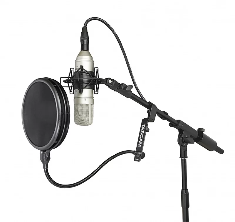

I moved it underneath, deep inside the rear "well" area and covered it with the accordion door and after a slight adjust once or twice, it was perfect. The bass reflections are partially absorbed by the carpeting, removing the hot-punch-clip-effect in the same way a microphone has a "pop filter" to eliminate "p" and "b" breath-sounds that burst and clip the microphone membrane:
A lot of singers do not start words with "b" or "p" because in live settings it's not common to use the filter in a concert. The Lucid's rear carpet (and my added Lloyd's rear ceramic-parchment colored carpet over it) serves the purpose of the "pop" filter in a positive way I wasn't expecting.
