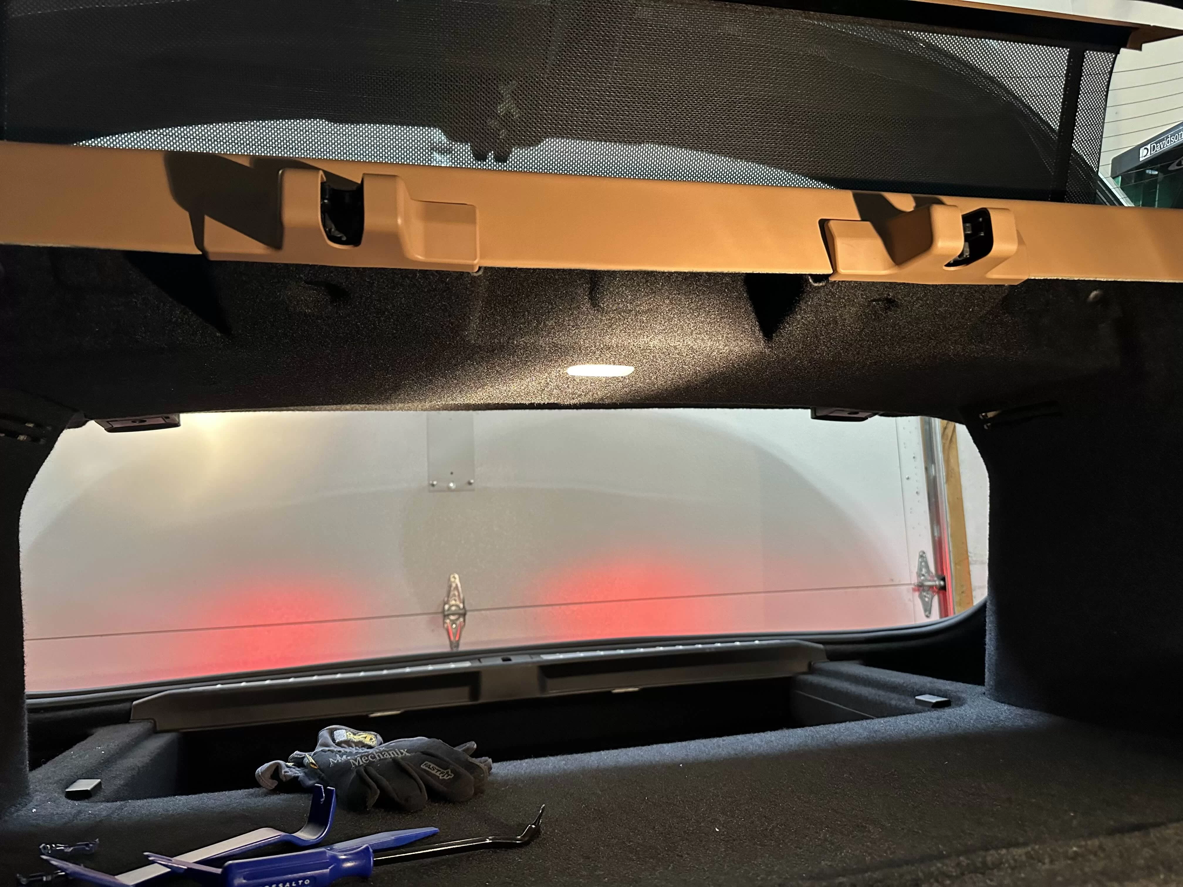

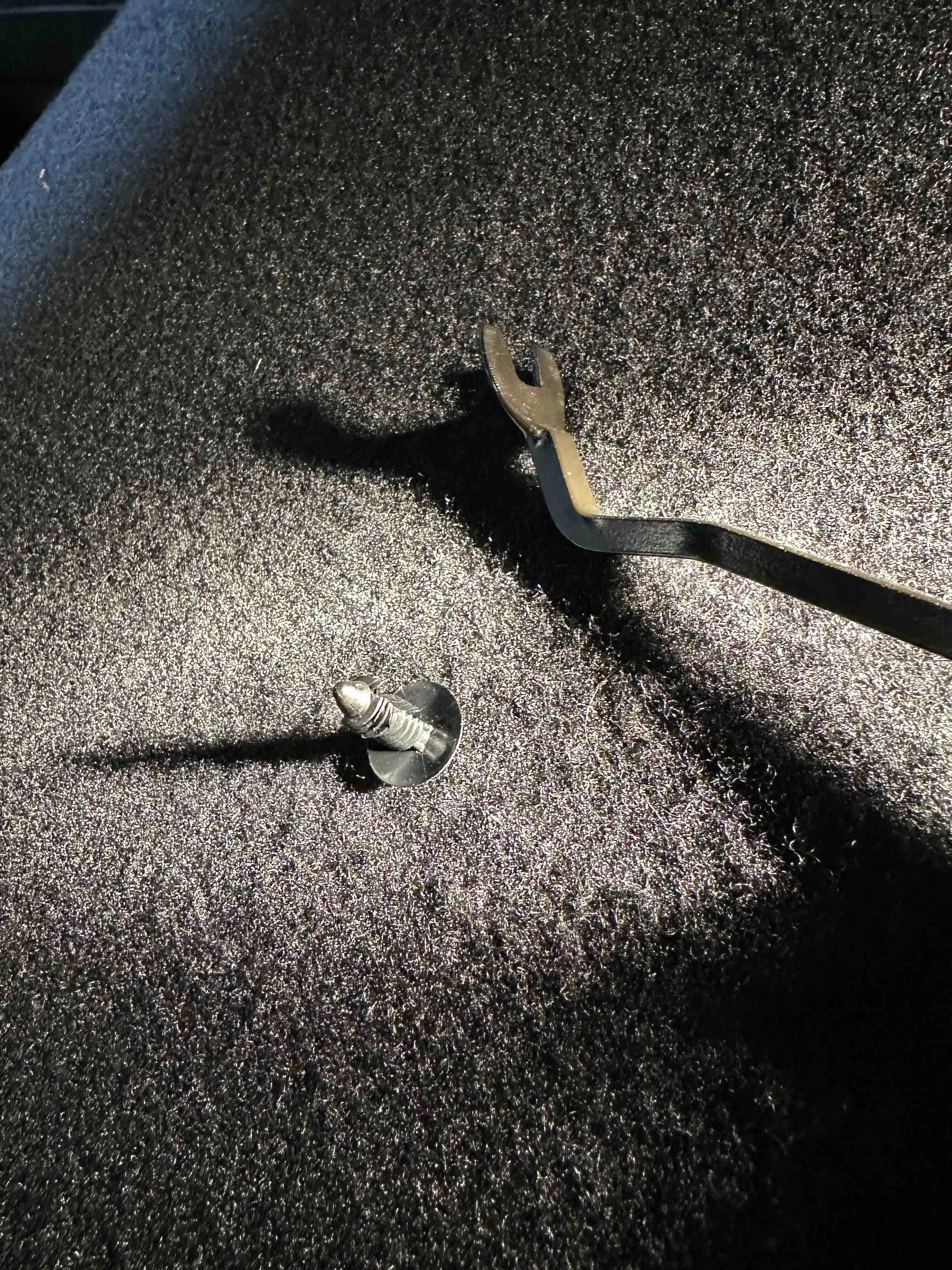

Okay! Great Success! I dropped a small Focal Bomba BP20 into my sub-trunk. I used the alligator clips, a plug in to the cigarette lighter for power, and it magical. The only thing I struggled with was removing the upholstery clips - I'm going to have to replace most of them :rolleyes:.
It's small enough that it doesn't touch the deck lid and WOW. I've got the gain cranked all the way to zero and it has fundamentally changed how much I enjoy driving my car. I'm in a lease, so even better - I don't fundamentally modify the car and can easily remove it when it is time to turn it back in. It's incredible and I love it. Thanks for the post, the instructions, and the suggestion!

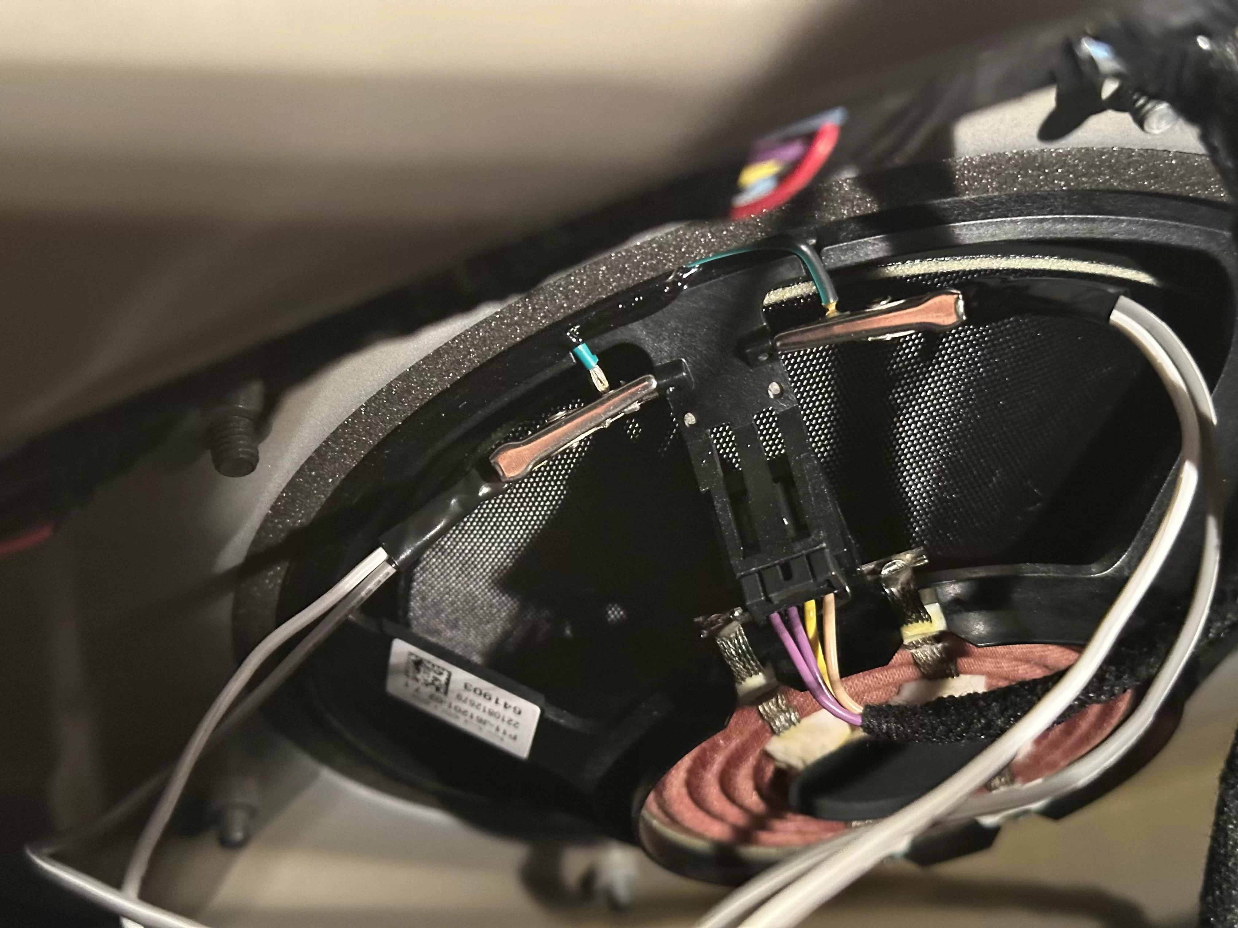

Your alligator clips tap on the high signals from the original Lucid amplifier to original subwoofer so it's H, not L input for your new subwoofer.
Low output are too weak to drive a speaker. It needs to be stepped up with preamplifier/amplifier first before it's connected to your original Lucid subwoofer.

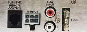

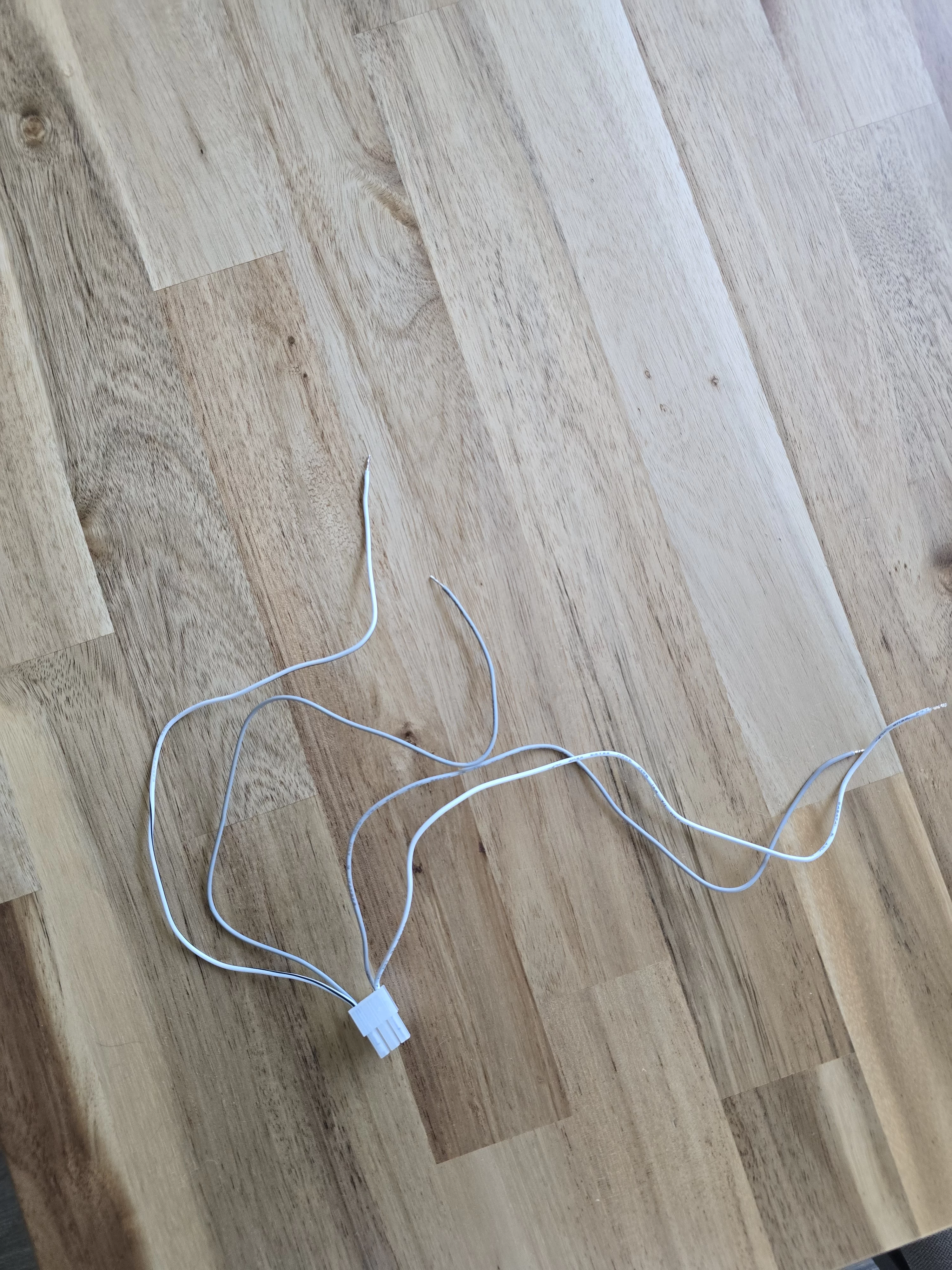

Here's a picture of the inputs. It comes with a harness, so I just wanted to know what wires to strip to connect to the Lucid speaker outputs.
That looks like a proprietary connection. What brand and model number? If you have the manual for it, it probably has the pinout. If you post a picture of that, we can probably figure it out.
Rockville RW10CA... I haven't purchased it yet, I might pull the trigger and see it's feasible to install myself, if not, will return it. It's a cheap sub to augment the sound, it's a cheap alternative to the Kicker since I don't want to spend a lot of money on this mod, just want to get a little better sound. I'll post pics when i get it.

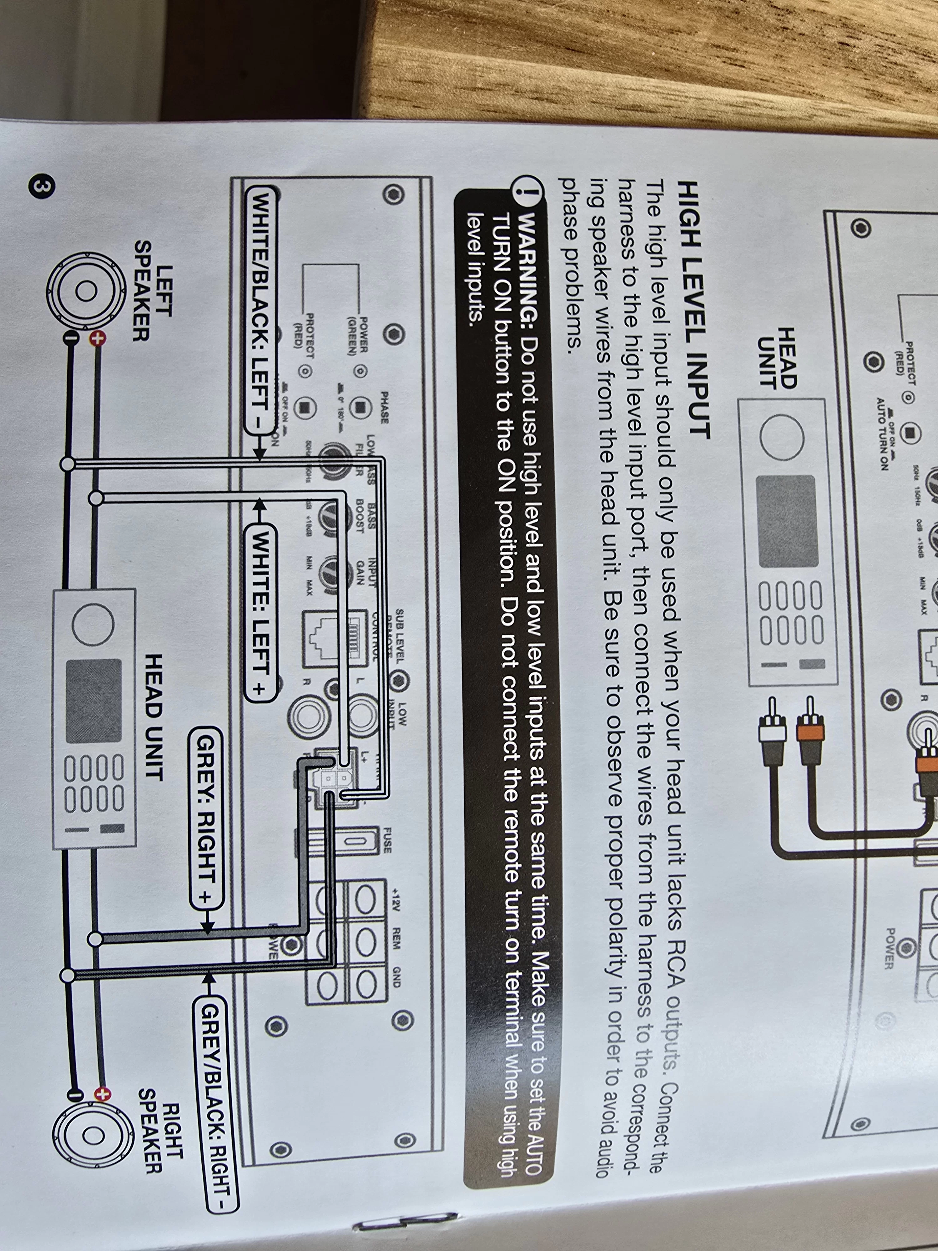

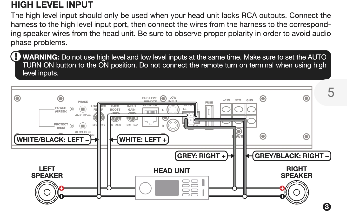

I have the amp and parts in hand now. Here's the picture of thr wire and diagram, I think it makes sense to me. But I have a question about power, it says to use 8ga wire, can I just run it without a fuse inline to the 12v aux plug?
That's fine if you like the smell of fried insulation.

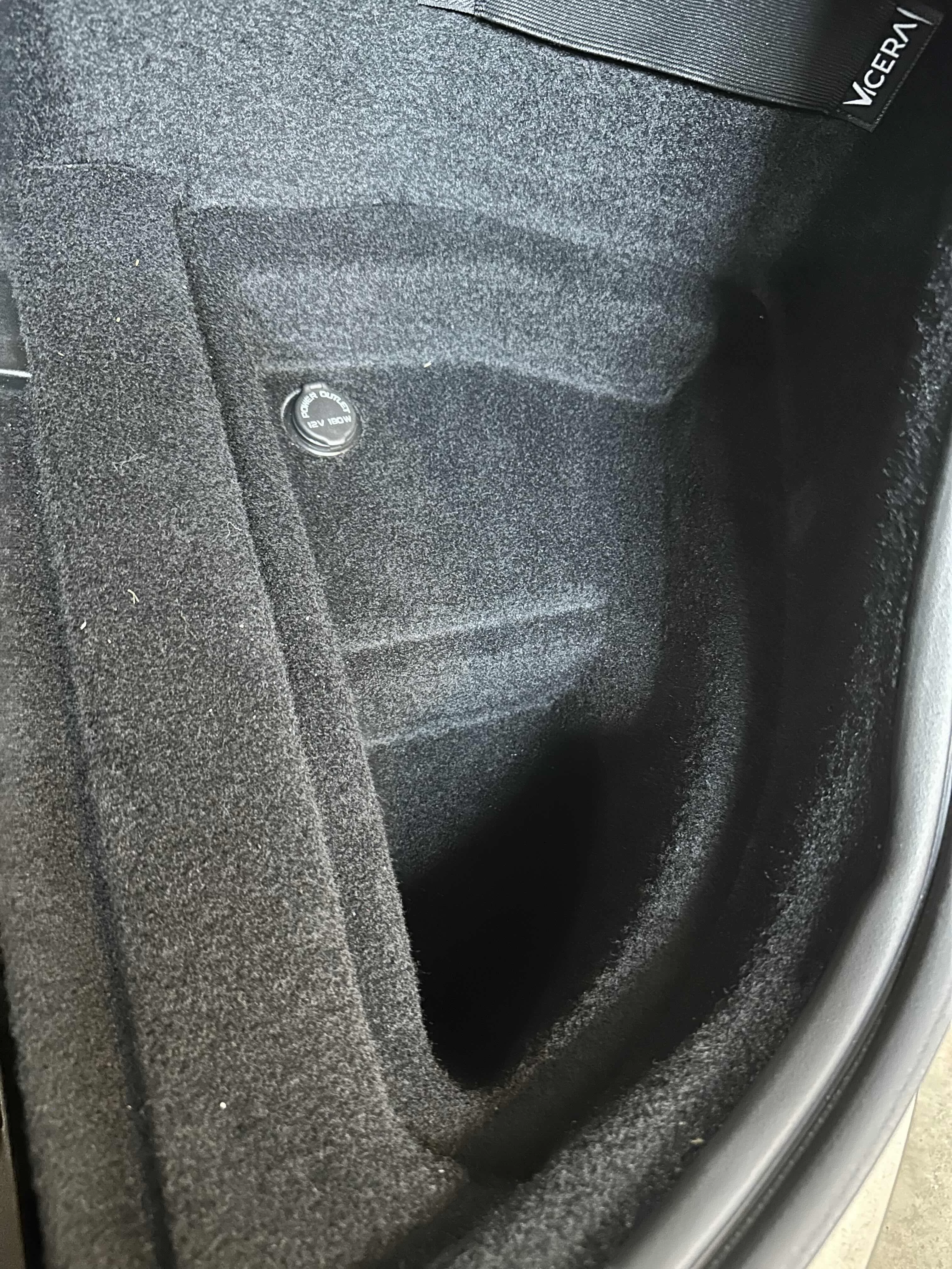

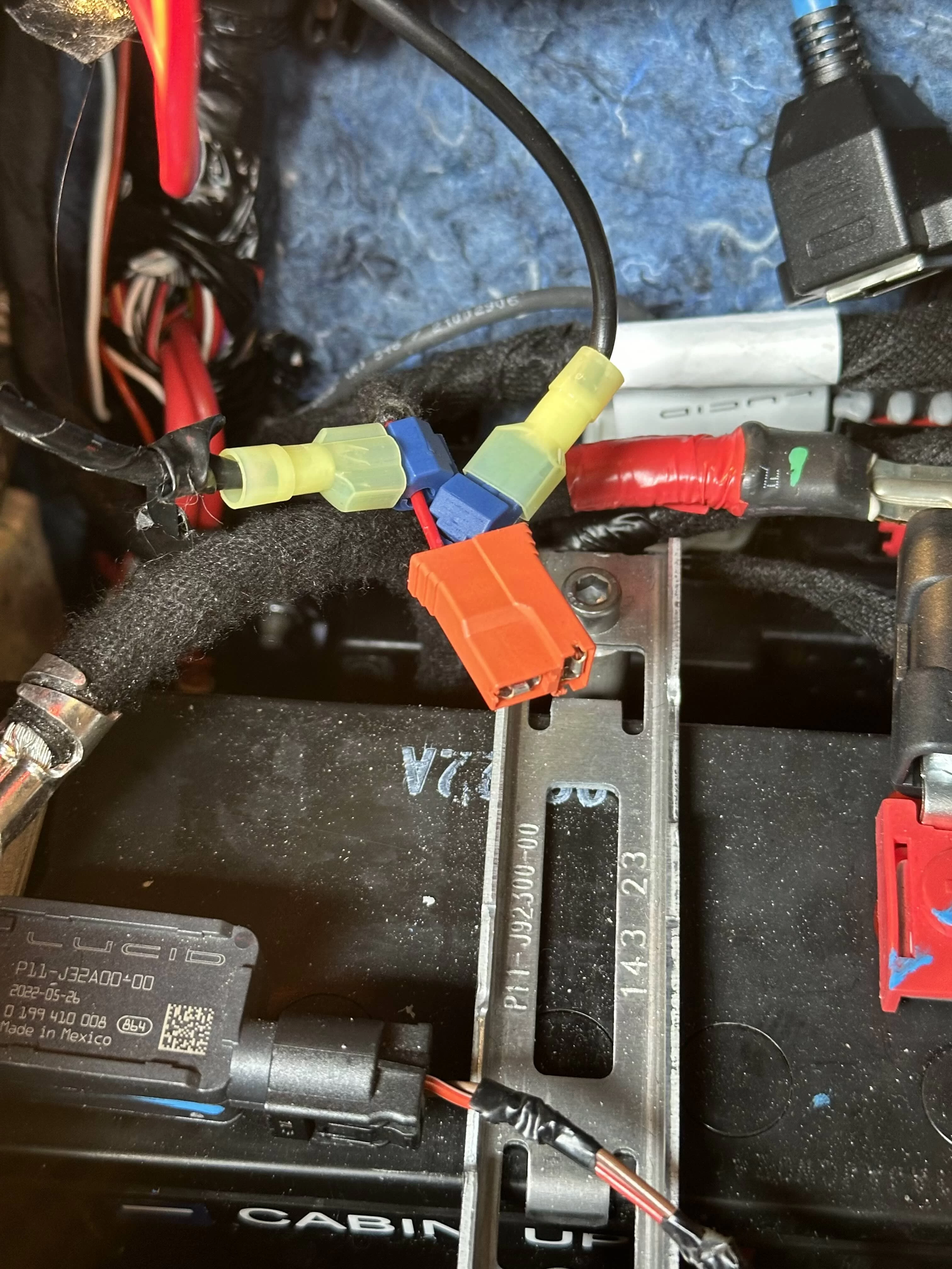

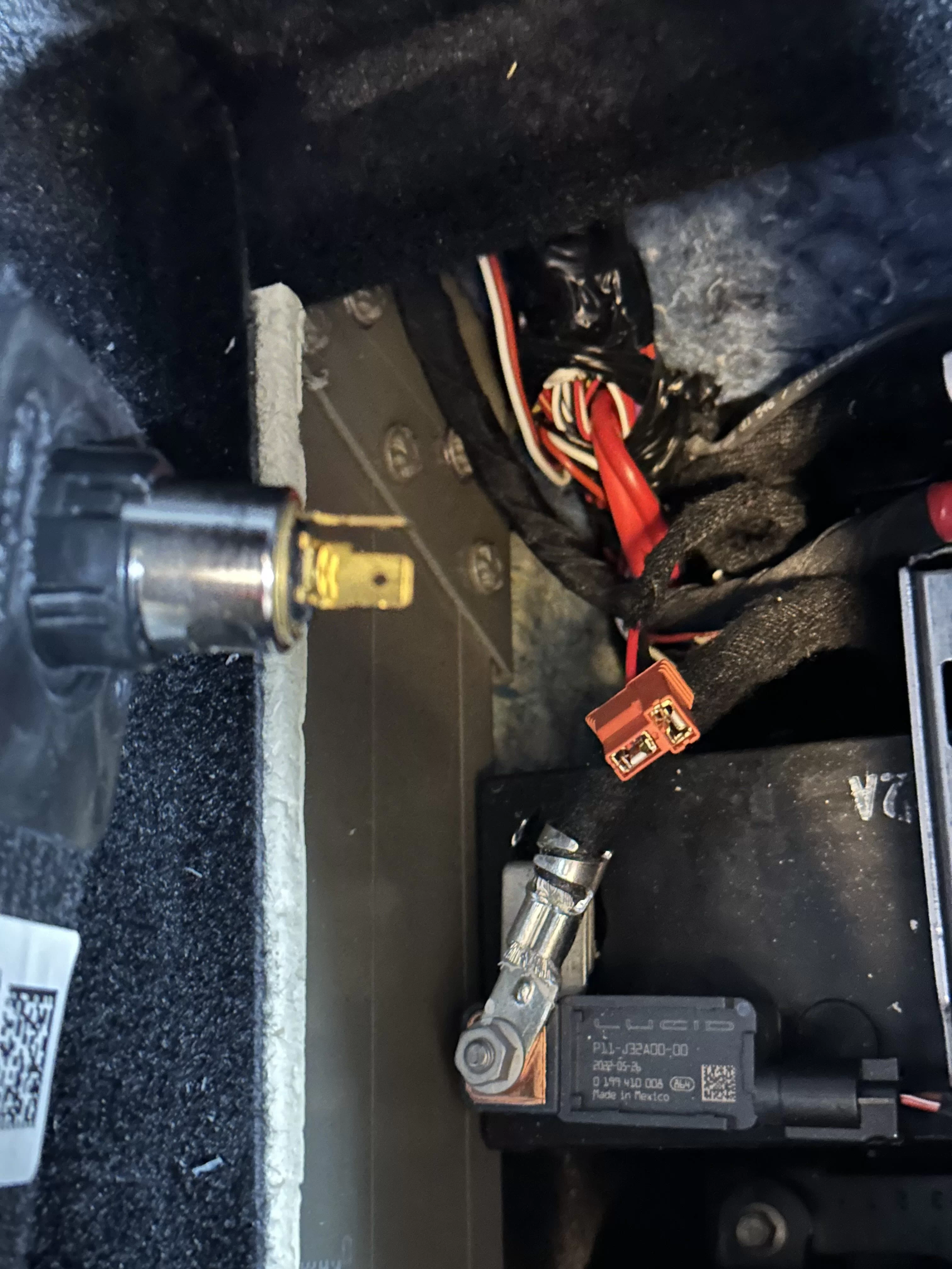

I bought the kicker 10" as the OP has, how do I tap the 12v? The adapter plugs into sub, then there are 10 wires. My assumption is the two red +/- 12v RED wires are the ones used to tap? What are those yellow/blue connectors that are tapping the 12v called and how do they connect to the 12v wires? Do they need to be stripped prior to connecting?
The alligator clamps look like the 2 "+" l/r and 2 "-" l/r get taped together with electrical tape and then connected to the existing sub with the clamps.
So if I can get clarification on the power side, maybe the rest will get sorted!

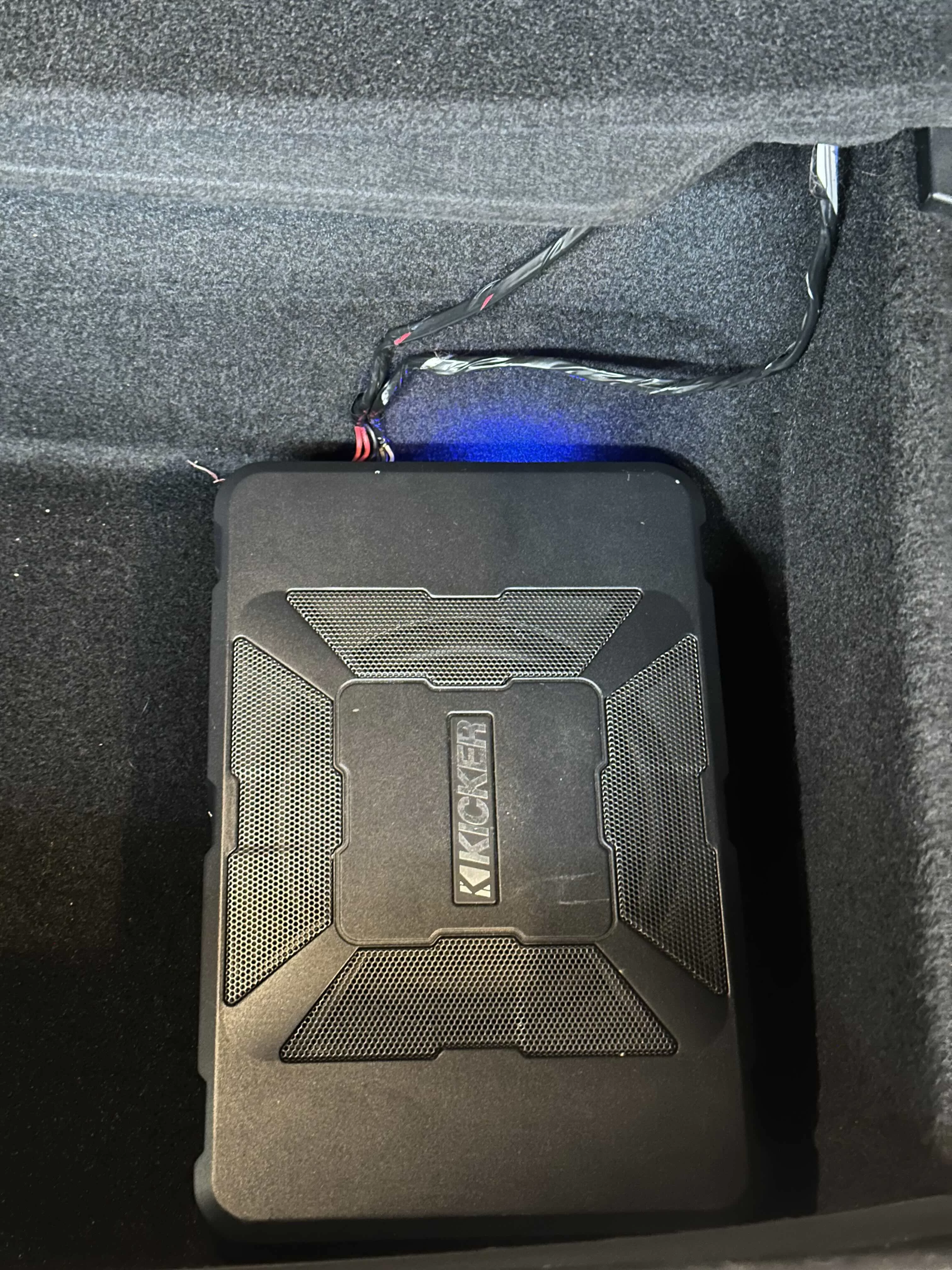

Well I just went for it.. And got it!
Not the cleanest setup by a mile, but it'll work.
